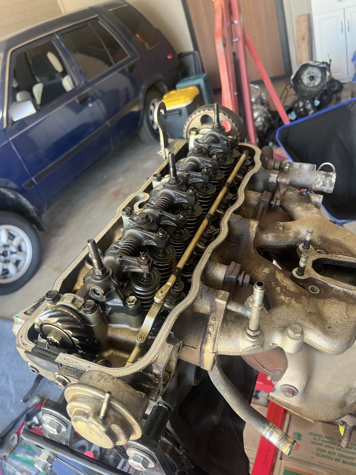

    Making some progress on the engine tear down and inspection. Valve train is looking pretty good!

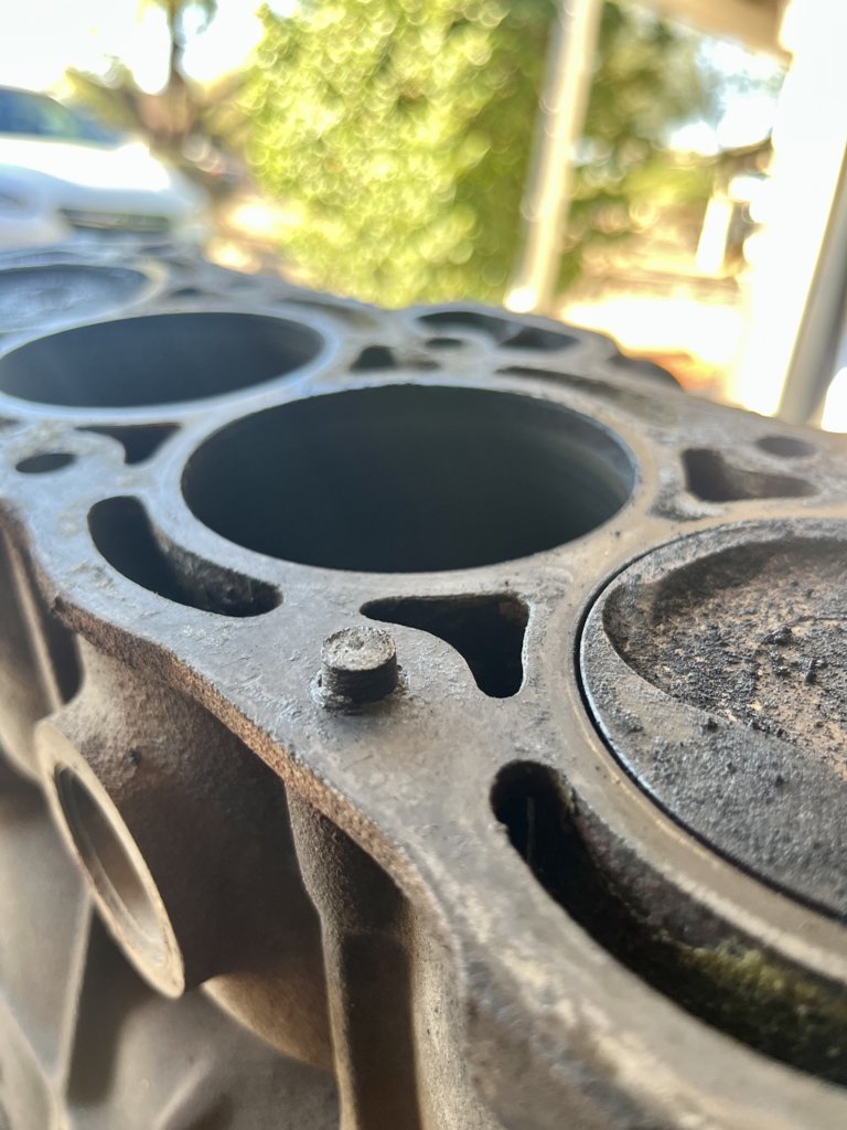

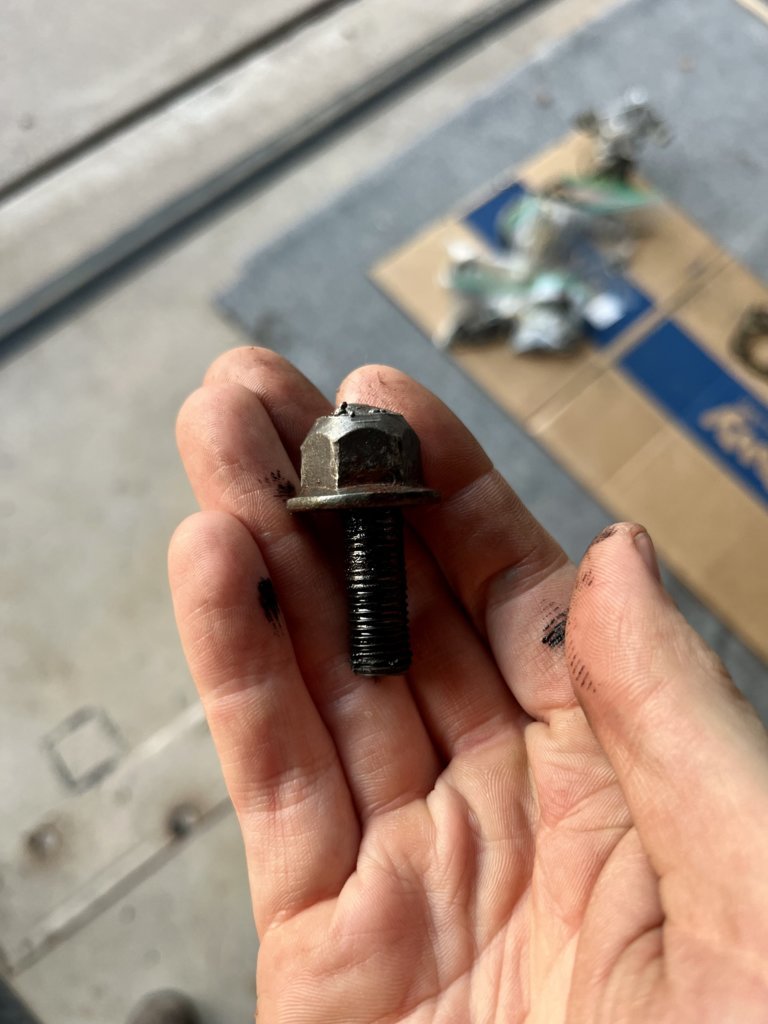

    Got the cylinder head removed! That’s where the good news stopped…

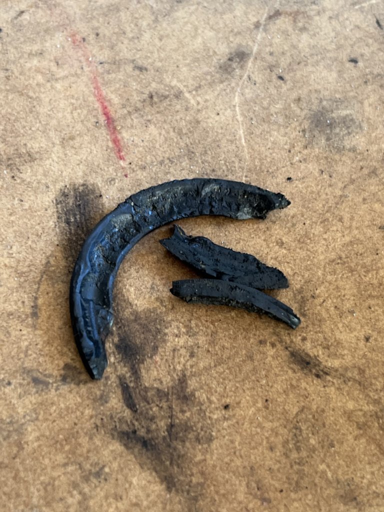

    Found this seal stuffed into a coolant passage when removing the head gasket. Not really what I wanted to see, but didn’t seem like it caused any harm. Not sure where it came from yet.

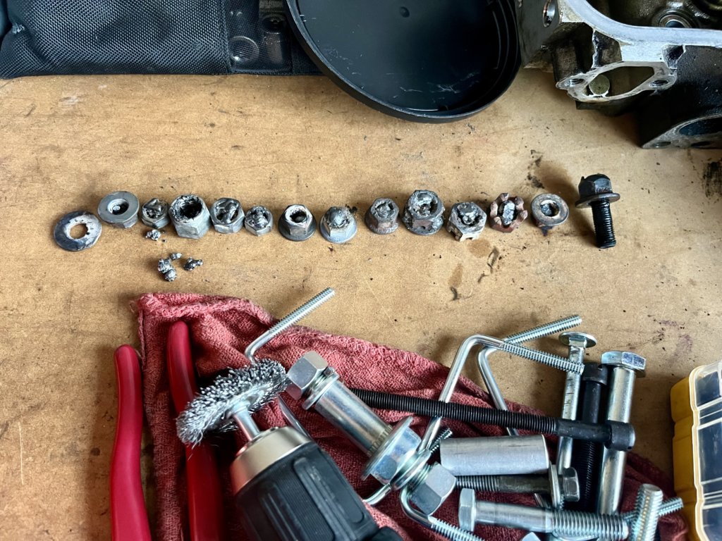

    Had a cylinder head bolt snap while removing the cyl head. Fun in store for sure getting this removed.

    13 tries later….
    Got the bugger out!!

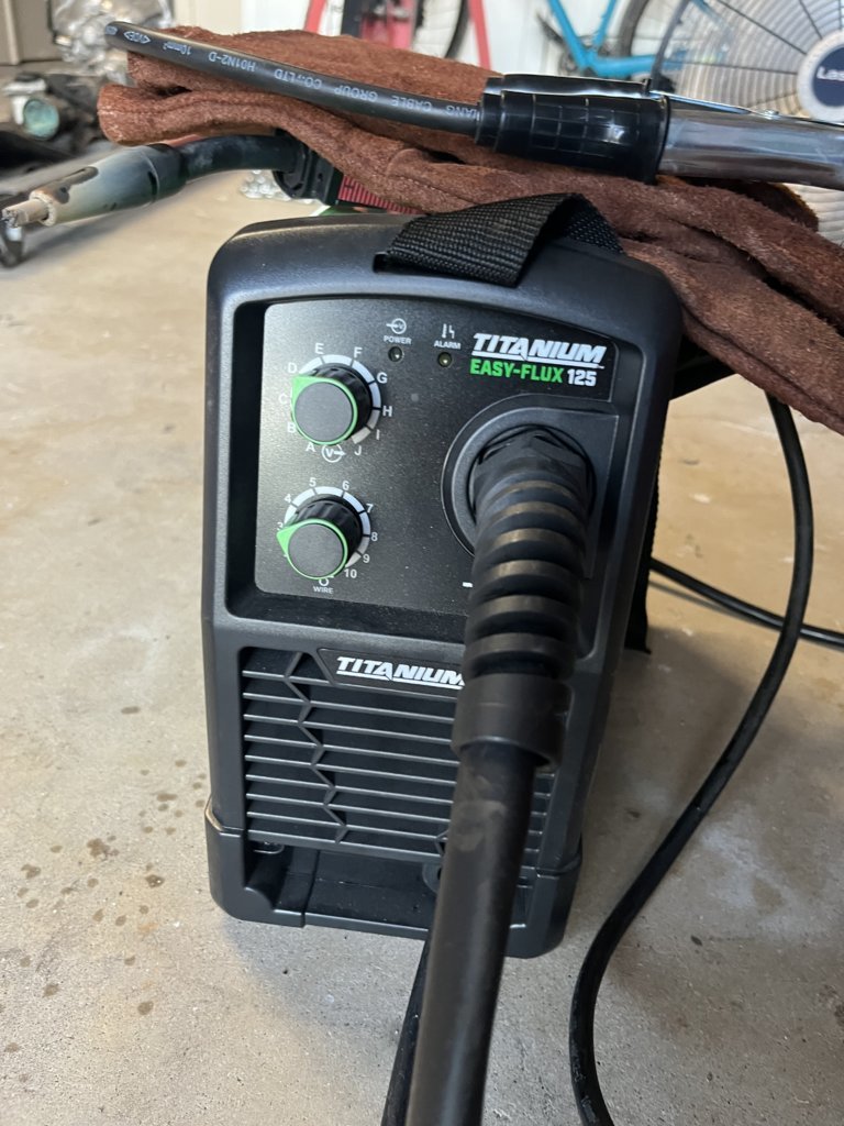

    HF flux core welder saved the day once again.
    Tsinajinii and RedWings89 like this.

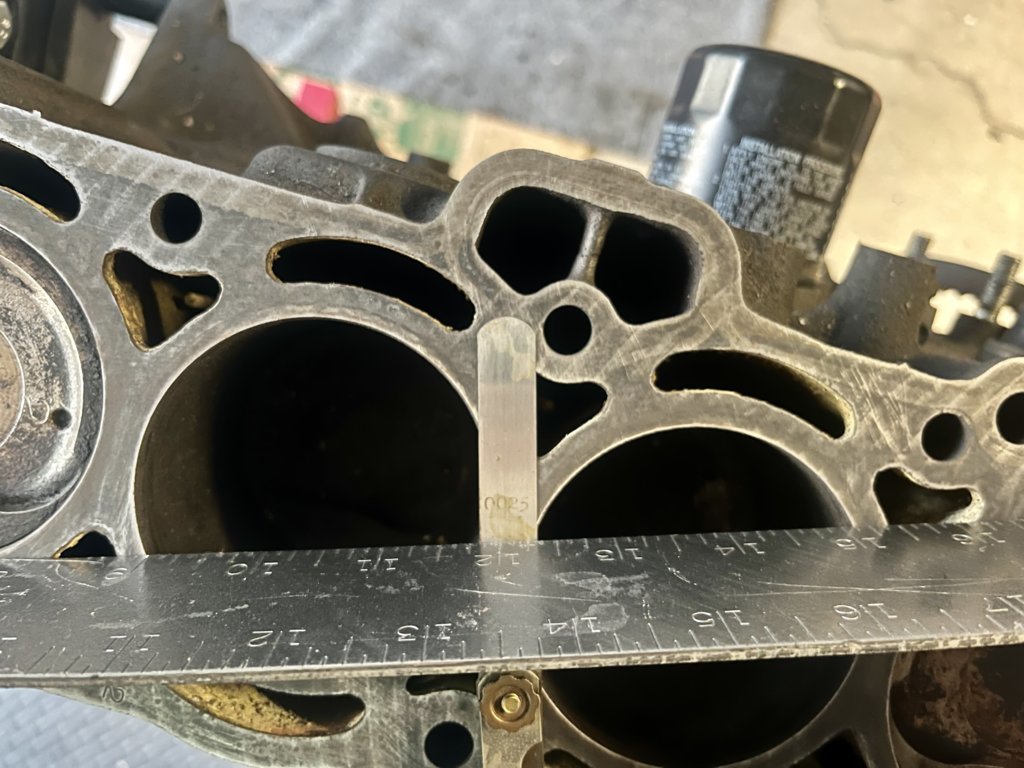

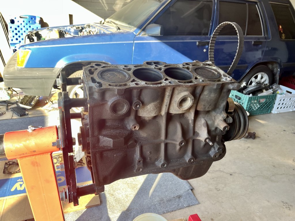

    Block was about .0005” out of spec, was able to clean it up easily with a bit more razor blade and some 320 grit sandpaper.
    Block mounting surface is good to go now. Still have some things on the block to inspect, but the cylinders and pistons look good. Can see crosshatching in all the cylinders.
