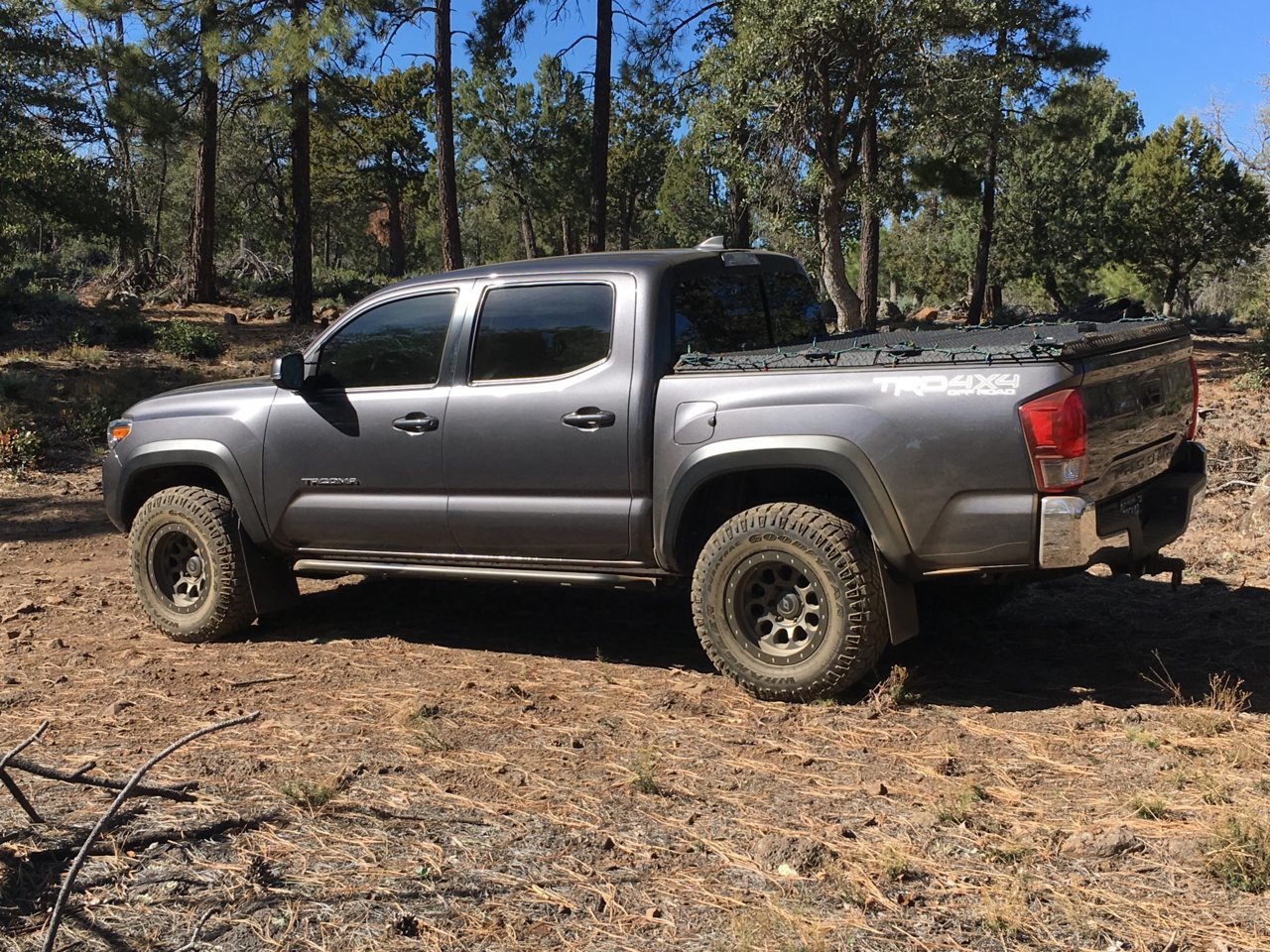

    Anyone have a diamondback bed cover? I just bought a 2018 Taco TRD OR DCSB that came with a Diamondback 270 bed cover. It leaks water into the bed when it rains. I understand a little, but it looked as though it was leaking from several places. The cover was bought new, only a few months old according to the seller. Can anyone give me some tips that have expierience with these brand covers? 2C401D74-6391-4A33-8836-899BA3127C70.jpg

    Do you have it sealed properly? My bed cover goes through car wash machines and the interior of my bed is bone dry

    I can tell just from the pic your seals are not tight enough

    I would take a 45lb weight and set on each edge while adjusting the panels. It’s a PITA but worth it.
    You shouldn’t be able to get a single finger under the bed cover when tight enough

    Just a pic to reference

    Ok, after adding weight, tighten the clamps on the interior, or adjust the rods that lock it down?

    Dude. Also call diamondback. Tell them you bought a truck with the cover and they will probably walk you through tightening the cover down. These guys are rock solid with their customer service

    You’ll see two brackets under the cover held by 2 bolts. Those need to essentially be raised to allow the rods to lock down tighter. Hard to explain without a visual reference

    I was in there this afternoon, just looking around. I know what you’re referencing. I’ll try giving them a call. Thanks for the info!

    The seals will break down over time and eventually need to be replaced. I ran their HD cover on an F-150 for 6 years and had I not sold it with the truck I would have been due for a new seal. As stated, Call DB, their customer service is on point.

    Your Cab side cover doesn't look like it was weighed down enough during installation. Got your old tires kicking around? Throw them on the top of the cover and get yourself under the cover and readjust the tension/positions. I was solo when I installed mine a month or so ago threw tires on top and tightened everything, no leaks at all and I've directly pressure washed it as a test.
