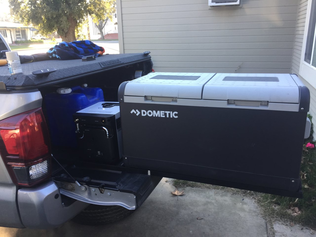

    Yeah it’s a Dometic DZ75 which is the same height as a 50. So I went a little larger. EAA43BC9-7C5A-46C0-81F9-9AAEFB3FA315.jpg73E1C8C5-8720-4817-81F3-DDBAB40B8A2C.jpg47E040DF-AF72-406E-B3E8-81640F1ECB51.jpg

    What is the overall height of that Dometic setup?

    Hmmm don’t know at the moment, my truck is unloaded. The slide adds about 3/8” to the height of my Dometic DZ75 which you can look up. It fits under the cover. I did bend the locking arm to make a tad bit more room

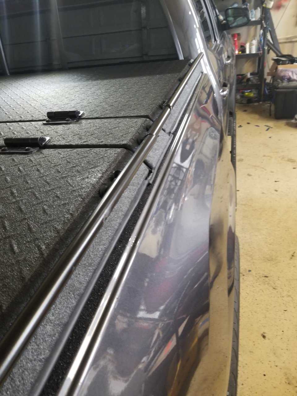

    A few have asked for another pic or two of the tie down rails I installed on my cover. Finally back from powdercoat and reinstalled. As i have a need to carry boxes and similar cargo , I wanted more flexibility in securing items and also wanted the rods to function as a stop on each side for boxes. Working out well for me.
    The hardware is mostly quarrter inch bolts except used 5/16 for the single center post on each side. Only did these on front panel as anything heavy needing firmer strapping goes up front.
    The aluminum rod is 3/4 and has no flex up front and just a slight deflection on rear if over tightened.
    ** NO water leaks, 1/8 thick rubber washers along with waterproof silicone around bolts once pushed threw from inside. Also used 1/8 backing plate behind each set of holes for additional strength to avoid any indentation or bending of the cover when securing cargo.
