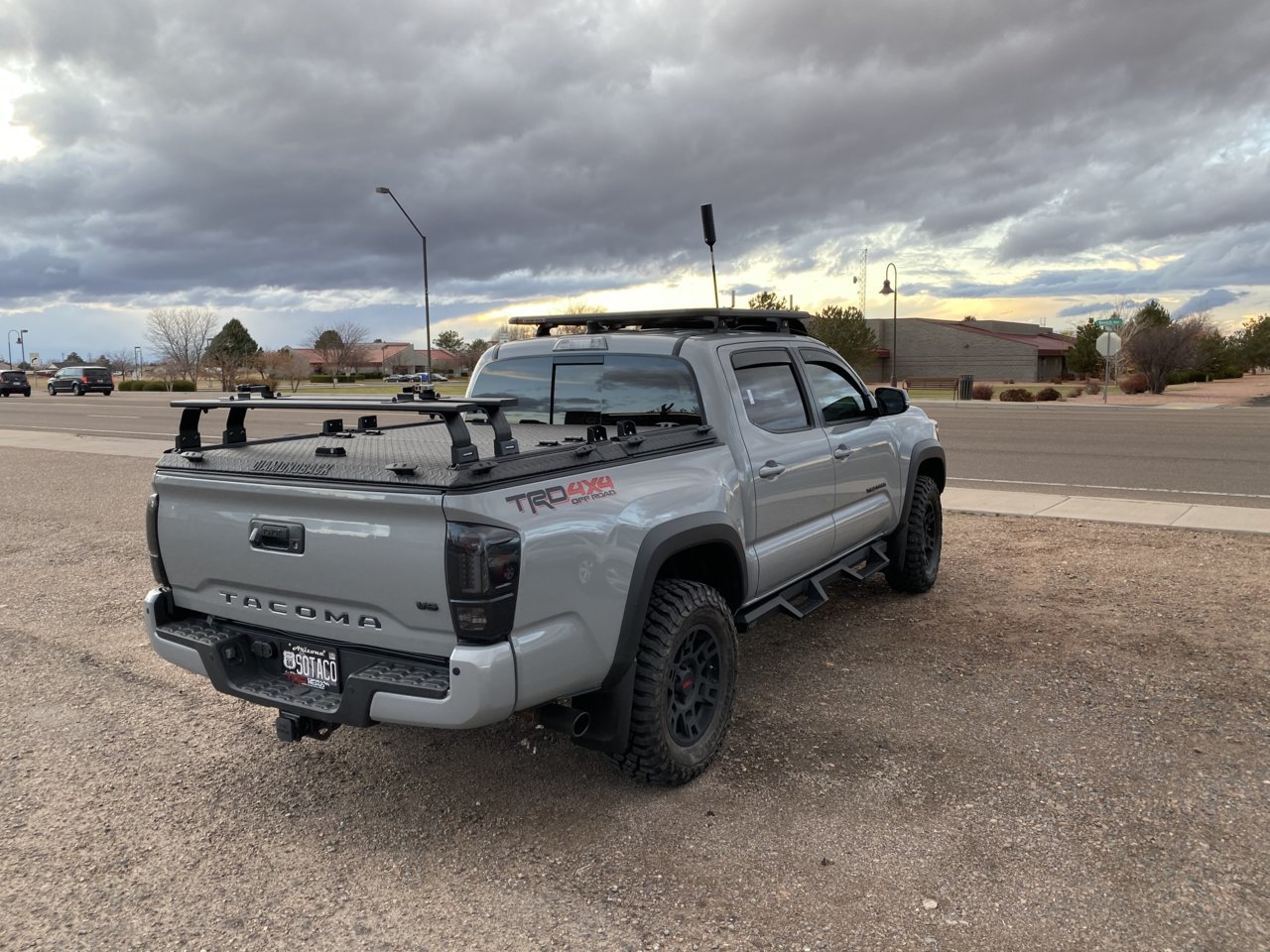

    I think mine looks nice, plus the security .

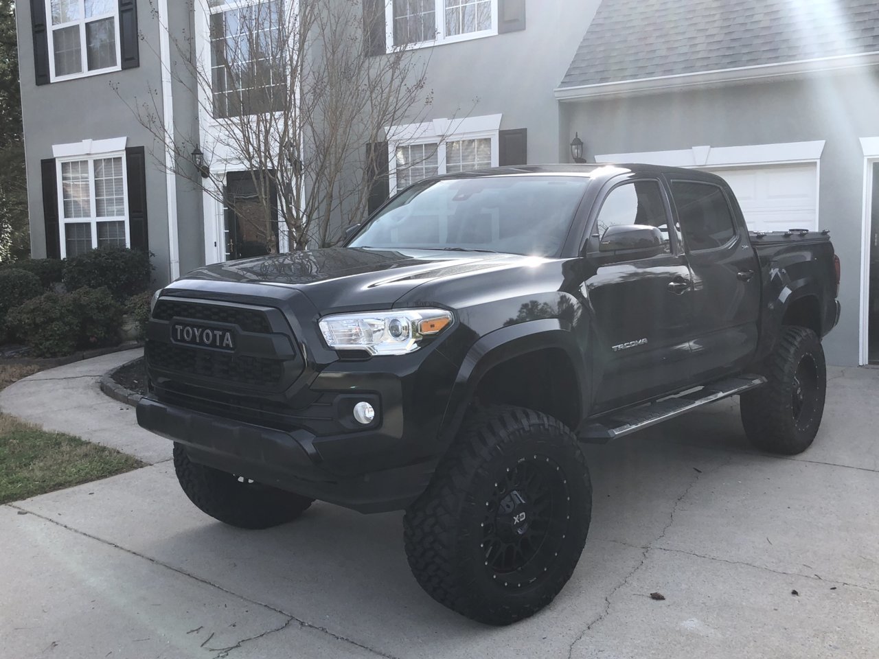

    Just put an SE on my SR, really happy with the cover!

    Do you mind sharing your rack setup?

    I pretty much followed this thread and requested items suggested.

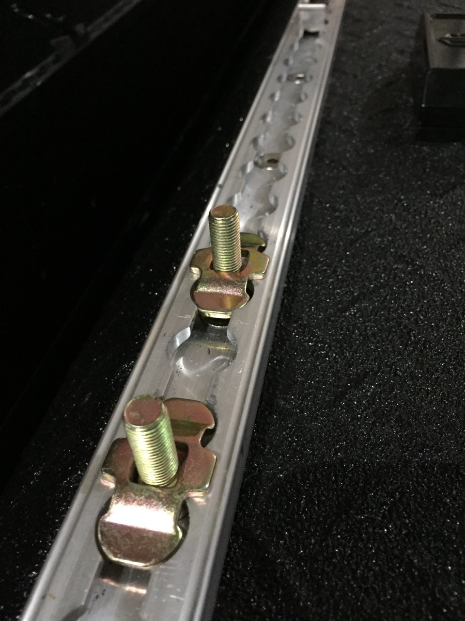

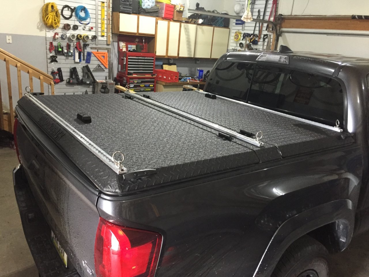

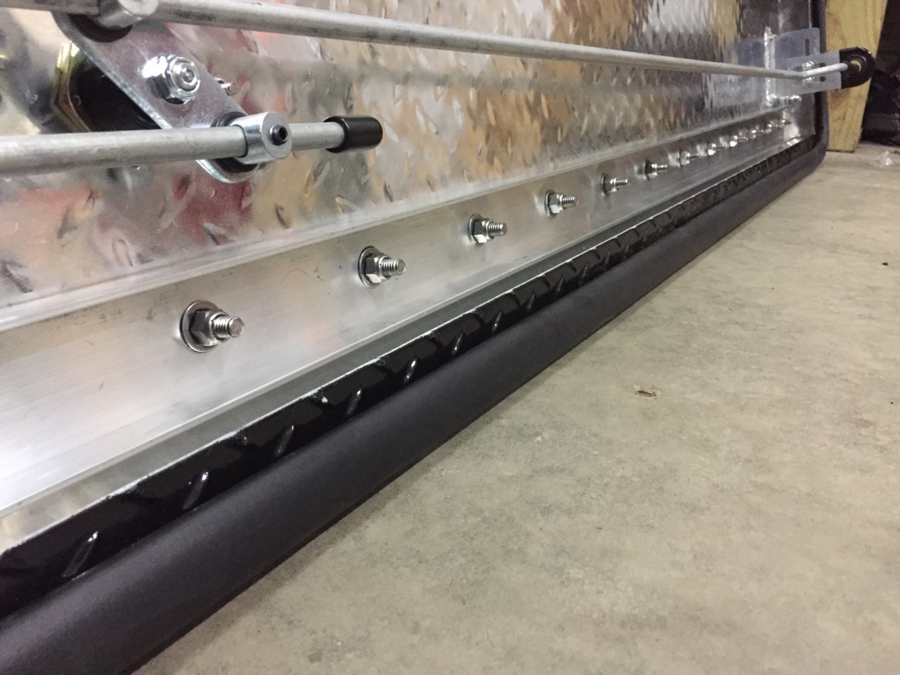

    I added three sections of L-track to add more options for tie down points. Aluminum c-channel was added to the underside to reinforce the panels where the tracks are mounted. The threaded stud fittings work great to temporarily mount things like my bike fork mounts.
