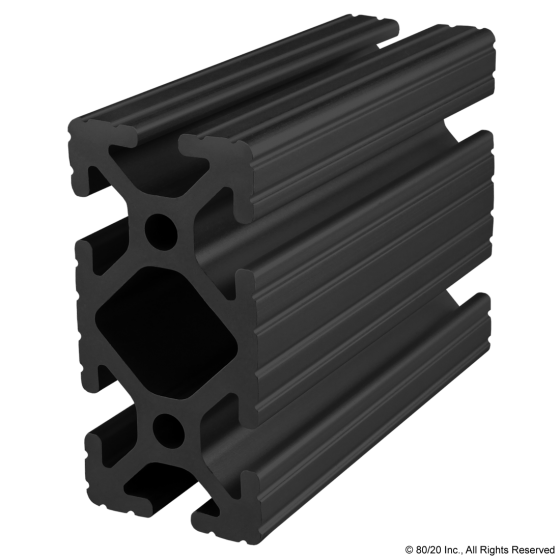

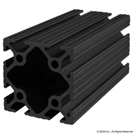

    Looking for thoughts/opinions from those that have modified your DB covers. Mine is plain from the factory (HD model). Thinking about running 1 of 2 setups for securing gear above the cover.
    Option 1:
    • Extruded Aluminum going around the outside edge, center fixed panel edge and near the cab on the front panel to create a square shape. And the mirror image on the rear panel. Possibly could do just a "U" shape with the extruded aluminum on the outside edges and near the cab. Again, mirroring it on the back (tailgate) panel.
      • Can go with 1.5"W x 1.5"T, 1.5"W x 3" T, or 2"T x 2"W (haven't decided) - Pics below are in order 1.5x1.5, 1.5x3, 2x2
    Option 2:
    • LLOD tracks and bars from frontrunner
    • Victory universal 42"x42" basket (see pic below)
    Option 1 allows you to run it all the time and still access the front of the bed by lifting up the panel (once gear above is removed) and the rear panel will lift (again, without gear on top). The 1.5", 3" or 2" lip will provide something sturdy to rest your gear against and the T slots will allow you to add some tie down points for a net or straps.
    Option 2 will not allow you to access the front panel or rear panel when the basket and rails are on, but you can throw stuff into the basket (cooler, fishing poles, camp chairs, tent (non RTT), grill, etc) and it be fairly secure, even more secure with a net. Would also allow for storage between the basket and the DB cover. And of course storage under the cover. Everything below the basket, including under the DB cover would have to be slid in/out.
    Been running the pros and cons of both ways in my head for awhile now, but haven't decided on which way to go.
