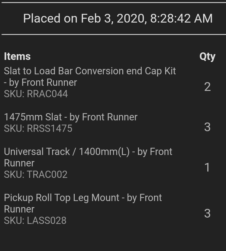

    what is the cost, if you don’t mind me asking, for the front runner setup? I would most likely go with just 2 rails and I know y’all did 3, if you have a price breakdown on the individual pieces (cross bars, tracks and bar feet).
    trying to get a total of this setup with a basket on top, versus Fabricating one like YSL.

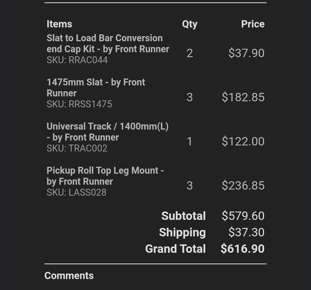

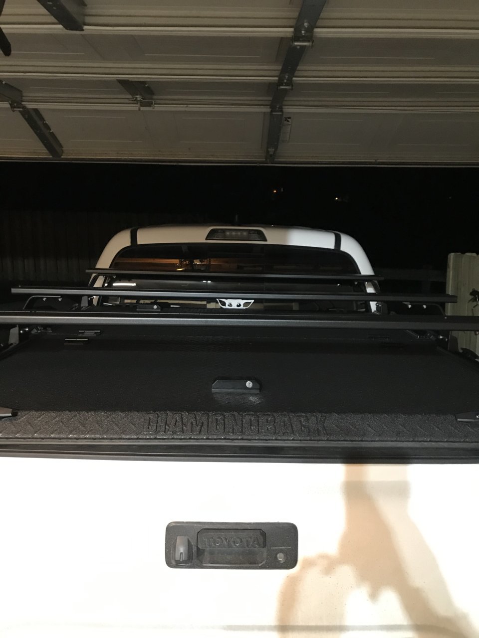

    I don’t have the breakdown but I paid just north of $600 shipped for my 3 bar set-up...

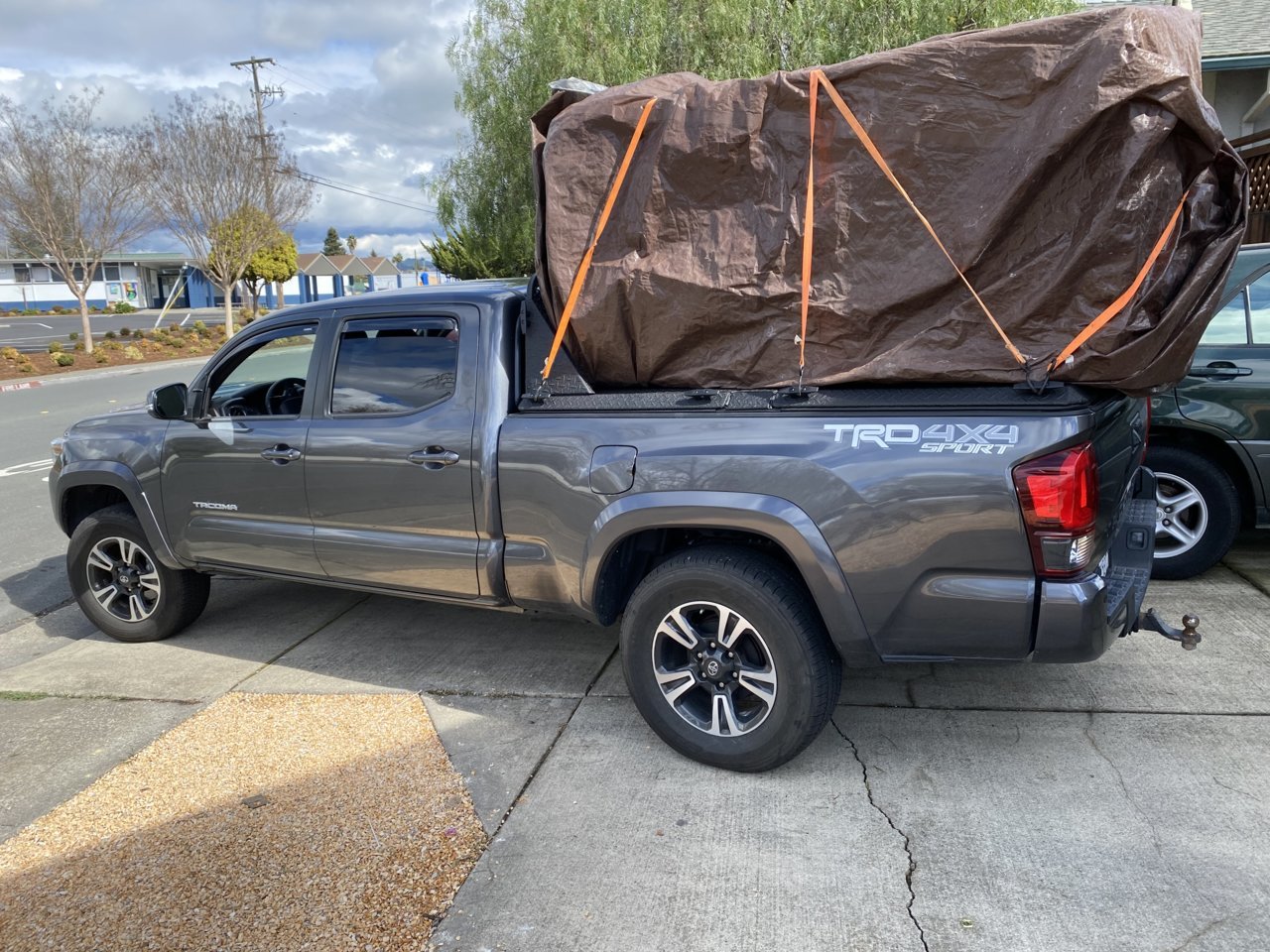

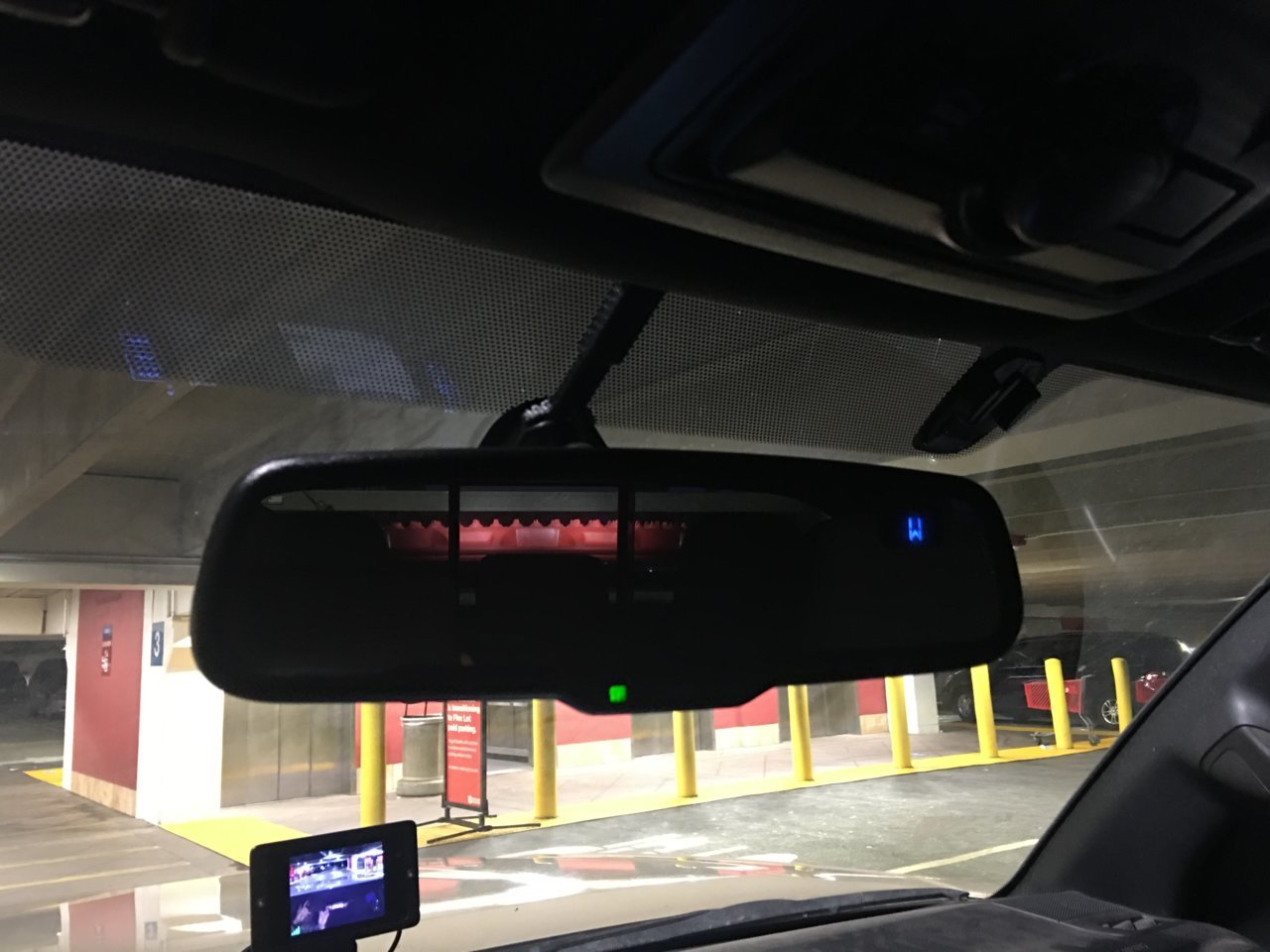

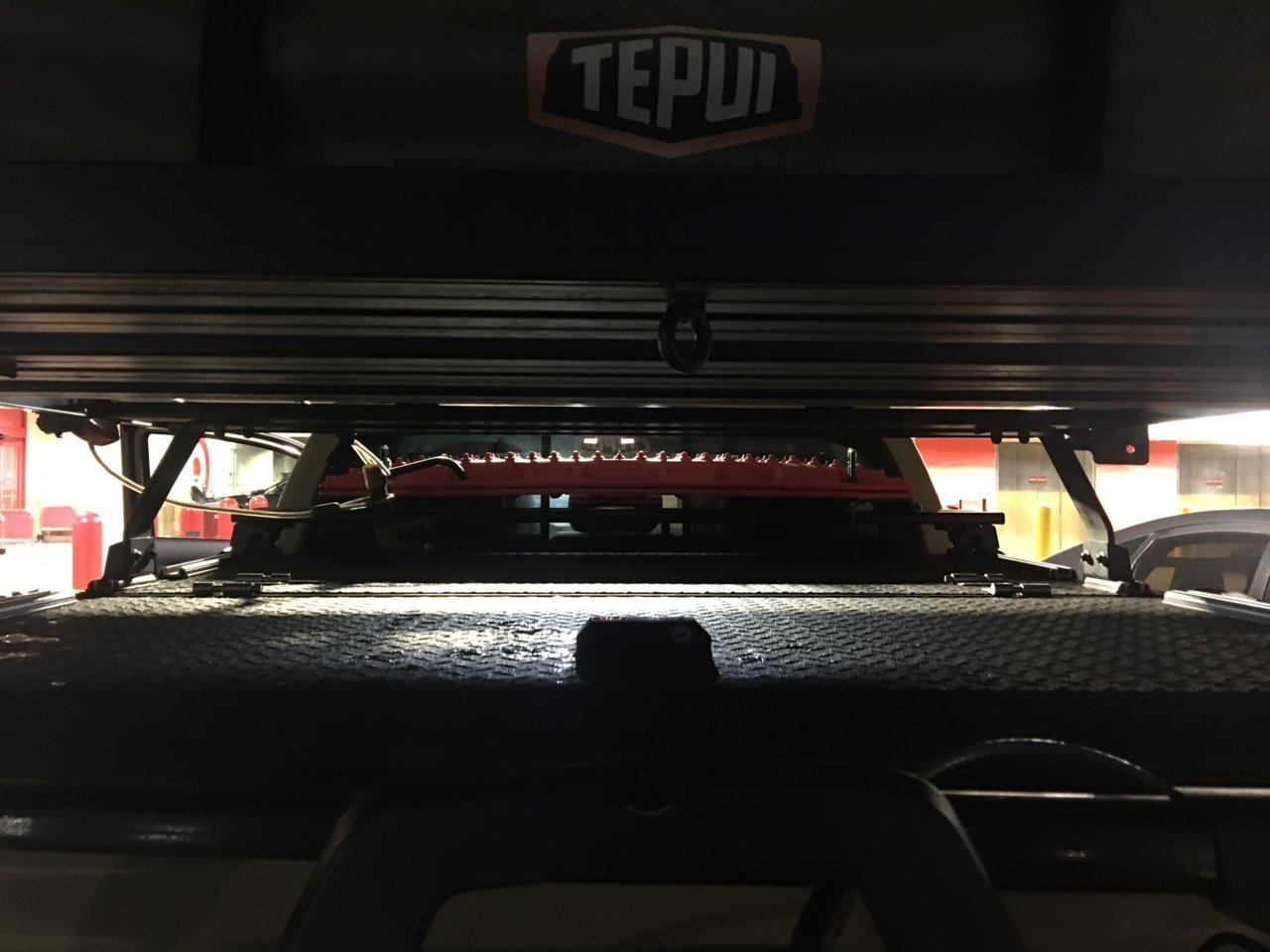

    Helped some of my family out with moving this weekend, the Diamondback performed flawlessly8E440101-491C-45CF-95FA-D51F202A6AAE.jpg 69213168-40F8-4BD4-9428-3CE2E1BDEC8A.jpg

    Thank you for the post! I was able to find all of the parts except this one:
    • pickup roll top leg mount - LASS028
    Other parts breakdown in price as follows (individually):
    • Universal Track: $122
    • 1475mm Slat: $66
    • End Cap: $19
    Do you know what the individual price on the legs were? Are the sold in pairs? Thanks!

    Always a pair. About $80 approximately per set of two.

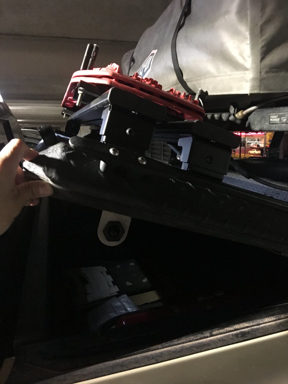

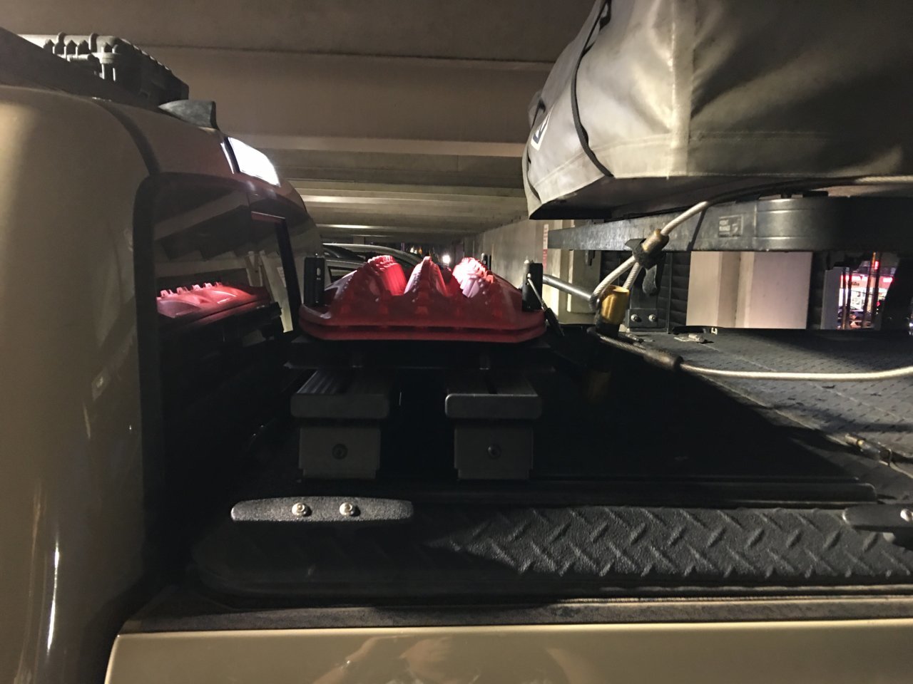

    Added some short FRO load bars on the FRO tracks on the front panel of the DB cover and relocated the Maxtrax onto them. Front panel cover still opens up, but it doesn’t stay open on its own anymore due to the added weight on top and it doesn’t open up as wide as without the load bars and Maxtrax mounted on it. Gonna need to make some kind of hood prop kickstand thingamajig or a simple bungee cord type latching system.

    You can replace the struts with stronger ones. I put mine under the rear deck in the dead space and it still works with the stock struts.

    Thanks! I’ll need to look into that more. That did cross my mind at the Target parking lot, but then I started thinking of what I could do for the time being.
    I’m guessing I added at least 30lbs onto that panel with the two load bars, recovery board mounts, hardware, pair of Maxtrax boards and the bike lock.

    The stock gas shocks are 80 lb shocks (Suspa C16-08789). See Suspa’s catalog for a list of other options. I replaced mine with longer shocks of the same opening force to make the cover open further.
    Be careful not to increase the shock force too much though. I tried 100 lb shocks but they were too strong for the small amount of weight I added to my cover. It sounds like you might be okay with the 100 lb shocks though. I wouldn’t go any higher.

    Thanks! Tacomaworld ftw! It looks like that 16-2 is the style Diamondback uses. I’ll check around for those.
