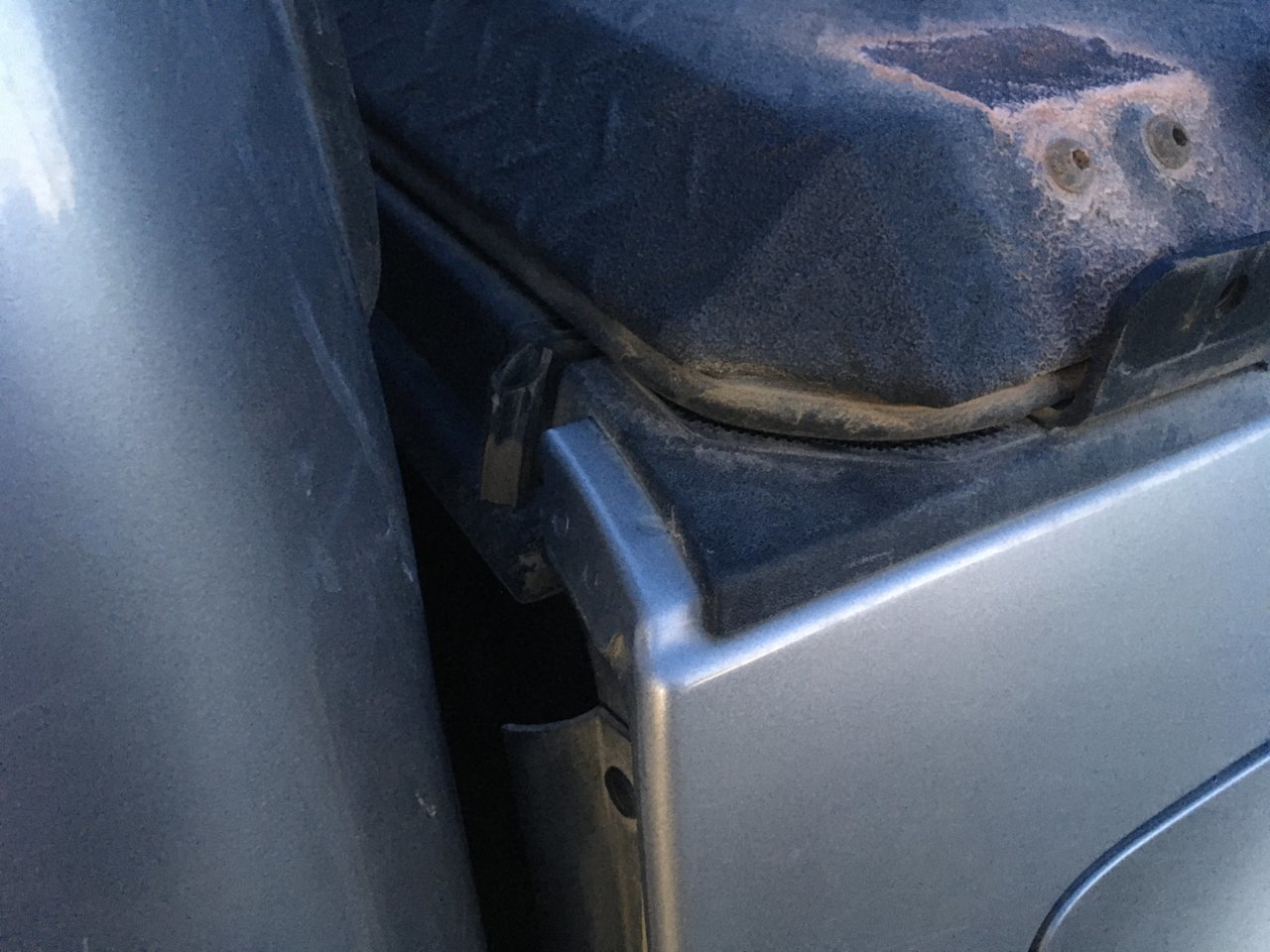

    Must be nice; I filled those gaps, put butyl caulk under the rail caps and also ran a foam seal along the top of the bed rails just inside of where the DB seals meet it and I still get plenty of water in my bed. Have yet to crawl inside and take a hose to it to see where it's getting in.

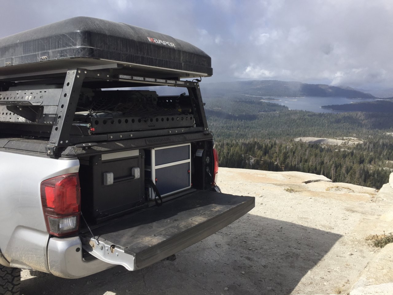

    My @KB Voodoo rack goes on and off when I’m not off roading. 4 bolts and I leave the tonneau brackets on all the time and the gasket seals around them just find. In a heavy rain on the highway I might get a little bit in under the cover up front, but with a bed mat it all goes under and drains out. I used the included weatherstrip to help block the grooves on the top of our bed rails, those things like to channel water around. I love my rack for the modularity and you can just see the rear wheel tray for my bike rack.952C96E5-2C9D-4A13-BA8E-B67043225E33.jpg

    I can see why your having trouble, there are some pretty massive gaps. Plus the front is higher than the bed sides. It’s gonna take a lot of silicon to fill. Anyone have any pictures Of how they go it sealed?

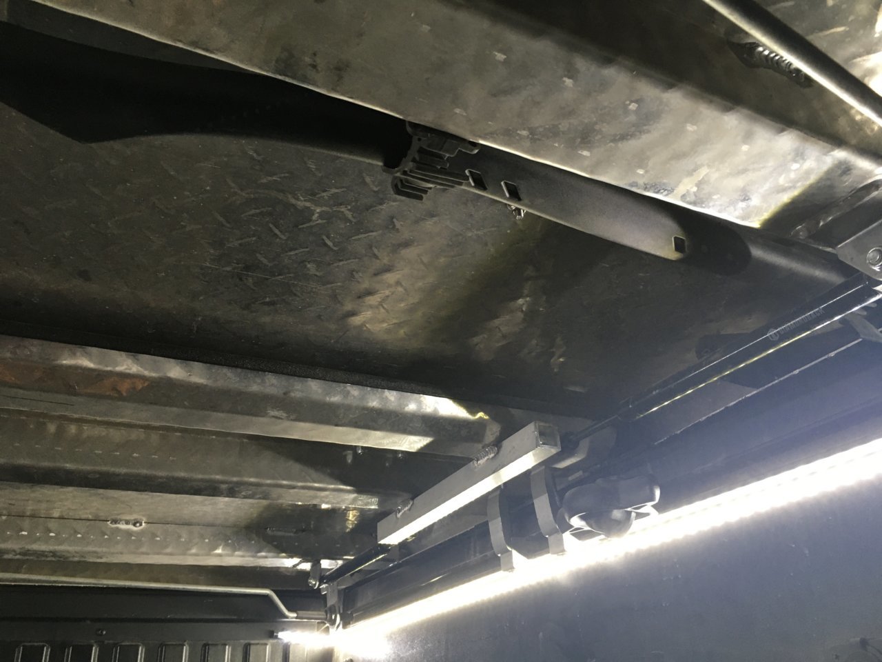

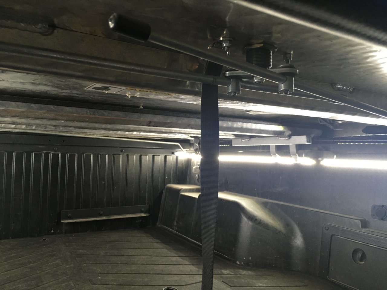

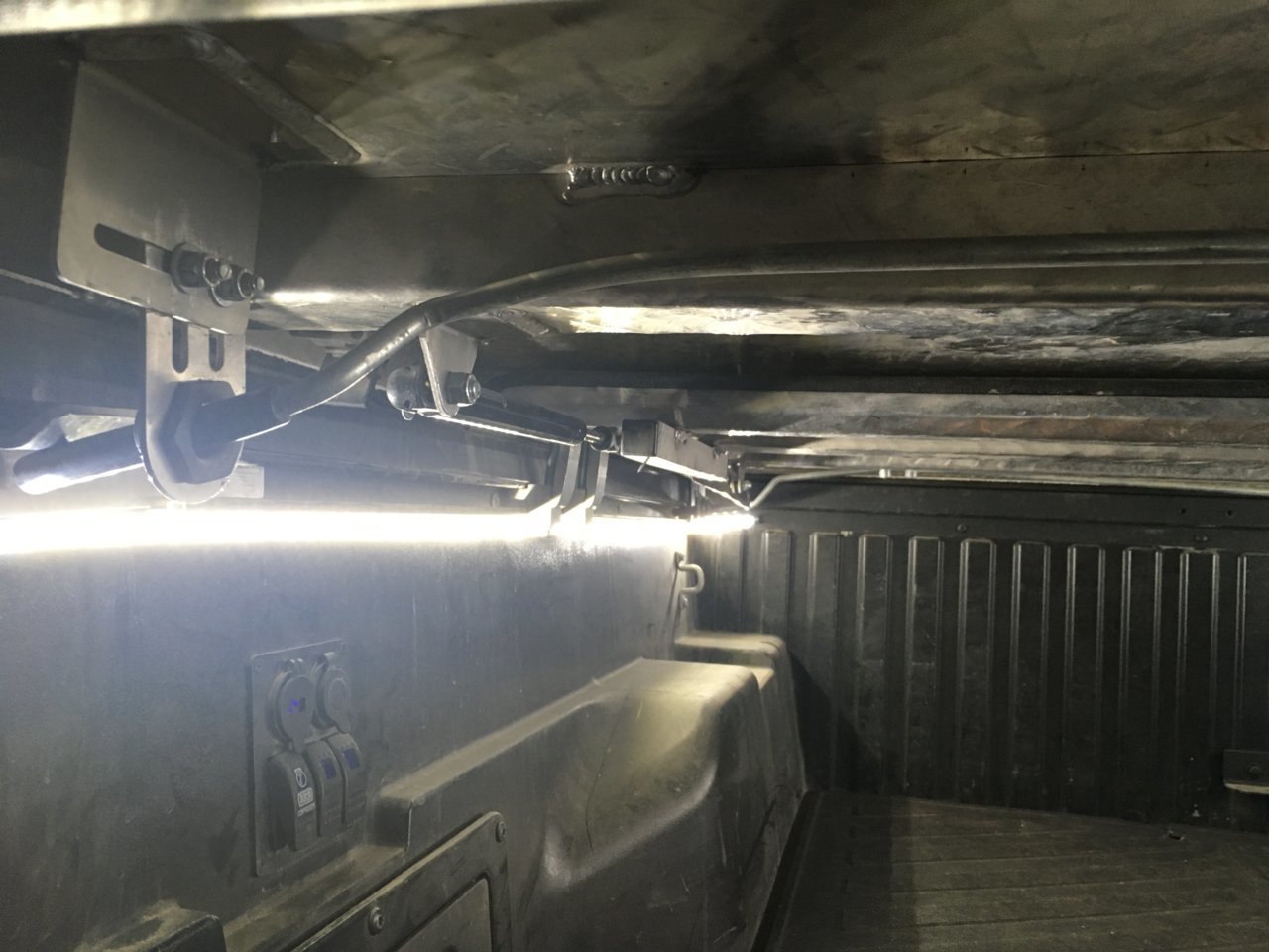

    I didn't do a write up about bending my locking rods but here’s some photos of the end result. They are difficult to bend, I took them out of the cover to do it. But as they are so rigid they work exactly the same as stock and gave me back a couple of inches.

    Nice! Thanks for sharing, Dave. I was wondering what you did exactly with the rod the first time you mentioned it, like over a year ago. Good to see that it does, in fact, still lock with that bent/modified rod. Gotta ask Diamondback Covers, if this can be done and sold from the factory.
