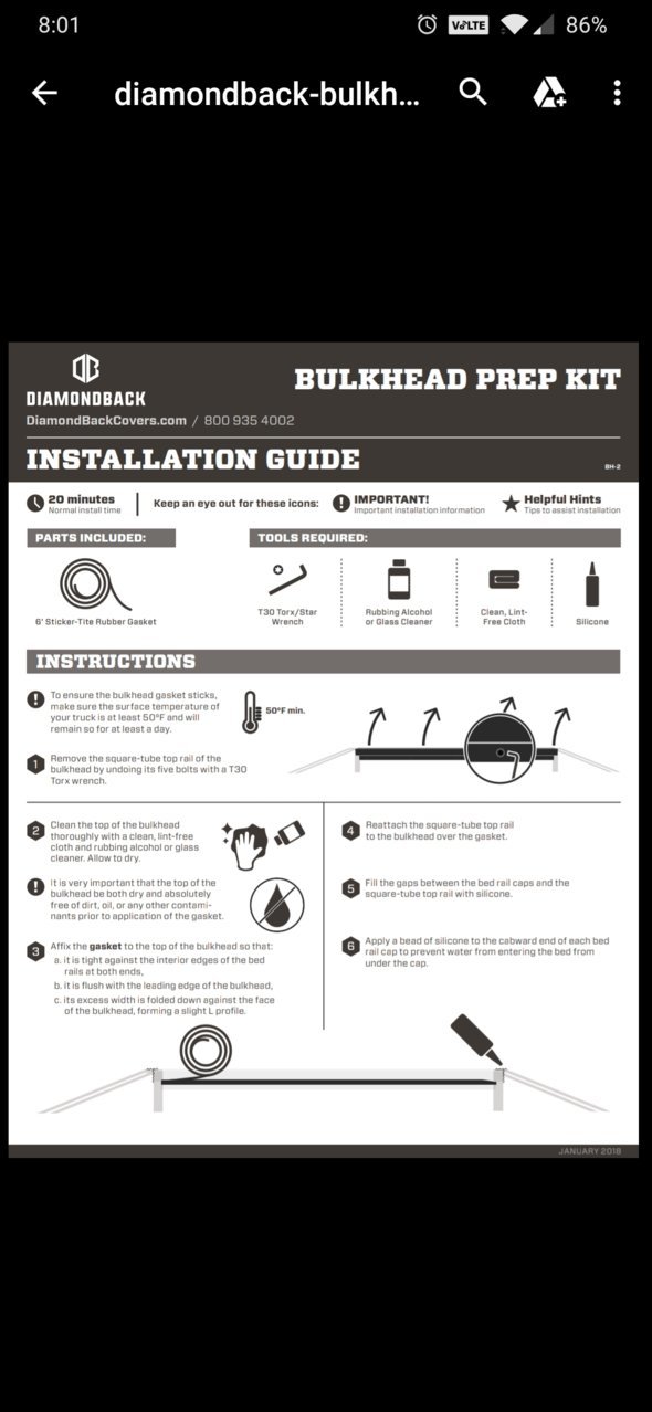

    So my Diamondback SE is arriving in 2 days. I started reading the install instructions. What's the use of the gasket on the bulkhead under the cab tube for?

    Cab tube? Under the perimeter is a flexible seal similar to a car door, and they provide an extra flat weather strip to make sure the seal between the top of the bedsides and cover is water proof. That extra weather strip sticks to the top of the bedsides. The key aspect is really compressing the cover down when installing it as the gasket is fresh and doesn’t want to easily squeeze flat for a tight fit. After some time it will compresss nicely and keep out 99% of the water

    I'm talking about these instructions...

    I skipped this step. Only do it if you end up leaking in that area. I saw it as unneeded. You can always do it later if needed.
