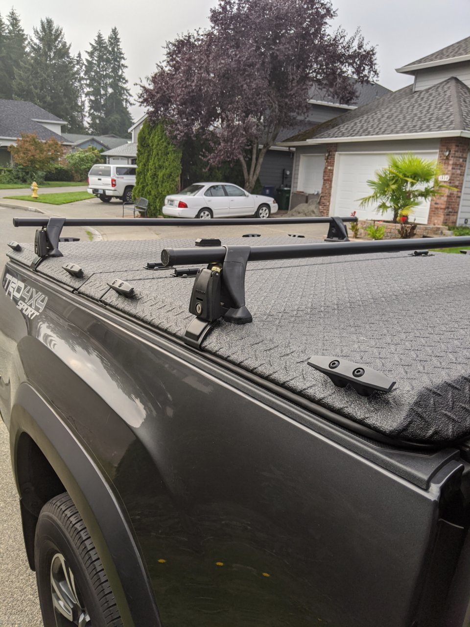

    Does anyone have any insight or suggestions with regards to installing crossbars on a diamondback cover that mount to the cleats? Trying to avoid drilling anything permanent into the cover and want to be able to take the bars on and off easy.
    Saw this picture as inspiration but not sure what mounts he is using there:

    Those are the guttered thule roof racks. I went with yakima q towers with q119 clips. Got the q towers off my Honda Civic. Clips and longer bars were cheap since the q towers are discontinued

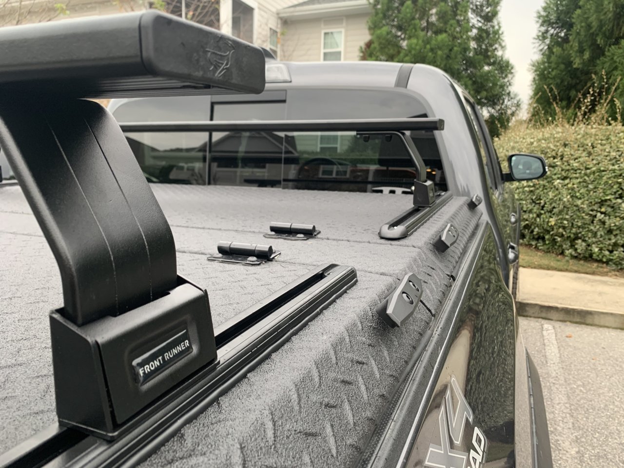

    Installed the frontrunner load bars on the diamondback hd cover. Will be mounting a RTT soon. Seems like a solid setup so far.

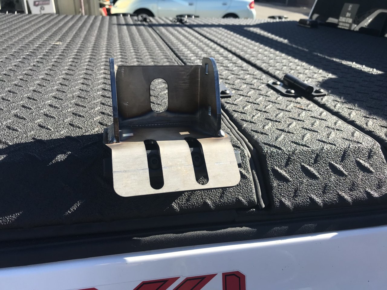

    I have been working with a local shop to fabricate some custom brackets to make my the diamondback even more versatile. Project should be finished before the end of the month but here is a seek peek.
