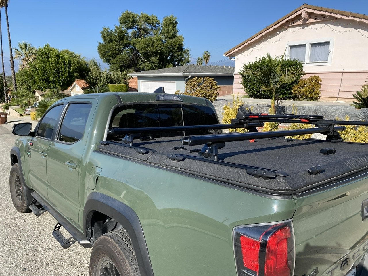

    I know front runner is the main stream go to rack system. Here is a alternative and more functional in my opinion for those wanting something else (better).
    Yakima HD set up with Thule tracks. With this set up is more low profile compared to front runner and the whole system can be detached quickly and or length adjusted with one tool, no need to unscrew or anything. I ll have more photos to follow when my ikamper mini gets in, this currently system should also fit the ikamper mini with a Yakima high roller bike mount, hope this opens up more options for Diamond back users :)

    That looks really cool. But still I like the clearance I get under the front runner to put stuff. Everything from your rack is a lot more functional though.

    Why did you go with Thule tracks and not Yakima?

    it was just what was available at rack attack. Their recommendation was the thule tracks regardless, everything fitted perfectly and there is no proprietary hiccups. I did some minor research and it seem thule tracks may go thru more testing? i think either way it should be no issues, both tracks has to be cut to be perfectly aligned with the diamondback anyways.
    More break down of the set up with cost if interested:
    2 x Yakima landing pad (1) $126
    1 x Yakima skyline (set of 4) $225
    1 x Yakima HD bar SL adapter $30
    1 x Yakima HD bar Large $249
    1 x Thule track $149
    this is a little more expensive than front runner, you can also run this set up without the track and it would be roughly the same cost as front runner but it would be a fixed point landing pad mount. I think for the quick detach function(use your diamond back without any racks within a min) and easily adjusting the positions opens up more options for mounting other things.

    Thank you for this breakdown! Some more questions if you don’t mind me asking (this is an awesome looking setup!)
    1. How far do those 68” Large HD bars extend over the sides? The DB FR setup uses only 58” bars... :head scratch:
    2. ~~Are landing pads required? I was under the impression you need the bar, skyline towers, and sl adapters...~~ never mind, I see it now
    My biggest concerns with the front runner setup was it not being low profile, and those cross bars being way too wide to accommodate my Yakima skybox.

    1. I originally went with the medium bars for a perfect fit but i wanted a ikamper mini with a full bike and the medium would not have been able to accommodate. the large HD bars does not extend much over if you look closely ( i will have better pictures when my ikamper comes in), the benefits of the large is im able to slide the bars more to the left or right and really extend it if needed where the medium cannot be slided.
    2. the landing pads are needed for mounting on the diamond back if you want QD (quick detach). With fixed points i don't think you need it. With the track system like i have you do need the pad to slide up and down and quick detach.
    with the Yakima HD it pretty much works with all Yakima parts and most thule as well. i know someone mentioned the clearance space in between the diamond back and the bars being smaller than front runner but realistically i still have enough room to stuff cloth, shoes, small items etc... and i don't think the front runner clearances allows a cooler or box to be fit in between either. with an roof top tent i believe it should not exceed the top of my vehicle with this currently set up so its as sleek as its going to get. Also, i think the weight bearing load is higher on the Yakima HD bars then front runner as well, not that most ppl will ever utilize all of it but is nice have a higher buffer.
    all prices were quoted as brand new, i know you can probably find most of these items at rei yard sales or other sources in decent condition for a much cheaper price as well.
    let me know if you have any other questions as well, i know i been looking for a sleek modular do it all type of set up that still has the diamondback functioning by itself as needed.
