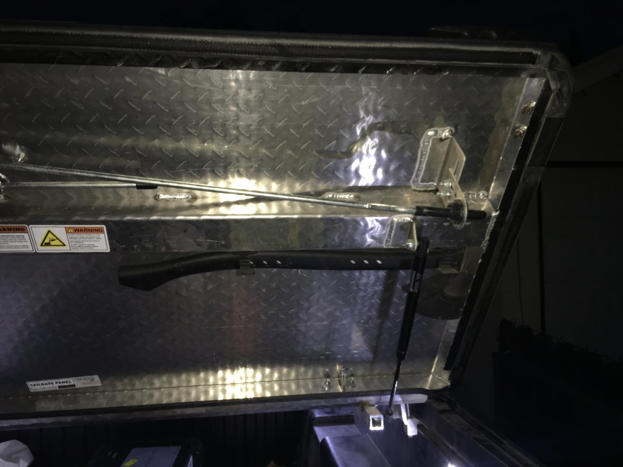

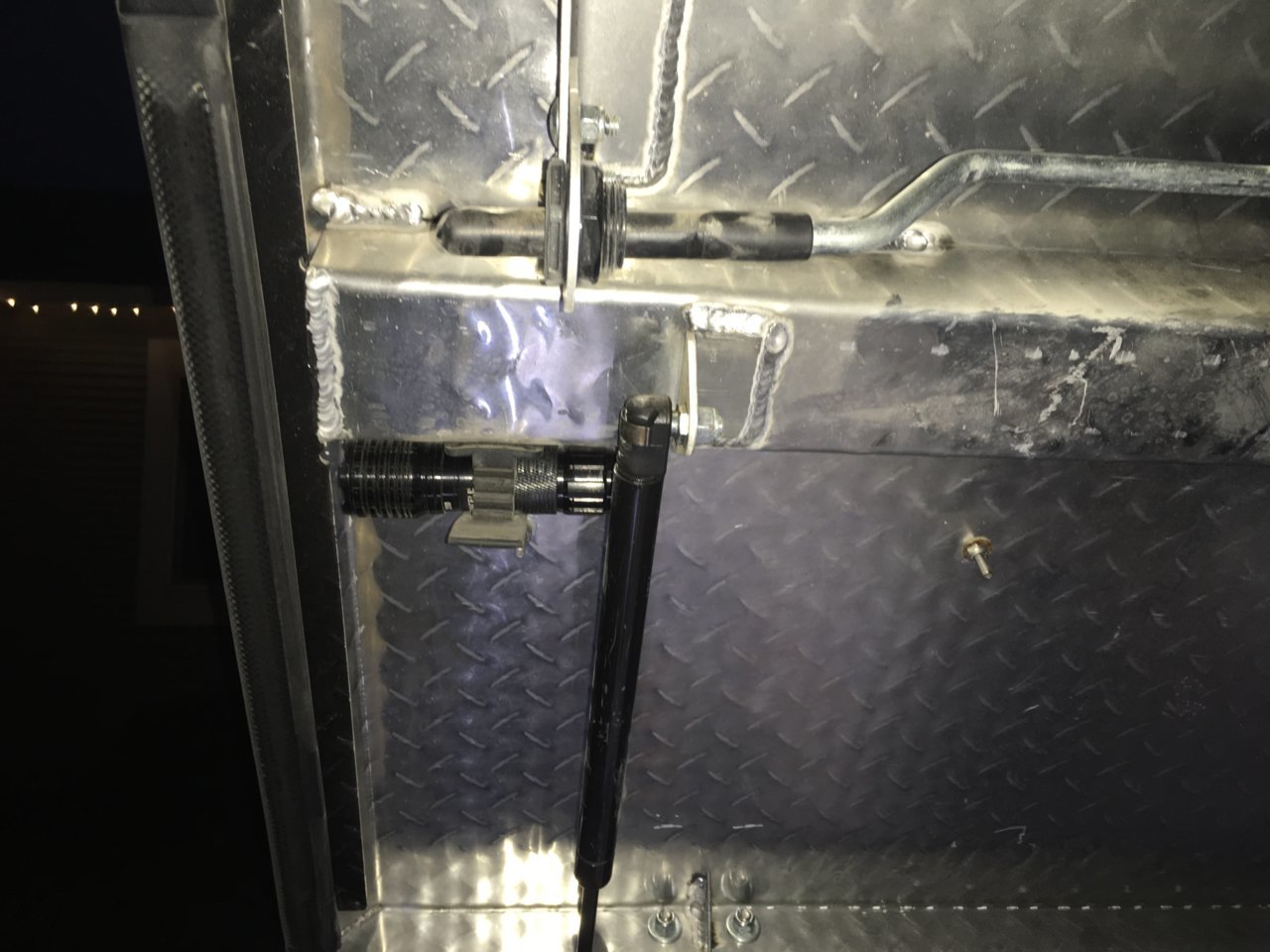

    I have quick fists mounted for a flash light and axe, they tuck up nicely under the cover. I screwed right into the cross rib portion and it’s a beautiful thing

    I like it!

    Love that axe placement. So doing it. Self tapping metal screws?

    Just fat wood screws as the cover is aluminum. Easy

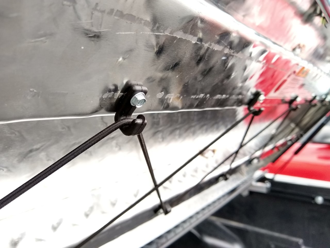

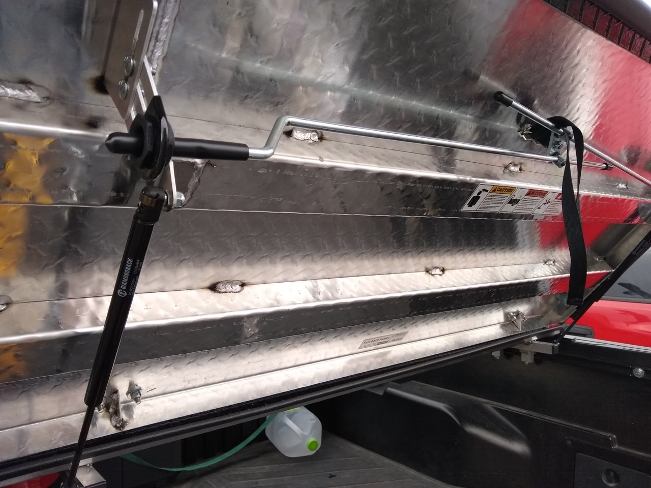

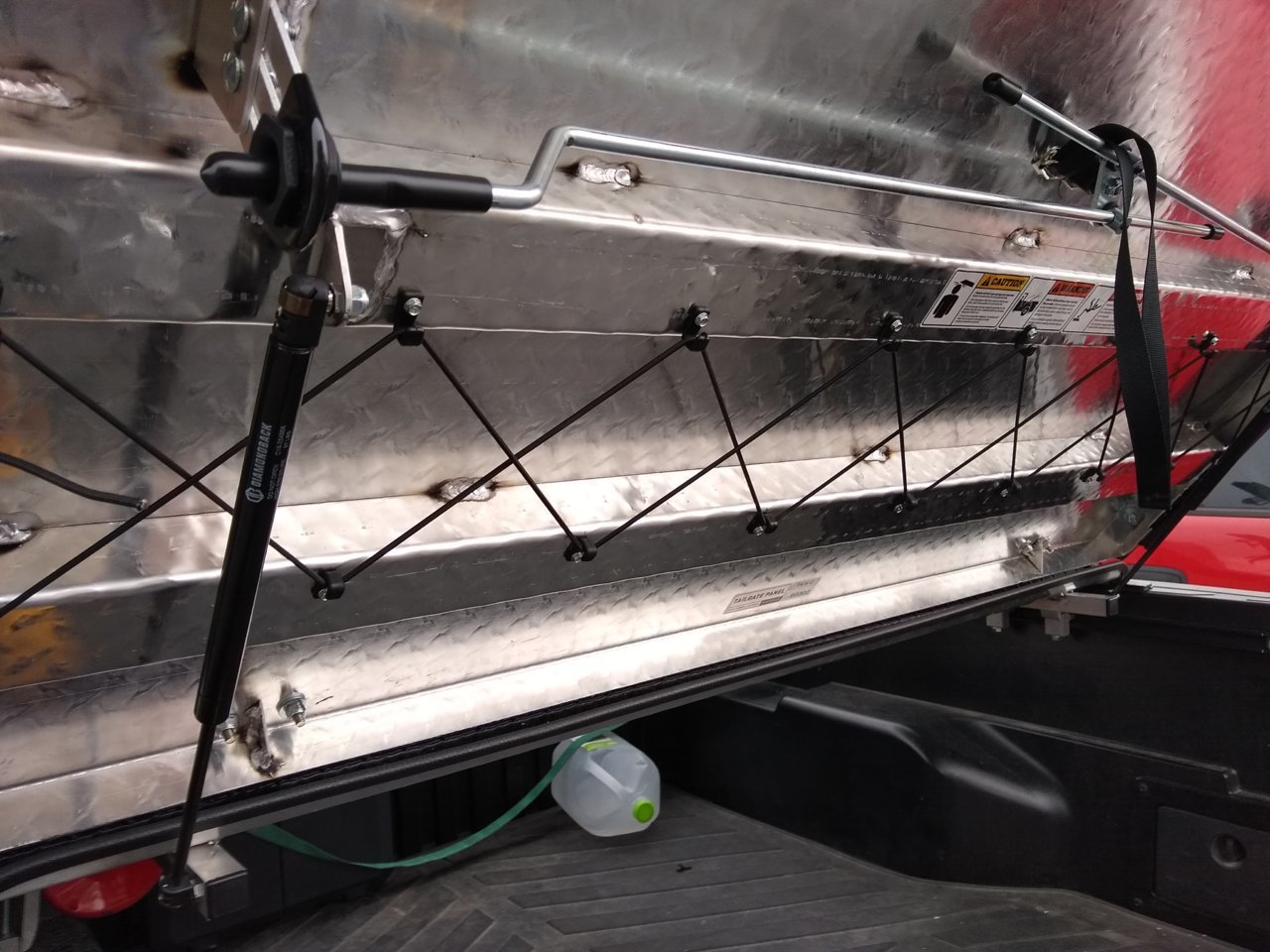

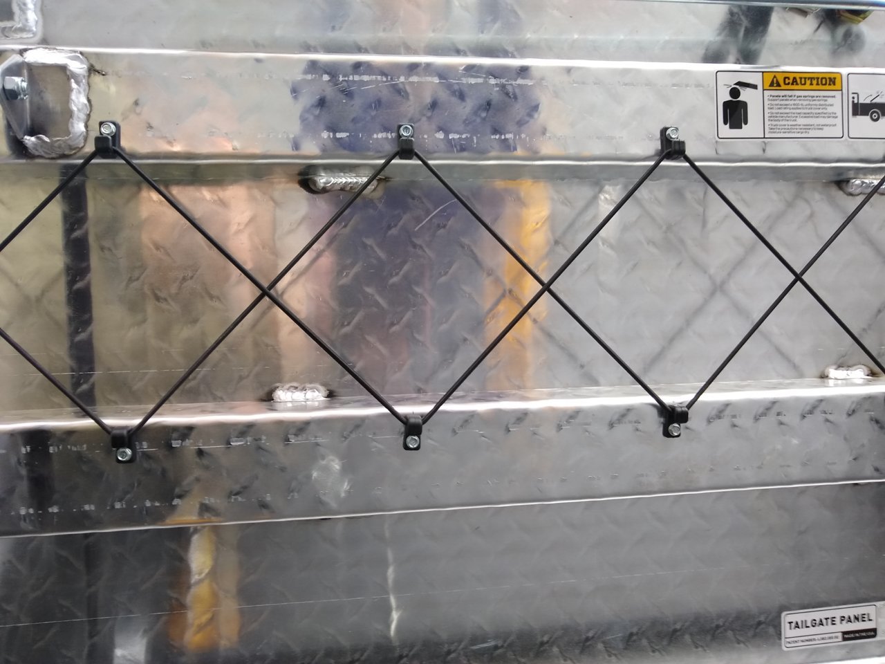

    Before
    After
    I went with some small plastic J hooks, spaced them just over 7 inches apart. I will be getting plastic clip so I can adjust the tension of the shock cord, depending on what I place in it.

    Outstanding!

    Adding this to the mod list. I have a nice idea to run with. Thank you, sir. Looks great.
