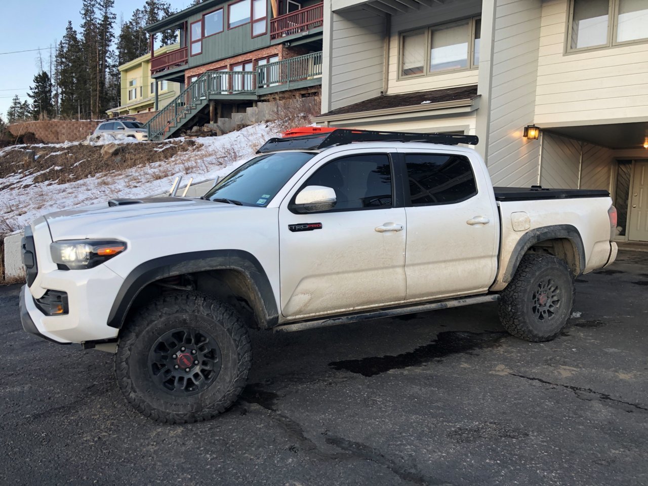

    Hey, I'm new here. Had to make an account to ask what tires you are running. Looks good!

    BFG KO2 285/75/16

    Did you have to do any modifications for them to fit?

    Yes I am running the Revtech Level kit with the add a leaf and SPC UCAs. It almost needs a cab mount chop but I found someone that can actual do a front end alignment and adjust my UCA and havent had any problems yet. I taken a a few trails out here in Colorado with no problems.

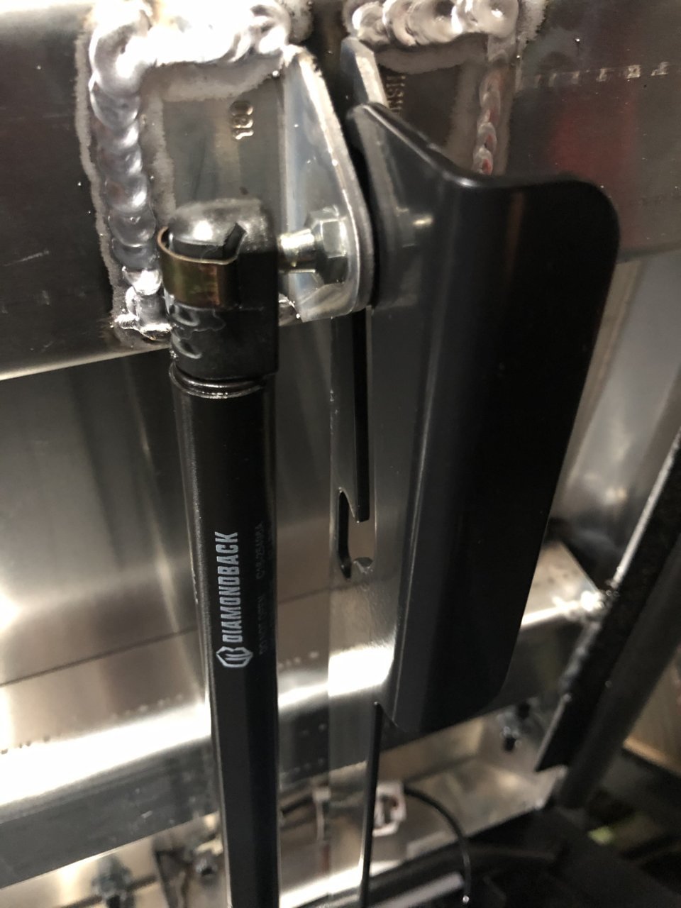

    I think you’re referring to me. I do not use the safety latch. Can’t say I tried it either though. If you turn the latch when you close the cover I don’t see how it could ever open on it’s own, with or without a safety latch.

    Did you remove the safety latch so it would be out of the way?

    I removed the safety latch because I didn’t like having to disengage it every time I opened the cover. I never tried it with the longer shocks, but I’m guessing it would limit the travel too.

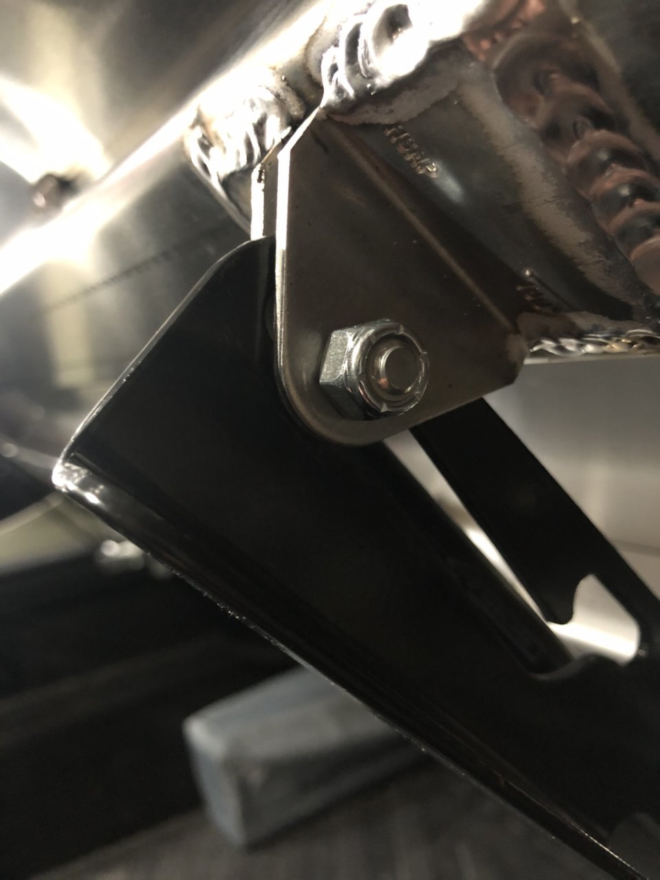

    Are you guys torquing your bolts down on the center piece? I am getting metal shavings when I tighten it down?

    The clamps are aluminum and don't need to be super tight. I would recommend a lock washer on them though as they do rattle loose

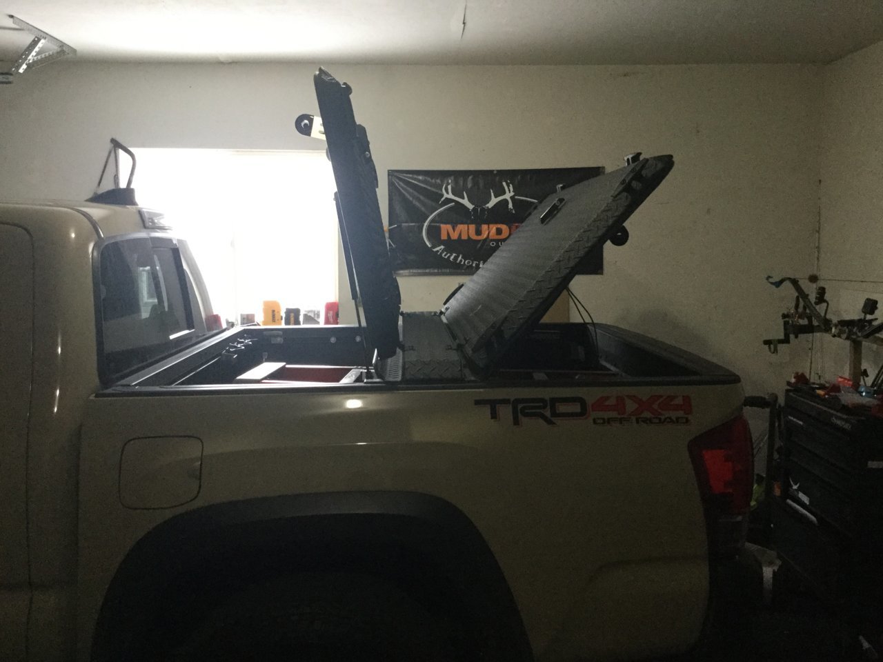

    Sorry for the crappy photo but here is an idea. I obviously removed the safety catch from mine and I used the SUSPA C16-0853. With the old gas springs when open the lid measure 22 from the bed rail (rear panel), with the new ones it measures 31. So it makes the pannels almost verticals.

    That looks great, thanks for the pic! Is it harder to close now since is higher?

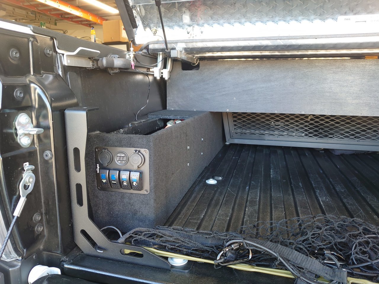

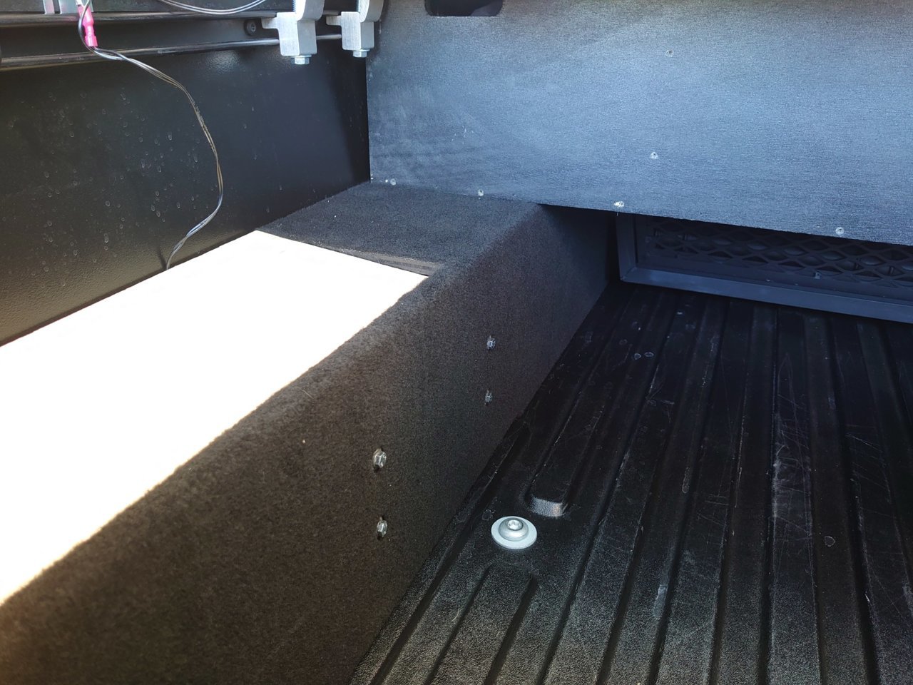

    Can anyone with the 13" cross bin help me out here? I'm trying to determine if it will fit in my bed, as I have built a small wooden addition to the side that covers the fender well. I know the 8" will fit, as it sits above where the wooden addition is, but I'm worried about the 13" where it drops down. If you could take a photo of how close the "drop down" portion comes to the side of the fender well, that would be extremely helpful. I've been scouring the site looking at photos, but no one has a close up of that area. My addition is made from 1/2" plywood, and butts directly up against the bottom of the fender well. It comes straight up from that point (doesn't angle toward the bed side, like the fender liner does), so as long as there is 1/2" of clearance at the very bottom, the bin will fit. I have an OEM cargo organizer and it DID NOT fit with my addition - I had to cut the rail on top where it attaches by about an inch, to allow it to slide further toward the passenger side. But the OEM cargo organizer has an angle built in to it, to follow the lines of the fender well, and that was the issue.

    Thank you @kwill. It's really close, but doesn't look like it'll fit with my setup. I guess I'll have to order the 8" bin instead. It looks like if that "drop down" portion went all the way to the floor of the bed, it would be making contact with the side of the fender well.
