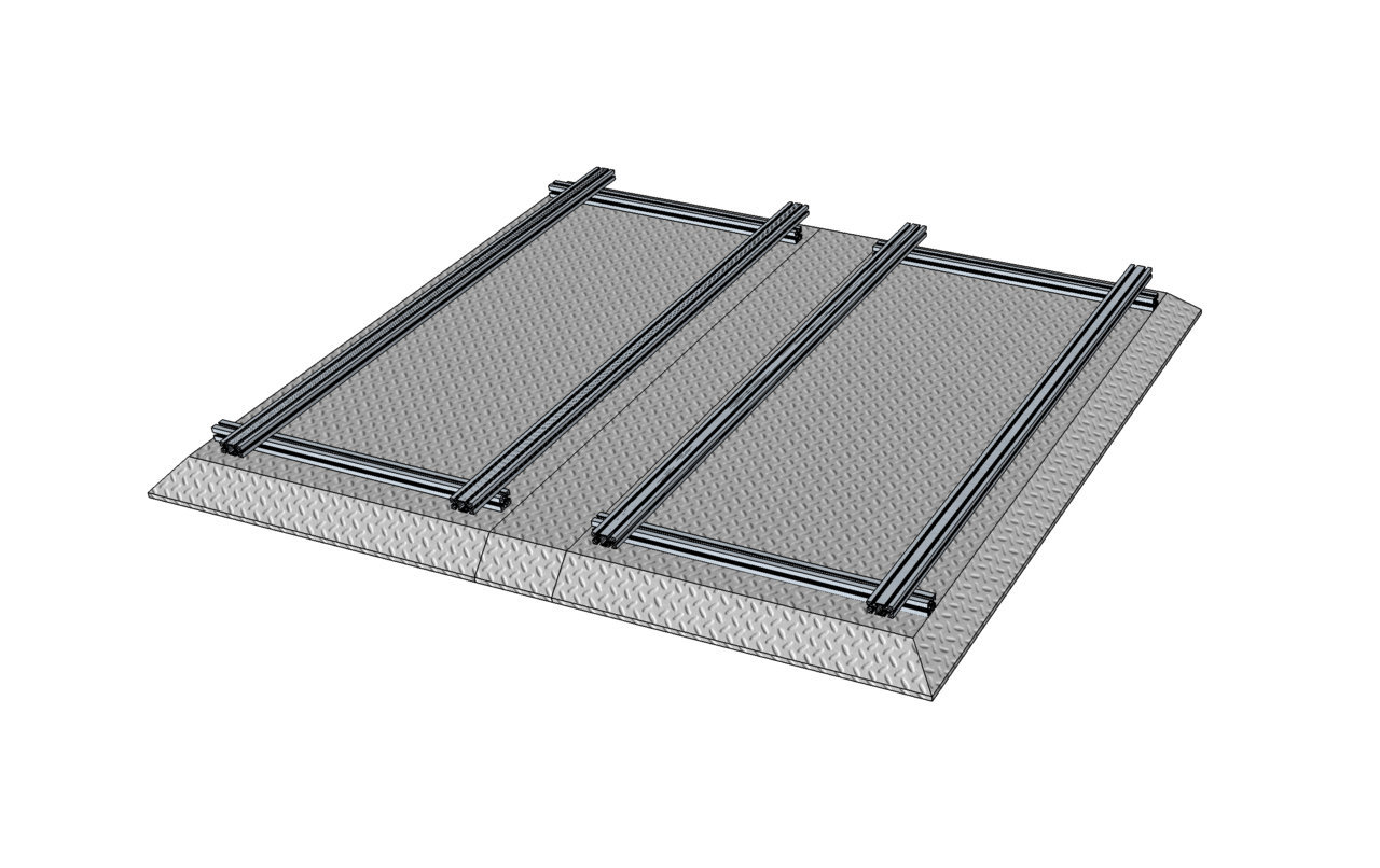

    This is a sort of rough draft of where I'm headed. The idea is that 80/20 base pieces (made from 15-series) will be bolted down to the Diamondback. This will require drilling obviously, but I ain't scared... They will serve two functions:
    1. They can be used on their own as a sort of skid that allows you to slide materials onto the bed cover - clearing the hinge hardware, locks, etc...
    2. They can be used in conjunction with 80/20 crossbars (same size as prinsu, etc...) mounted on top - allowing you to mount any of the accessories used on standard roof top racks to mount things like surf boards, bikes, tents, gear boxes, baskets, whatever... Since they are located by the 80/20 below, they are infinitely adjustable.
    Right now, I'm mainly working on aesthetics. I can get the 80/20 anodized in black and that should look fine, but I'm more worried about end caps and making it all look clean and professional.

    Great idea. I'm really interested in what you come up with.

    Excellent idea dude, keep us posted on progress.

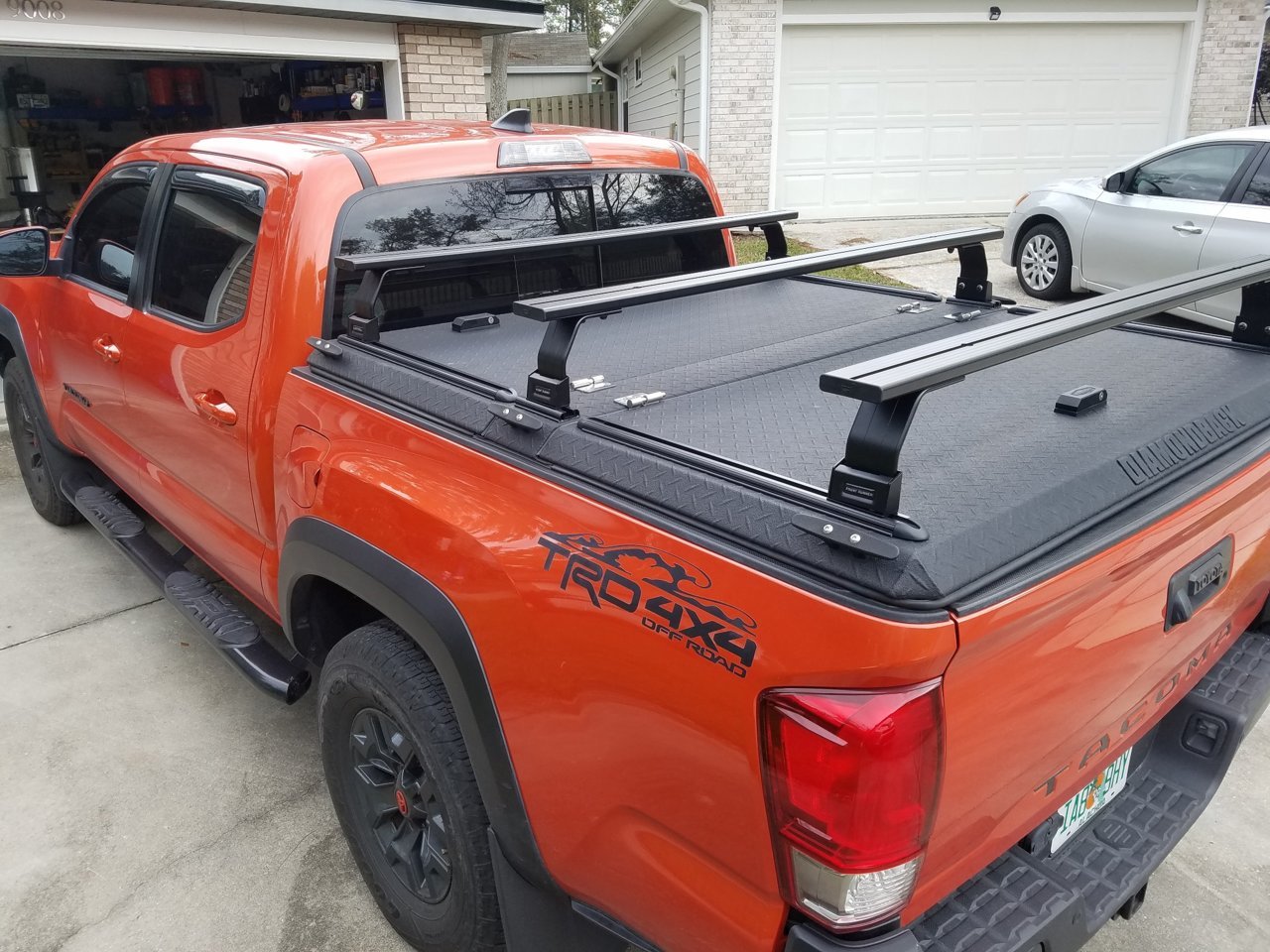

    What's the height from the cover to the top of the bars? I run an ikamper on a bed rack currently and because the top of the tent sits a couple inches above the cab I can strap my wife's paddleboard to the top of the tent and don't need a cab rack. Trying to figure out if the same would be possible with this setup.
  14. Dec 16, 2020 at 10:46 PM
    #1154
    orion808
    orion808 Jack of all trades. Master of none.
    Aug 30, 2017
    #228617
    622
    Florida
    2017 Inferno Tacoma Off-Road (Premium & Tech)
    Interior LEDs Hardwired DashCam/Extra USB Black "Tacoma" on tailgate Blackened Badges Nerf Bars Mud Guards Rear Diff. Breather Mod Plasti-dipped Grille Glovebox Vinyl LED Bed Lights LED soft glow flooring accent lights Custom switches Diamondback Tonneau 3rd Bed Rail Sill Protectors w/ Vinyl Tweeter Upgrades Tint windows Husky Floor Mats Molle Panel behind seats Speaker Upgrades Anytime Camera Mod w/ Secondary Rear Camera Plan: Clazzios 2-3" Lift
    All measurements are +/- 1/16"...
    Height from the cover to the top of the bars: 7 3/4"
    Thickness of the bars: ~3/4"
    Height from the cover to the bottom of the bars: 7"
    Height from the rear locking latch to the top of the bars: 6 1/2"
    Height from the rear locking latch to the bottom of the bars: 5 3/4"
    Hope that helps.

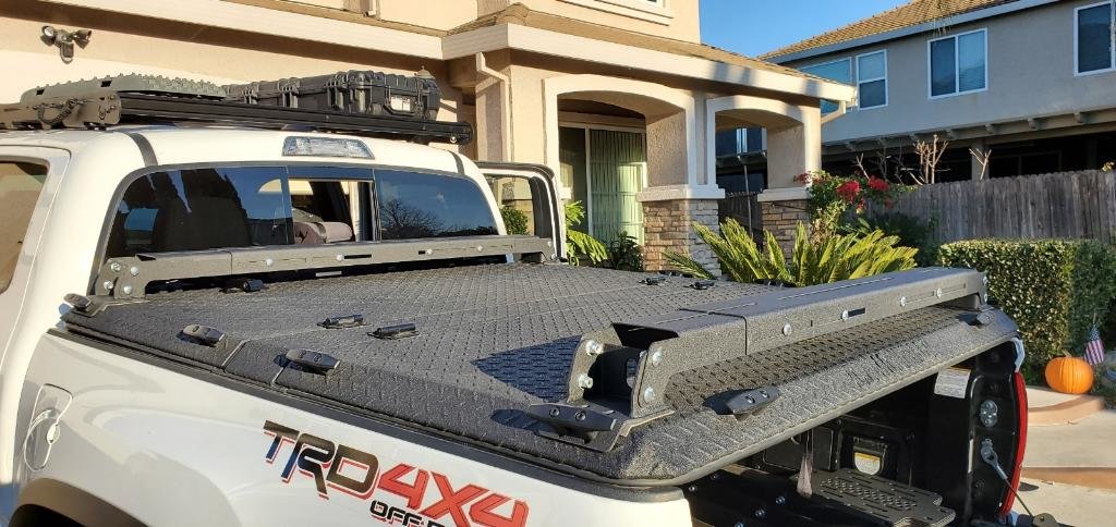

    I had my rack built with that in mind. I can convert it to just about anything I need for the job I need. I have up to 4 useable cross bars that are level with each other can handle over 1,600 lbs. A little overkill for our trucks but I can attach it to a larger trucks so long as it has a diamond back system.
