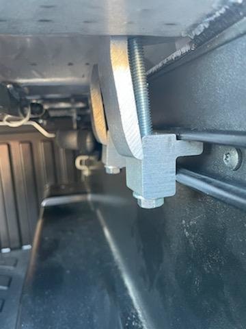

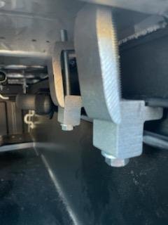

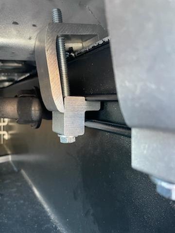

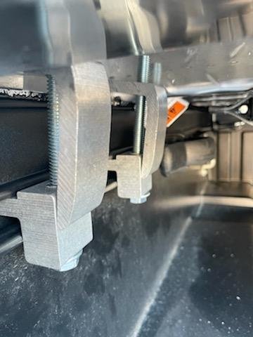

    I just received and installed my diamondback. Love the cover. I am curious on how everyone tighten their clamps and how it currently sits.
    I reached out to diamondback to request a torque spec for the four clamps. They said 15 ft-lb so I did that. Just went to check the clamps after 100 miles and noticed the clamps cause the bolt to skew. I took one clamp out to inspect out of concern and the skewed bolt was compressing the bottom piece of the clamp and widen the hole. I put the clamp back on and no matter what, it skews so Im just rolling with it. I am just wondering if this is normal with everyone. Just don't want the bolt to shear off down the road.

    I don't think mine skews. As you're tightening down, have you double checked the top half remains fully seated to the back of the panel?

    Yes, I tried keeping it straight while tightening down. Once it clamps, you can't really reposition it. I think 15ft lb may be a bit too tight. I now torqued to about 12ft lb but the hole in the bottom part of the clamp that the skewed bolt beared on is crushed and widen so It always go on skewed.

    Mine are a little too, I wouldn’t worry about it just make sure you reach in and check every once in awhile. Mine got better after the gasket compressed in the middle section, I’ve had mine on for almost 3 years now.

    Thanks for the feedback. I guess if anything does go wrong, theyre easy to replace.

    I had the same issue during installation... so far so good after 3 months.

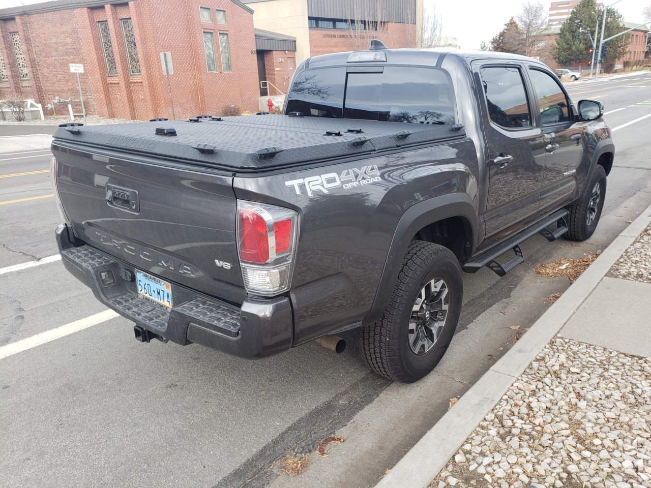

    Anyone install extra tie-downs on their DB? I got the SE but am considering extra anchors.

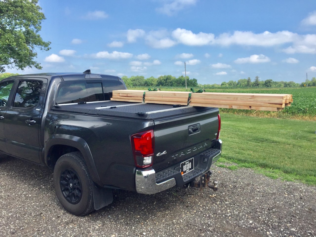

    I want to add similar tracks but I would like them to be as tall as the latches so that sheet stock can lay flat on top. I guess I could add a length of square tubing underneath to get the height. Any thoughts?
