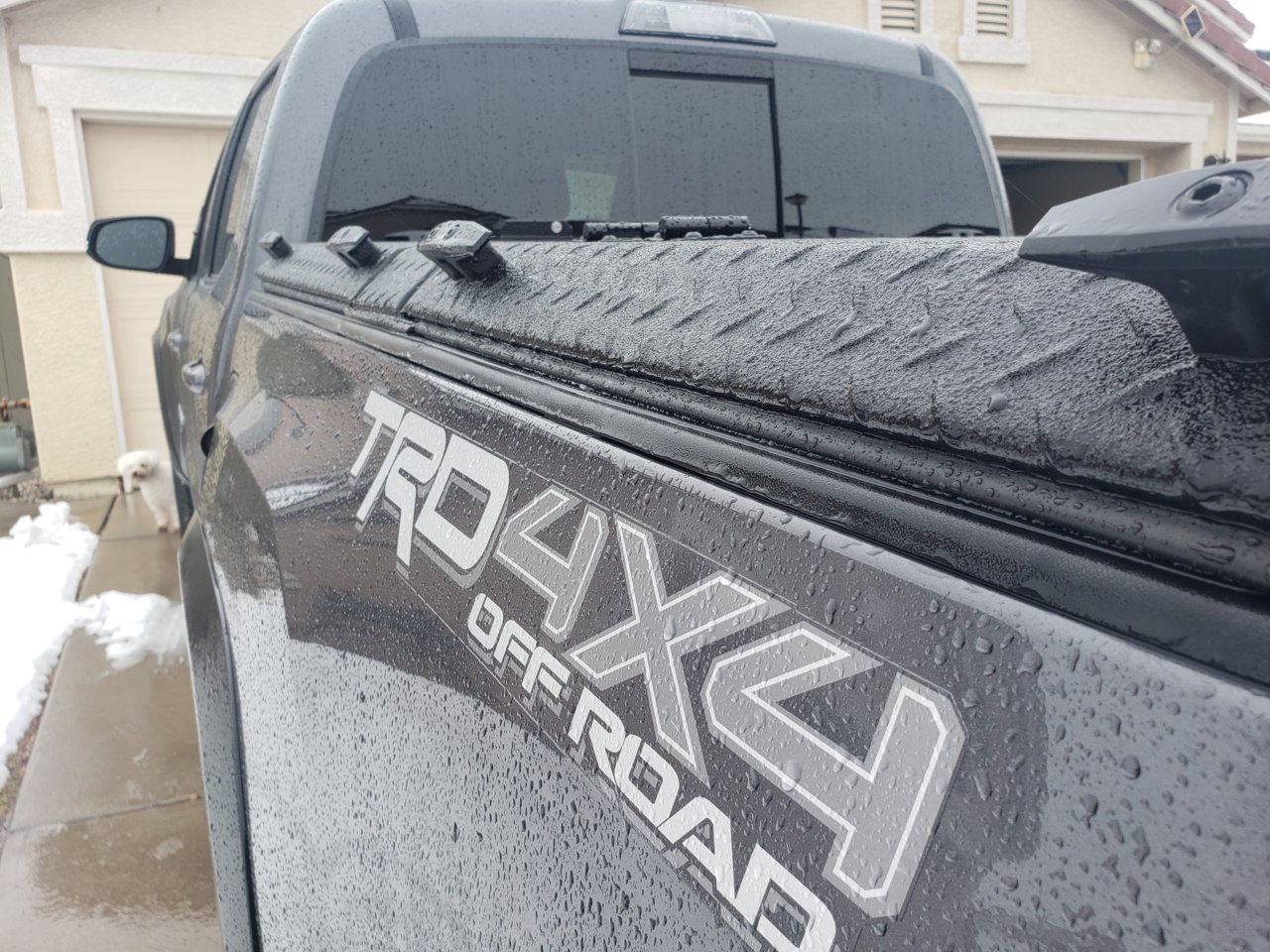

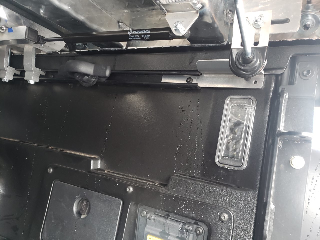

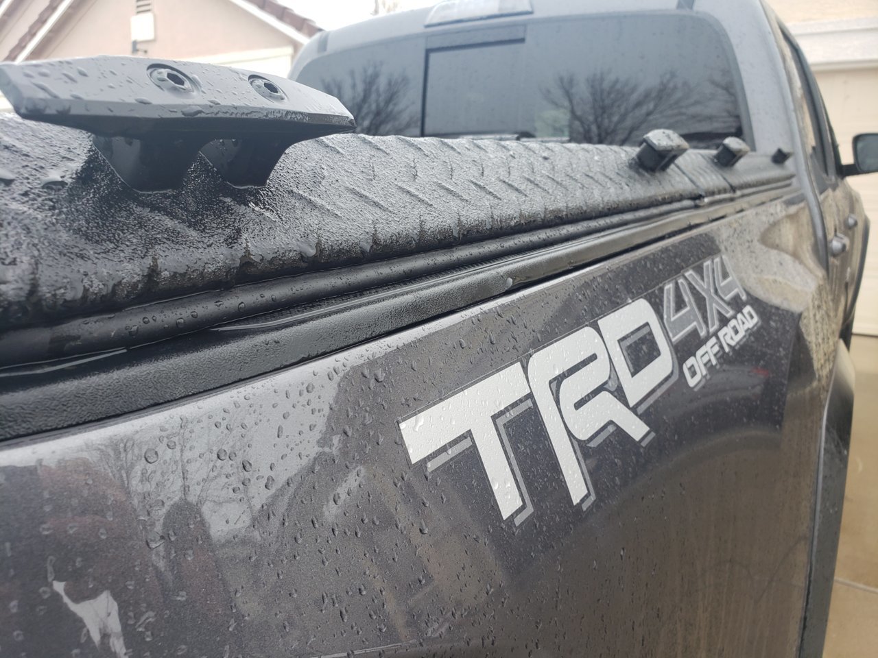

    So we just recently had a bit of snow, about 8inches. Scraped all the snow off the truck yesterday and today its just raining. Decided to check inside bed and see if its wet and it is. I checked the weather seal and it's fine. I checked the locations where DB said to put silicone and I do not see any daylight. Based on the pictures, it appears some are coming from the bed railing since the water appaers to start a bit below the cover. At other locations like the bulk head, it looks to be at the top. I had my wife sit on top when I installed the cover so I think it should be locking tight. Any idea how water is getting in and solution to fix this? The truck gets parked outside on the driveway on an incline. Not sure if that matter.

    Seems like condensation to me. If there was ice on the cover and it got a little warmer, it might have done that. It has done that to mine a few times.
    To double check and make sure the seals are good. I would suggest getting inside, close it up, and have someone spray water all over it.

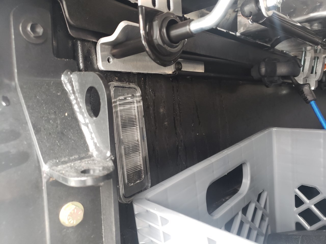

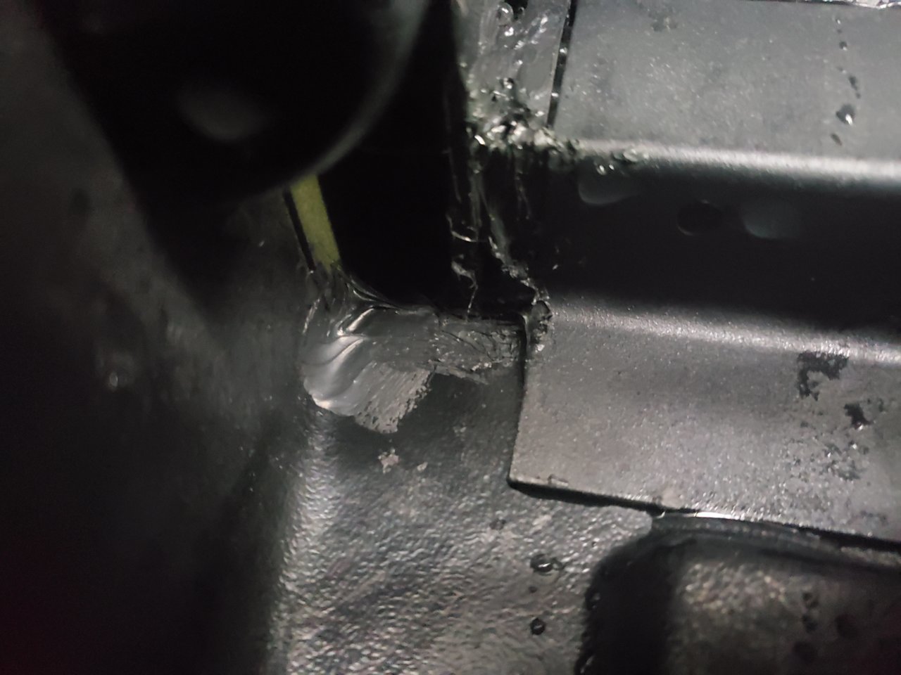

    Now that it stopped raining, went out and opened each side of the cover to inspect. Beneath the weather seal, it is dry. Felt under around the interior edges of the bed and under the interior side of the bulk head, it was wet in those locations. Like you said CttAznRanger, could just be condensation. But then again, it be water seeping under somehow. Just need some dry weather to verify everything so it won't be for a while.

    Mine leaks like that. Never amounts to much water so I never worry about it too much.

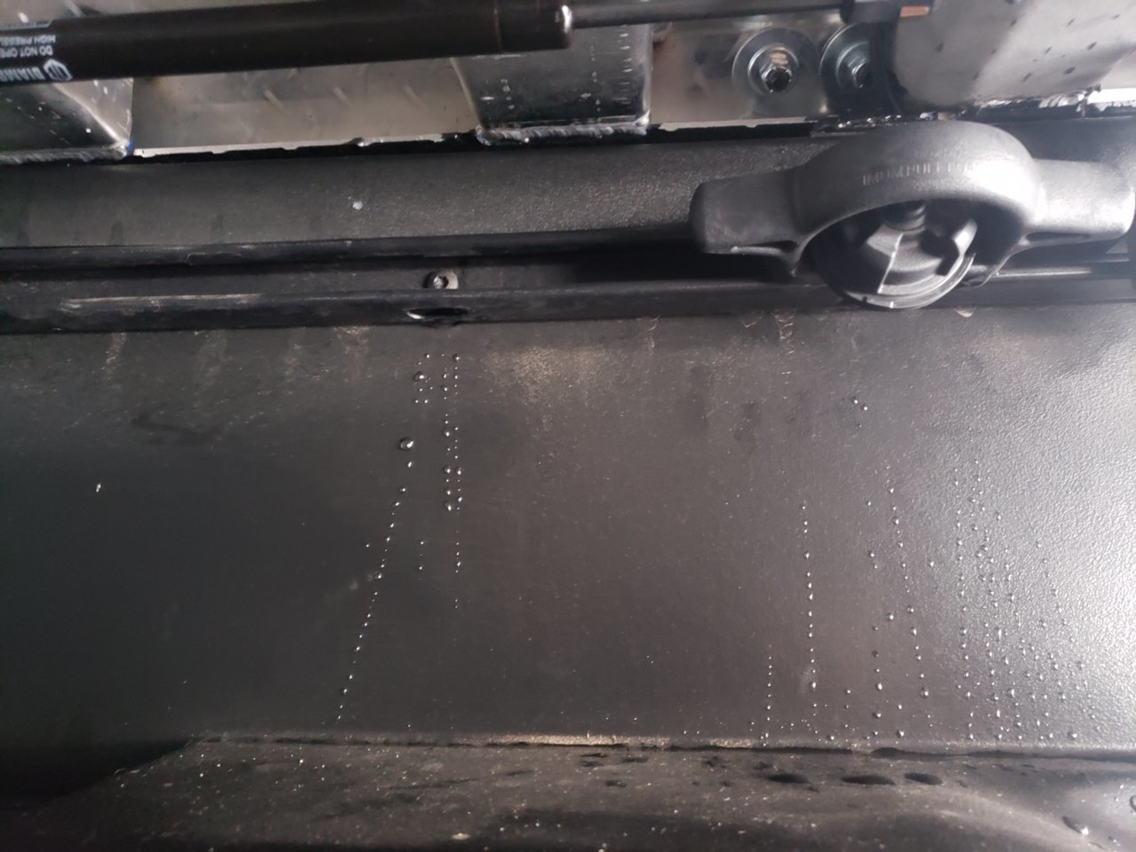

    Mine leaks like that too. It is not condensation. My truck can be parked all day when it's raining and when I come out and open the tailgate it will look like that all the way around. DB seals around the edges seem fine. Haven't figured it out yet but it sucks.

    Hmm maybe I'm confusing that link with another forum. I thought I read somewhere that sometimes, overtightening of the clamps cause the bed cap to deform and water could get down there. The original poster was having issues with water coming in near the center panel. I wonder if water is getting under the bed cap and causing the leak.

    That might be it. I unfortunately over-tightened my clamps, but I haven't seen any issues yet.
