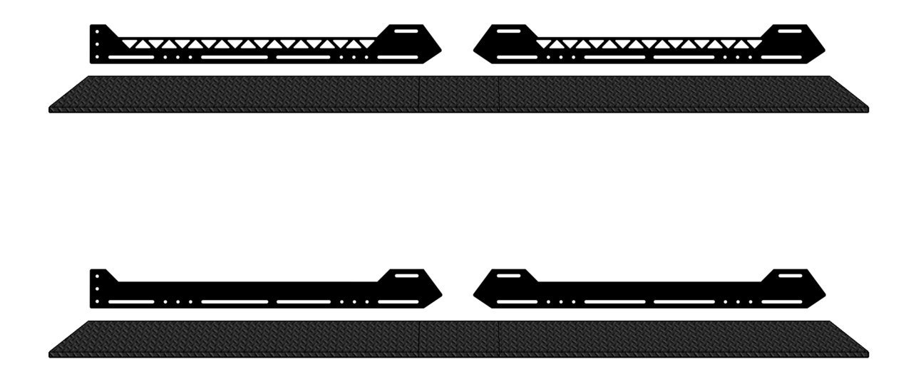

    Thought you guys might be interested in how my project is developing... My rack will be a hybrid between a Front Runner and Prinsu/UpTop roof racks. Each rack will operate independently of each other so that each panel can open fully, but can be used together obviously...
    What you see here are my rack sides. I am still trying to decide if I want to use the triangle cut outs or not... I don't know if I dig the look, but I do think they would be handy for light tie down work.
    Anyway, these sides will be tied together with 80/20 crossbars. Then, the whole thing will mount to the diamondback using 40mm Front Runner feet on Front runner rails.

    I am assuming this is going to have an overall low total height from the top of the cover based on the frontrunner feet and rails.
    I would say pass on the triangle cutouts, as it might not be too terribly strong, but maybe another design with notches to be able to bungee stuff to, like the groovetek.

    I'm starting to agree... I plan on lining the edges of the diamondback with L-track... so I will have plenty of tie down options.

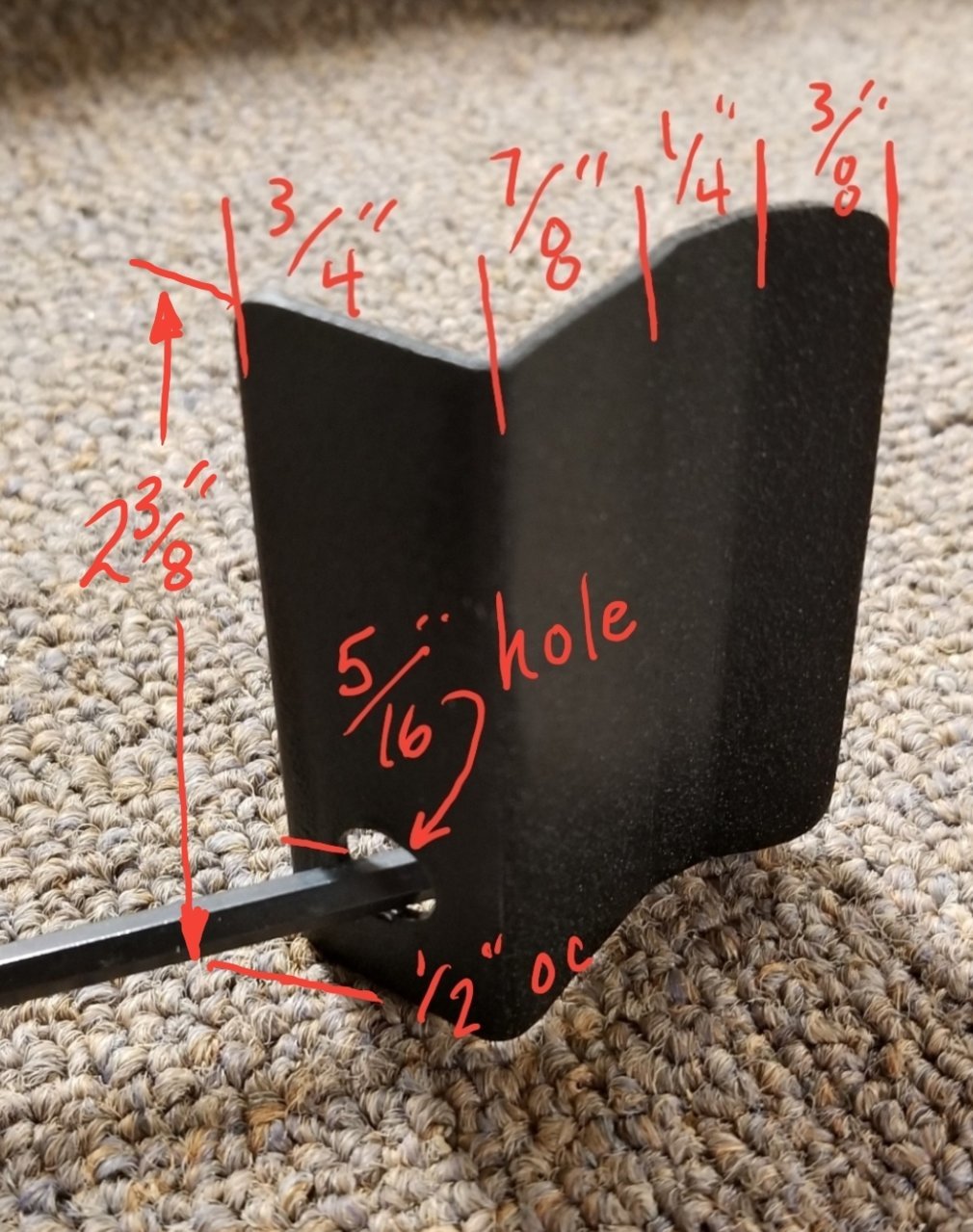

    I kept tweaking on mine but couldn't make the passenger front side pull down like I wanted. When I was able to get the passenger side to latch it was too loose. So I took a scrap piece of aluminum & fashioned a striker plate for the passenger side front panel. Now it pulls down nice from the drivers side.

    How did you do that?

    A little trial & error... a bench vise, hammer, tin snips & file then finished it with some rattle can bedliner. I modeled it after the DiamondBack rear striker plates. It's attached using the screw inside the bedrail. Mine isn't as robust as DB's but it still works and don't think it sticks out far enough to snag a forearm while reaching in. I posted the dimensions for my 2Gen... not sure if it'll work for 3Gen tho.

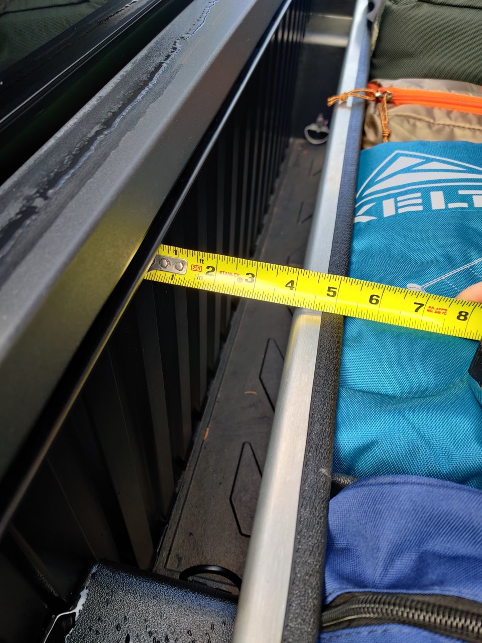

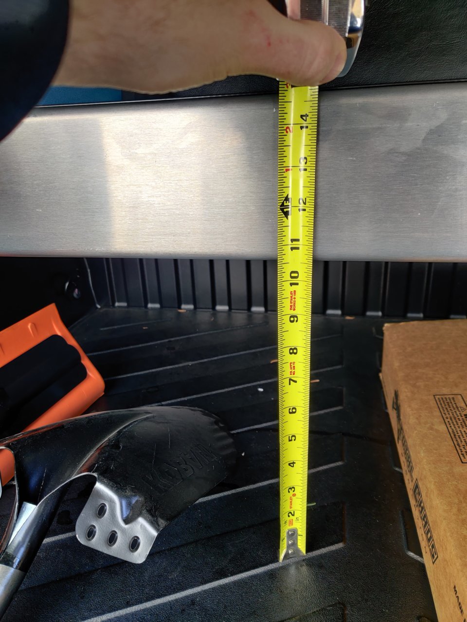

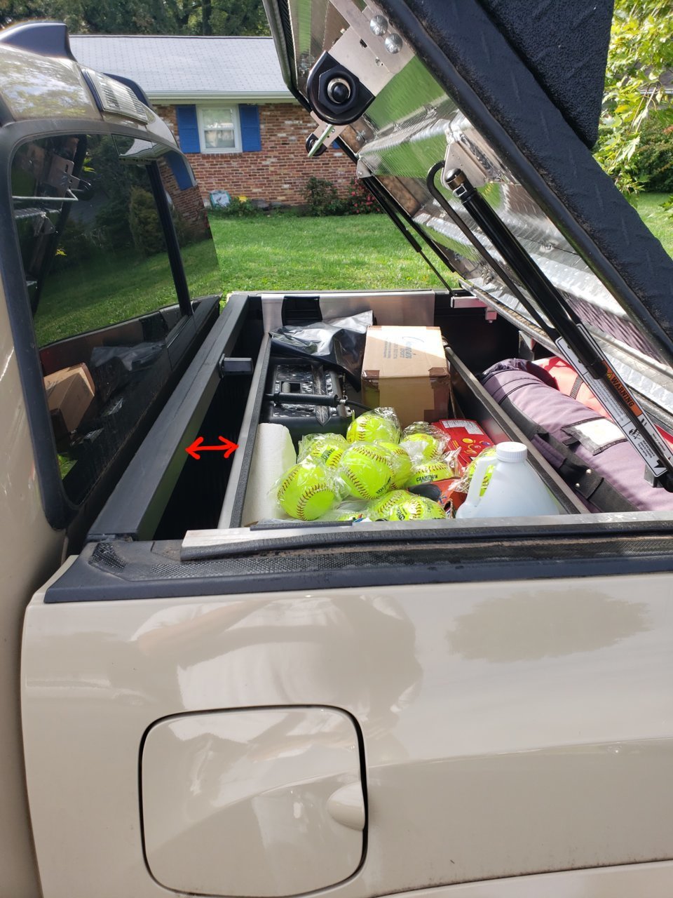

    Would someone with the 8 inch drop in tray be kind enough to get a couple of measurements for me?
    Trying to determine if my maxtrax will slide into this slot. Pic is from @TomTD Hope that's ok.20210219_012615.jpg
    Also, could you measure the space under the 8 inch tray to the bed floor? Trying to determine if my standard 2 gal gas can just might slide under there.
    Thanks in advance.

    I happened to take these the other day while planning what I can fit behind and under my 8 inch bin.
    FYI, my bin is pushed up against the factory tie down points at the back of the bed which are just out of frame on the bed sides. The bin could be slid either direction to increase or decrease the space between the bin and bulkhead. Remove the tie down points and it could be more flush with the bulkhead. It can be pushed further towards the tailgate a few inches with no problem
    I also have a bed mat if so take that into account for the under bin measurement.

    Nice! This is perfect. Thank you so much.
