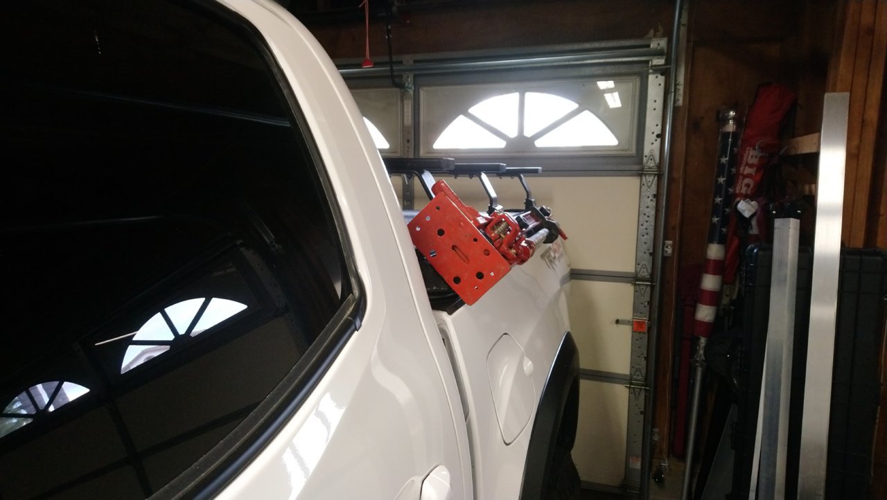

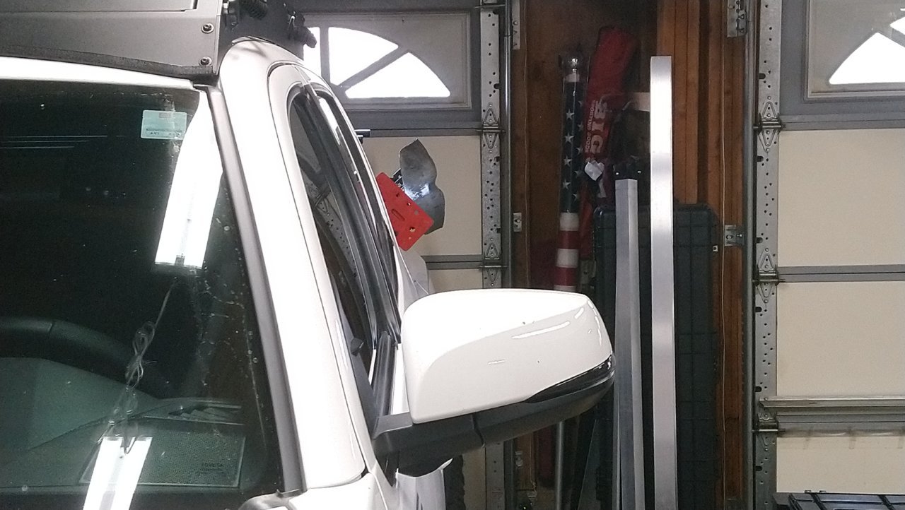

    Rear rack on...
    My plan is to live with it for a week or so and make sure I don't need any design changes before I send the side plates off to powder coating...

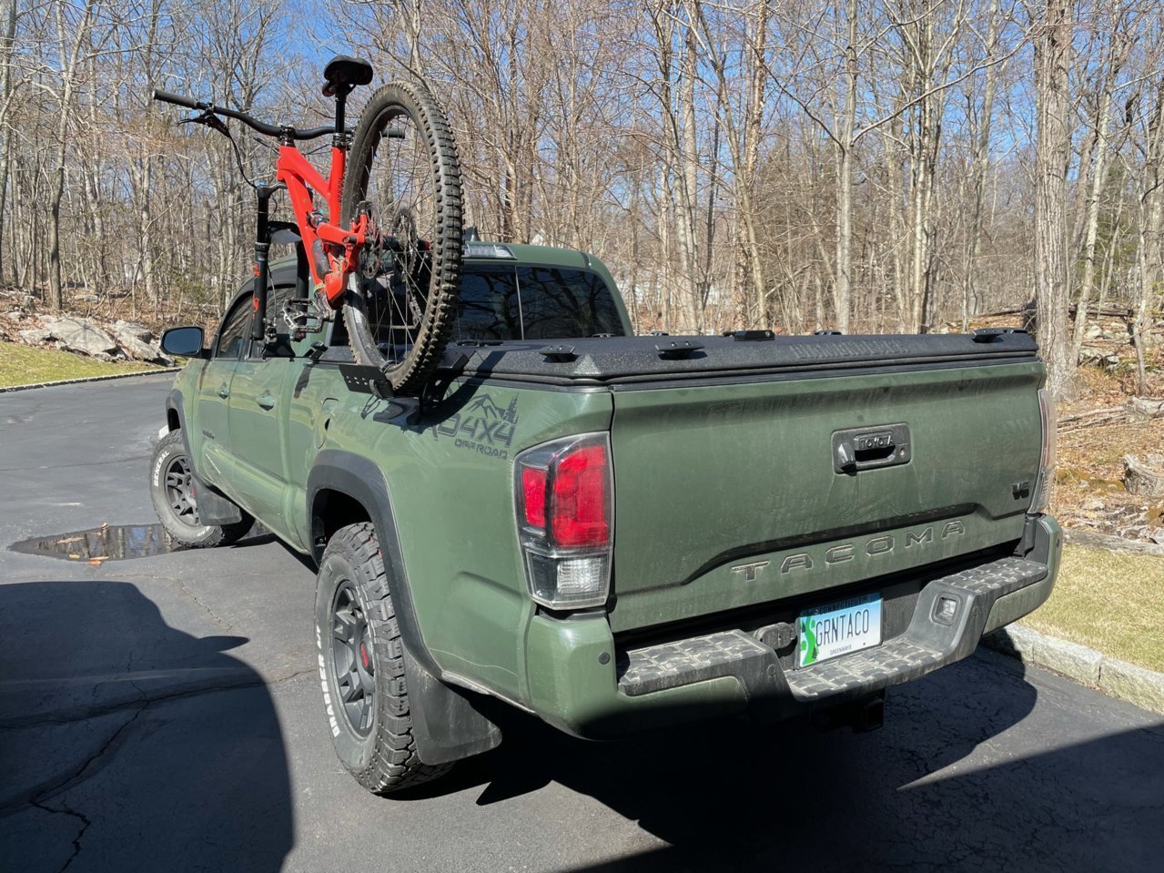

    Why does the bike have to overhang off the edge of the bed? Wouldn’t it be a stronger design if it sat on top of the cover?

    Nope, you have the original design that is mounted to the truck :)
    The bike outside the bed means full use of bedspace and the ability to open the cover with a bike attached still

    In addition to @Nimble9's comments, I did not want to be carrying a bike on a rack on top of the bed - the added height would be too high for comfort.

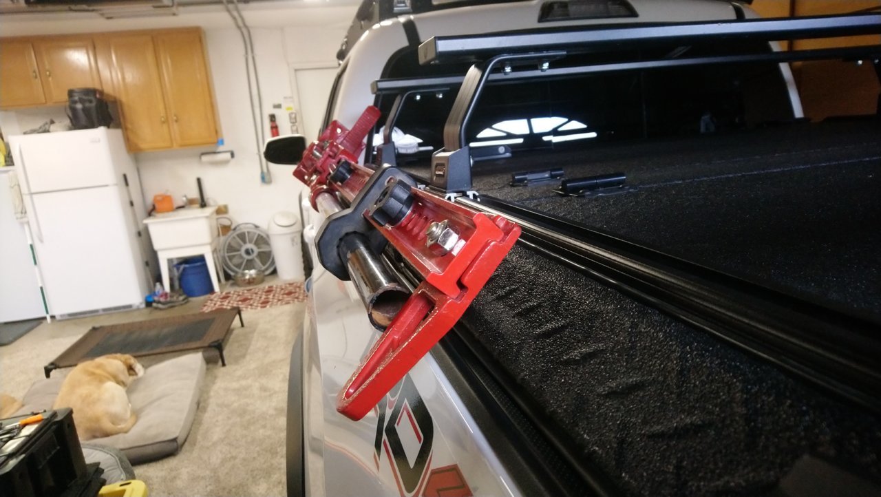

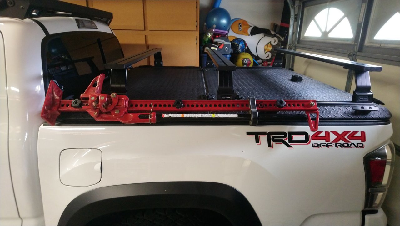

    I created mounts to attach my hi-lift jack to the side of my Diamondback cover. I used the method that Mike from Last Line of Defense showcased on a YouTube walkaround video of his rig. It just uses longer bolts that stick up through a few of the tie down cleats. I used three M8 x 80mm bolts, and it feels REALLY strong. I also used large knobs to secure it in place, where his version used wingnuts. I was worried about how far the setup would stick out from the truck, but it doesn't even stick out further than the fender flare or the wheel/tire. I also have some home made brackets that allow me to mount a shovel to the hi-lift. Side note - I only intend to keep this on the rig during off-road trips. It will be removed and stored in the garage while in daily driver mode.
