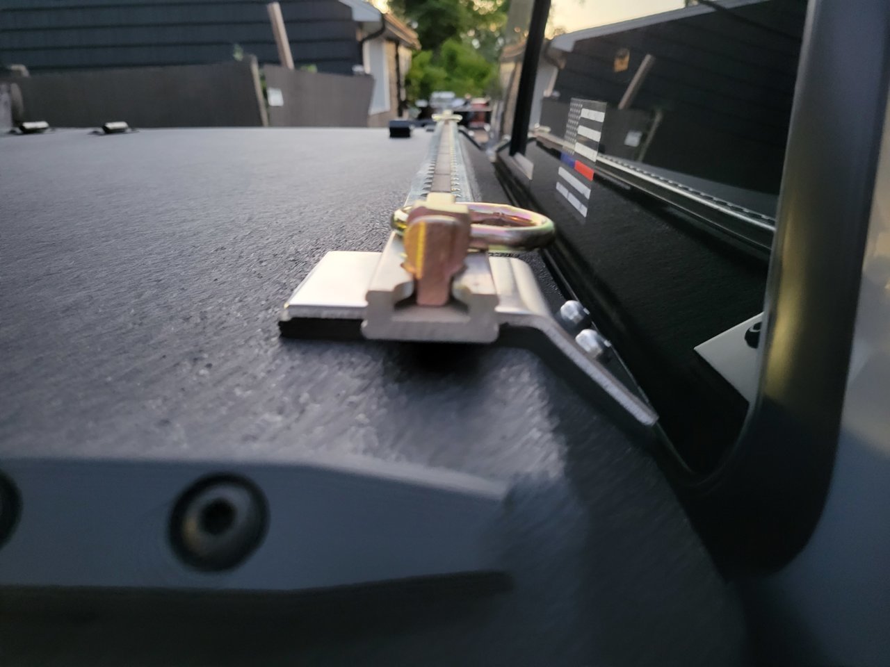

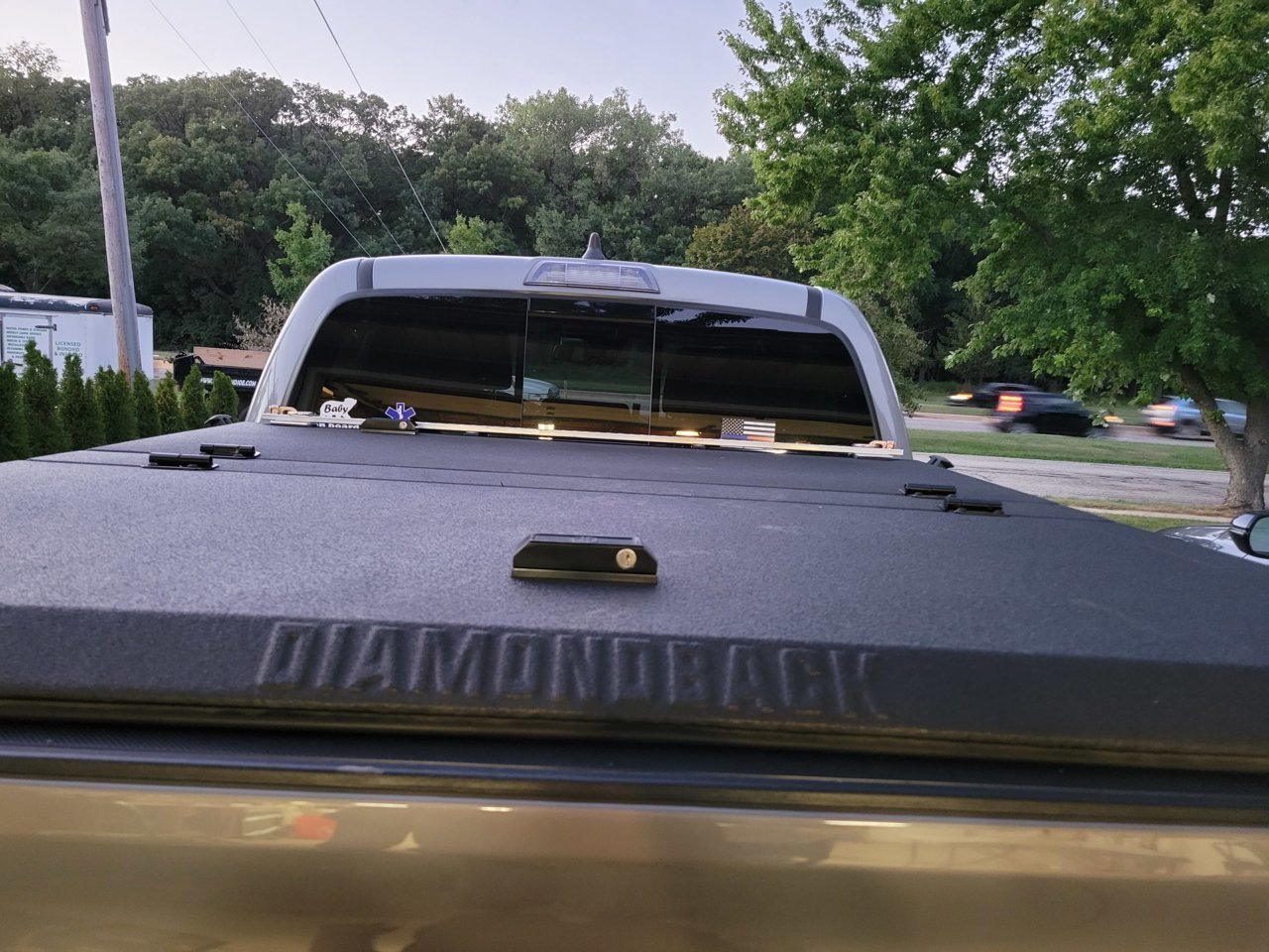

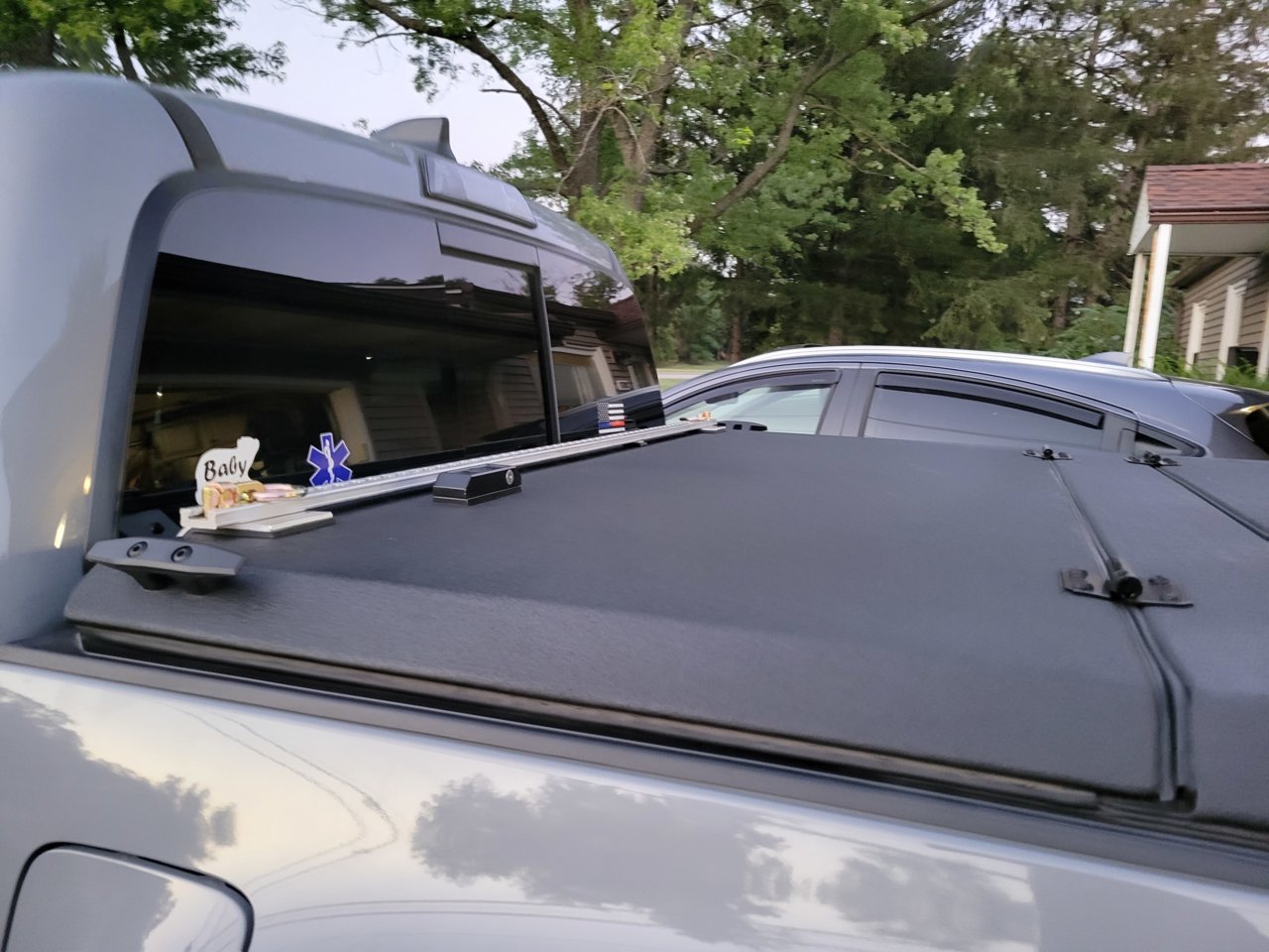

    I combined two mod's posted in this thread and made a L-Track anchor rail for extra tie down points and moveable fork mounts for a couple mountain bikes.
    Bent two pieces of 3/16 plate, bolted them to cleat locations, then added a piece of L-track across the cover.

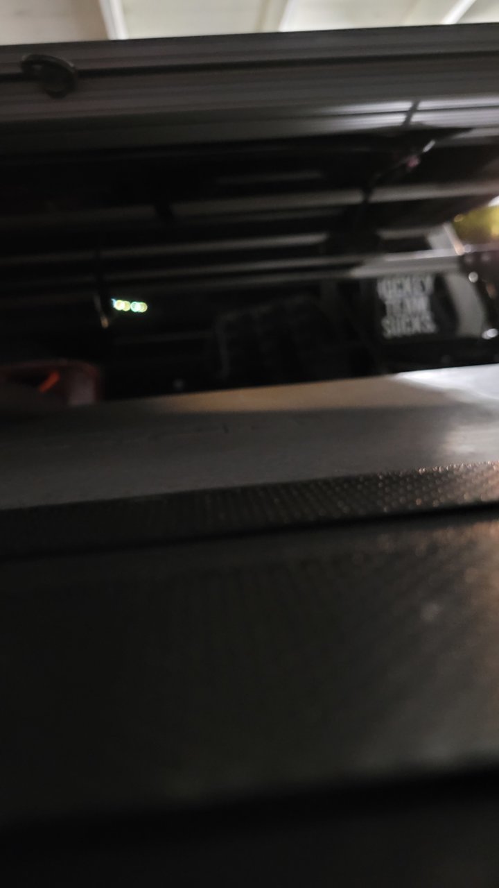

    Hey everyone. Quick question about the SE for short bed. I've got a cooler that sits about half an inch below the top of tailgate. Would there be any issues with clearance when the lid is closed?
    I also have a Jerry can that sticks about an inch above the bed rails at the front of the bed. It seems like if this were to fit between the end of the cover and the cross bar it may fit. Is there anyone that could confirm?

    As long as the cooler is not blocking the rails, then it will allow the cover to latch. Just keep in mind that the way it latches is by using bars that hang below the cover, so having it that close may not fit.
    Best bet is to get dimensions for the cooler to see if anyone can confirm fitment. As for the Jerry can, you would need measurements as well. I can't help you with the Jerry can fitment since I have an HD

    i have to center my cooler in the middle of my bed so that it clears the locking rods (their highest point is the middle). I can’t push it straight in on the sides but I can slide it to the side behind the rods(I think they are only like 8 inches from the tailgate).

    That jerry can looks like it would impede the front cover from closing since I believe the SE front cover locking rods would need to sit & operate where the upper portion of the jerry can is in your picture. I use an HD, but I believe the SE’s have the same positioning for the locking rods.
