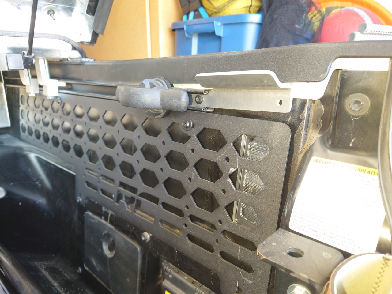

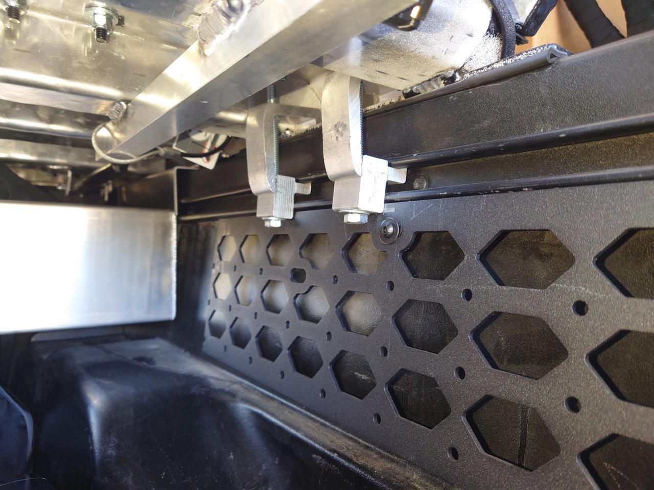

    I don't have full length MOLLE panels, but I do have the Rough Country ones (which are about 3/4 length). I can confirm that there are no conflicts between the panels and the locking bars to the rear of the cover. If the panels were full length, I would think the amount of adjustment in the front locking bars would also overcome any conflict with the mounting points of the panels in the front. The clamps end up fitting pretty tight against the panels, but they are super snug and secure. Just makes it a little more difficult to install/remove the clamps with a ratchet, since the panel is all up in your business.
    If you plan to run either of the crossbins, those will conflict with the MOLLE panels. The bins fit very snug. I actually had to cut a couple of inches off the front of my RC MOLLE panels to allow enough clearance for my 8" crossbin.

    Looks like the mounting points of that one are adjustable. In @JFanaselle image you can see the rear brackets that are installed for the rear locks. Those should not cause any issues with mounting molle panel. The front lock rods are about 4" away from front of bed. As long as you set those adjustable mounting brackets in front or behind where the rods slide into the bed rail you should be good.
