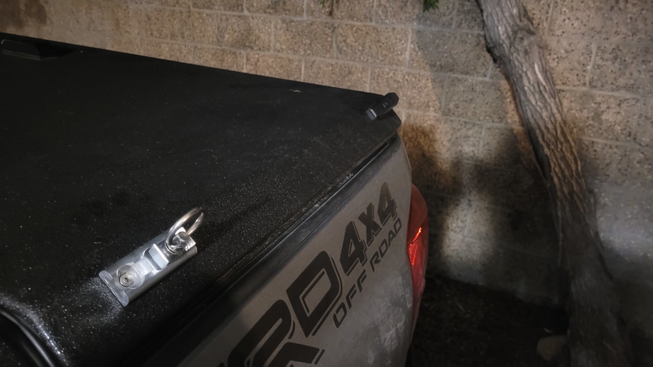

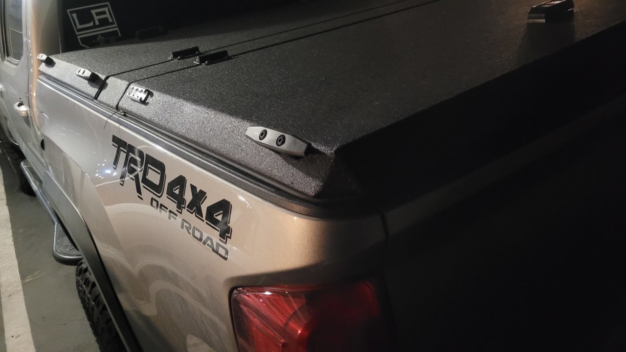

    Started replacing the cleats. First one down. 20220112_185210.jpg 20220112_185159.jpg

    What parts are those? This might be something I want to do.

    6" ltrack cut in half and hole drilled at 1.5" on center to line up with existing cleat holes.
    US Cargo Control Aluminum L Track – 6 Inch Length – Great for Securing Motorcycles, Dirt Bikes, ATVs, Garden Tractors, and More – Use On Pickup Trucks, Vans, Or Utility Trailers - 4 Pack https://www.amazon.com/dp/B07W7XQCP7?_encoding=UTF8

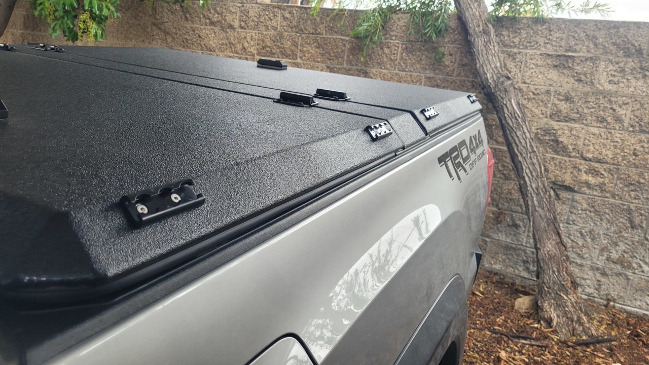

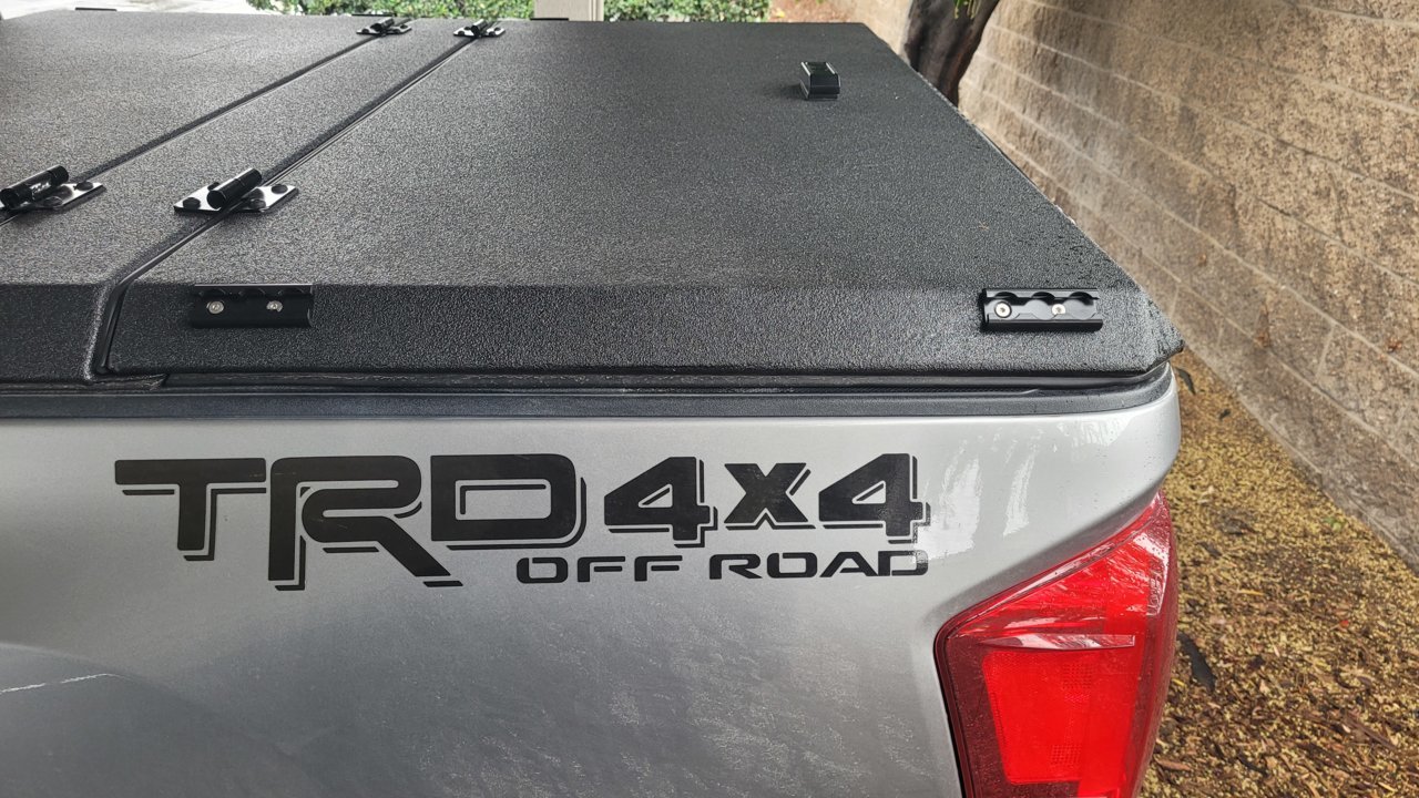

    PS anyone looking for anchor cleats?

    Actually, I am. Was considering adding 2 more sets to my DB. How much you want for them?

    Curious what the discoloration is on the near right corner of the second pic. Is that water or some small imperfection in the coating?
