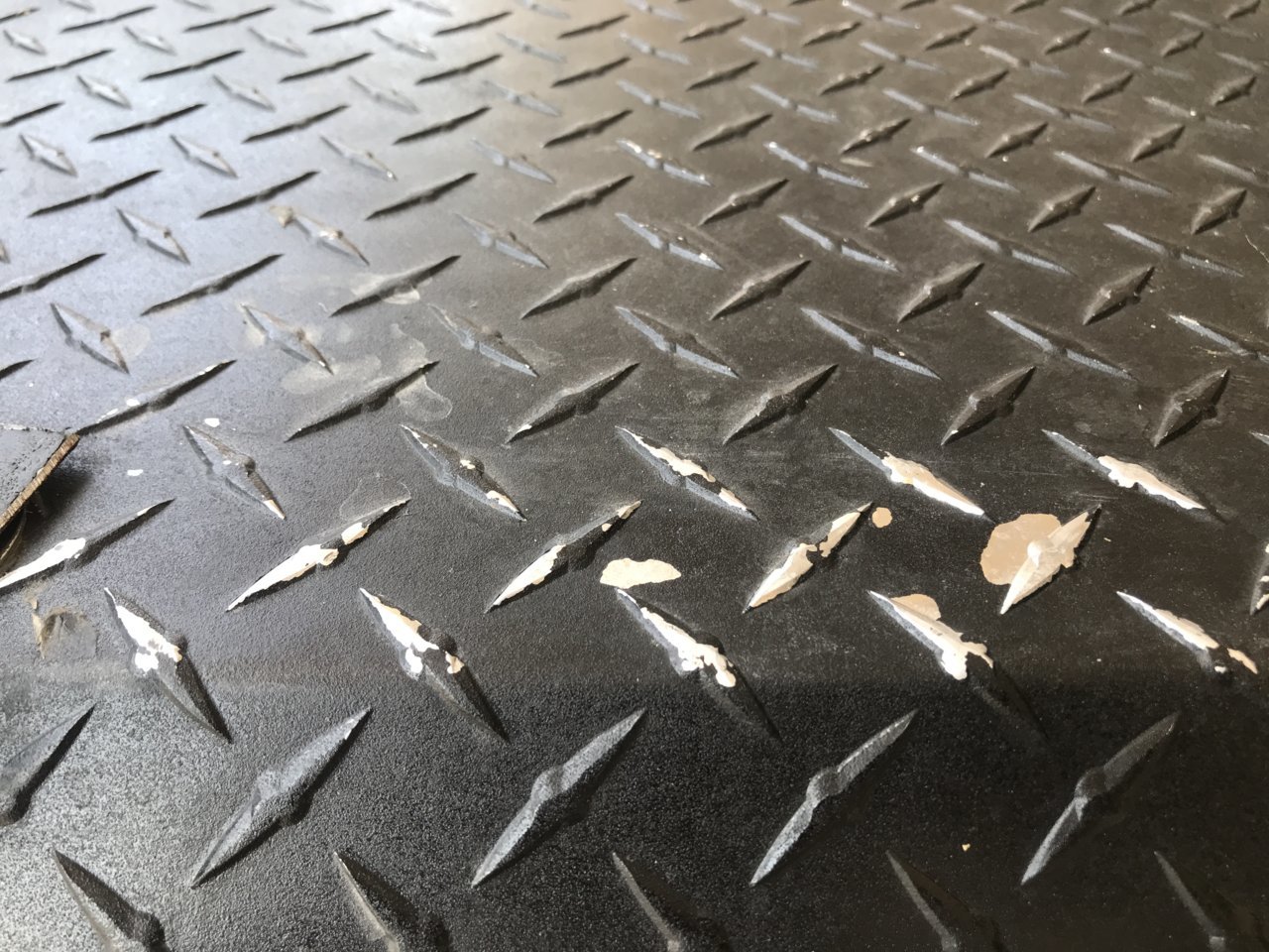

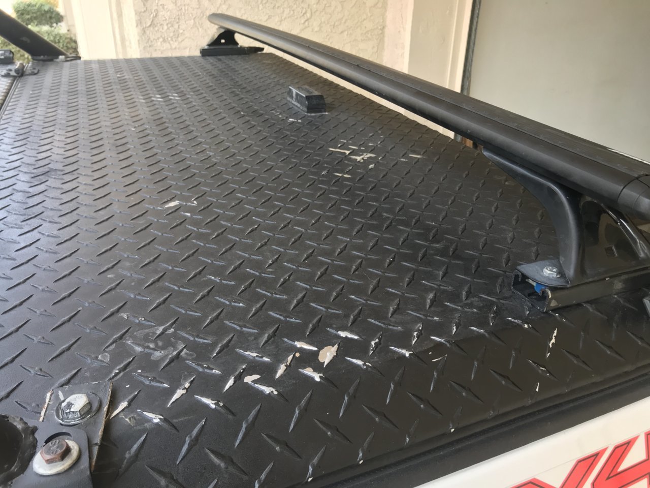

    You talking about the dark specks? I'm pretty sure those are rain drops from my rear end hanging out of carport.

    Maybe some tree sap or water from sprinklers? :notsure: Looks like there some droplets on the LR taillight and quarter panel nearest to the tailgate.

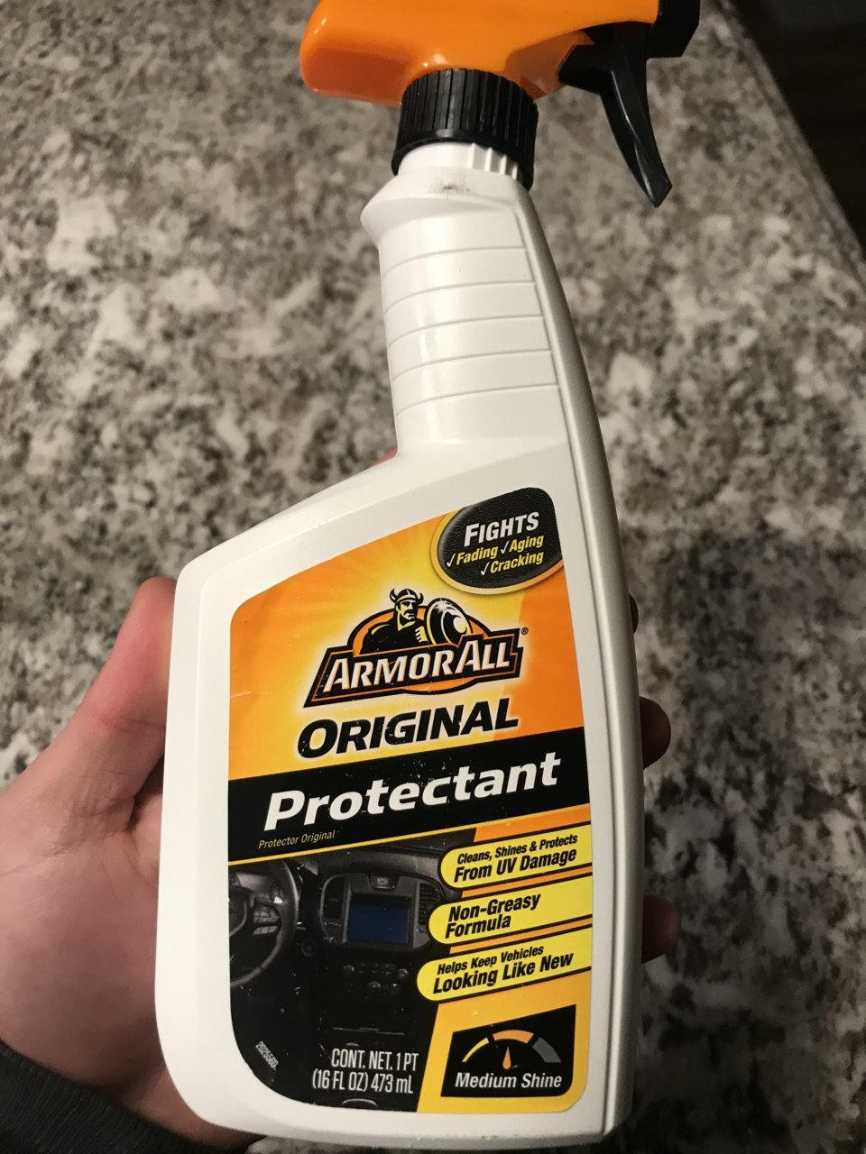

    Am I retarded or is it just too cold? I shook this stuff up and put some in a solo cup and lightly brushed the gaskets and bed rail caps with a paintbrush and it seems to have frozen. Especially the panel closest to the cab. I just put some Vaseline on the bulkhead and a bit on the bed rail caps. Wondering if that’ll do the trick but armorall doesn’t seem to be working for me

    Probably not a huge issue.
    Just toss a ceramic space heater in the bed overnight.

    I had the same issue with the gasket freezing so I applied some silicone based lubricant and really haven’t had an issue since. I figured silicone is water resistant and won’t wash away and the freezing temp is way lower than anything I would experience.

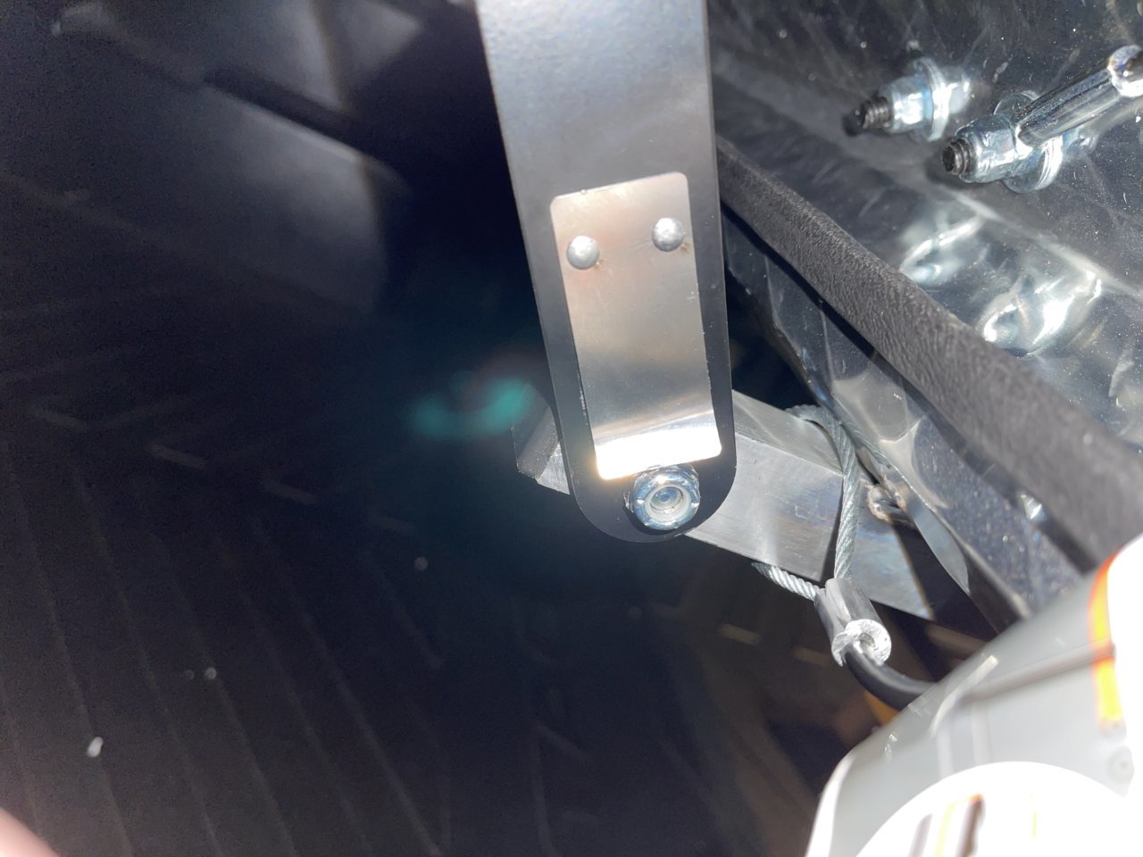

    I just received my DB today and install went smoothly until safety catch. I closed the cab end and when it went to close it it was a little rough and I tried opening it and it caught. But the little piece of metal that goes over the bolt is bent. Now when I close it and open it, the catch doesn’t even catch at all. Any one have any suggestions?

    That flat piece of metal should sit behind the bolt if I remember correctly. I can check in the morning and snap a pic.
    Edit: Just revisited the install instructions. You may have to try and flip the panel fully open then attempt to bend that bit of metal back to its original state. It should sit flat and behind the bolt.

    I did do that. I have to try to bend the metal back into place somehow. When I open the cab side panel and the safety latch catches, the latch completely falls off and then I’m able to open the panel all the way if that makes sense. Other times I can’t even get the cab panel to open all the way. I don’t know if that’s how it’s supposed to be or if something went wrong on my end with the installation.
