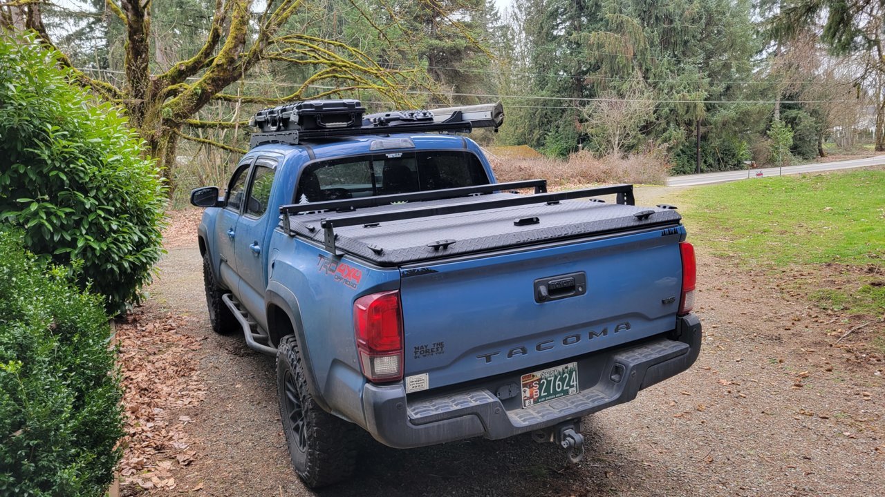

    Got my HD cover installed today! Was super easy, barely an inconvenience. I've got the Front Runner rack system on order, but still a couple weeks out. Voodoo bars are temporarily staying till then.

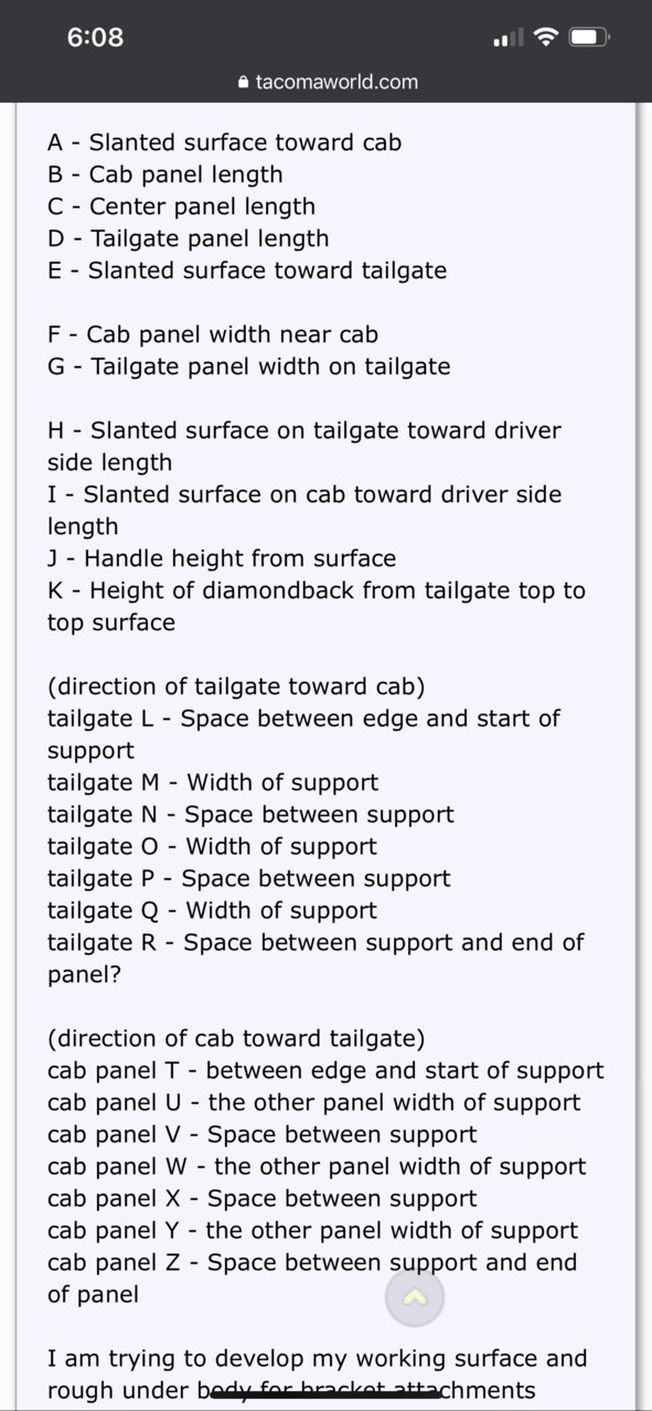

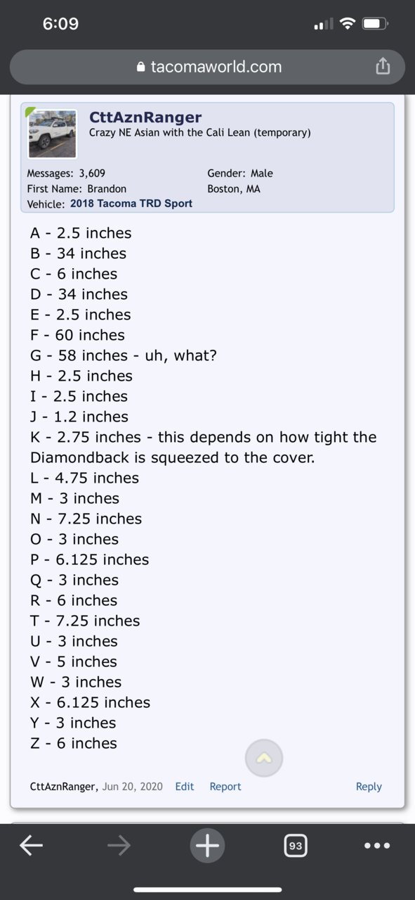

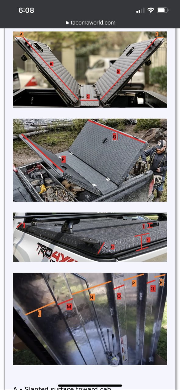

    Someone asked for some measurements a while back, here’s what they are (sorry for screen caps)

    Thanks, so it looks like the measurement I'm looking for for the Long Bed is 37 inches.

    Yup, 37” is what you want. Let me know if there’s anything else you need.

    I think that covers it. Thanks! I'm trying to figure out if I can make the taller DB Front Runner rack work with my whitewater kayaks standing on their sides. My hope is the bows will be high enough to clear the back of the cab. For structural strength, I think the front bar needs to be in the middle section (C), and then the back bar probably close to the end of the cover (D). the 58" Front Runner rack will hold about 4 whitewater boats (200ish lbs).

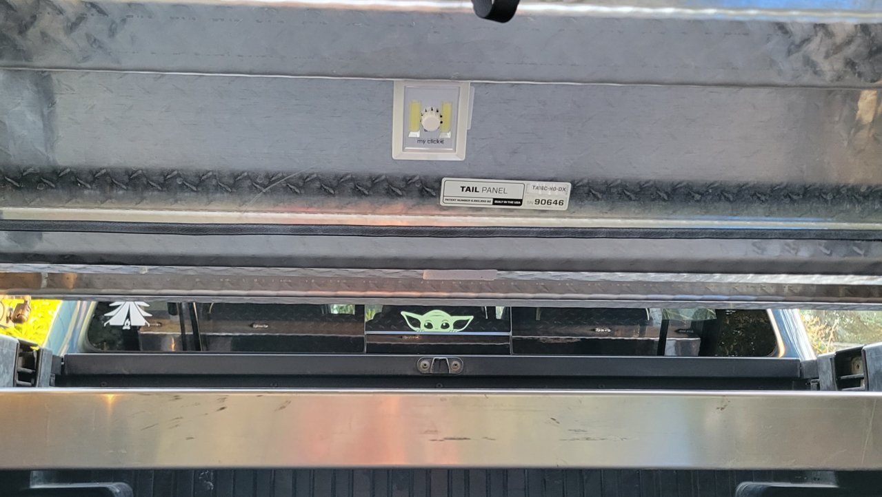

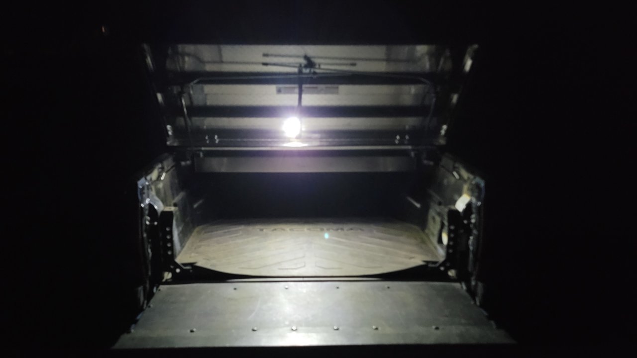

    Since this is about mods..

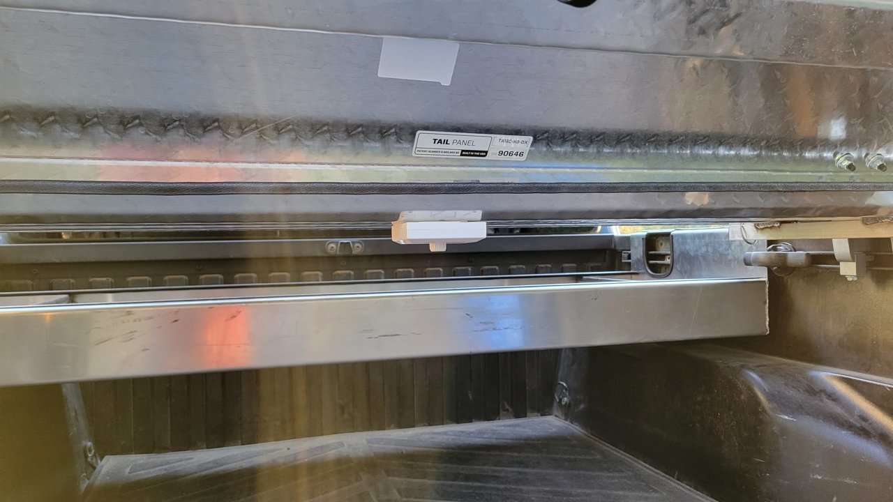

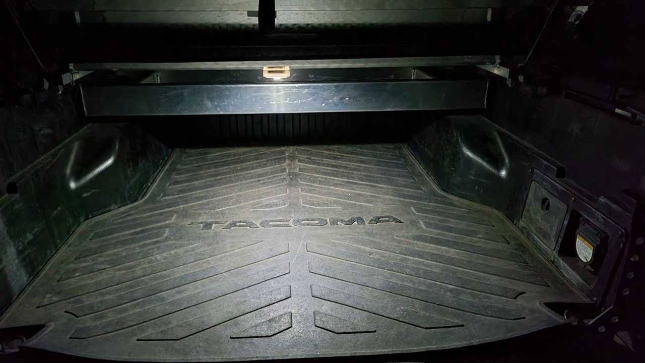

    Added a light inside. Used velcro to mount it. Made 2 locations for the light to be attached. Works great!

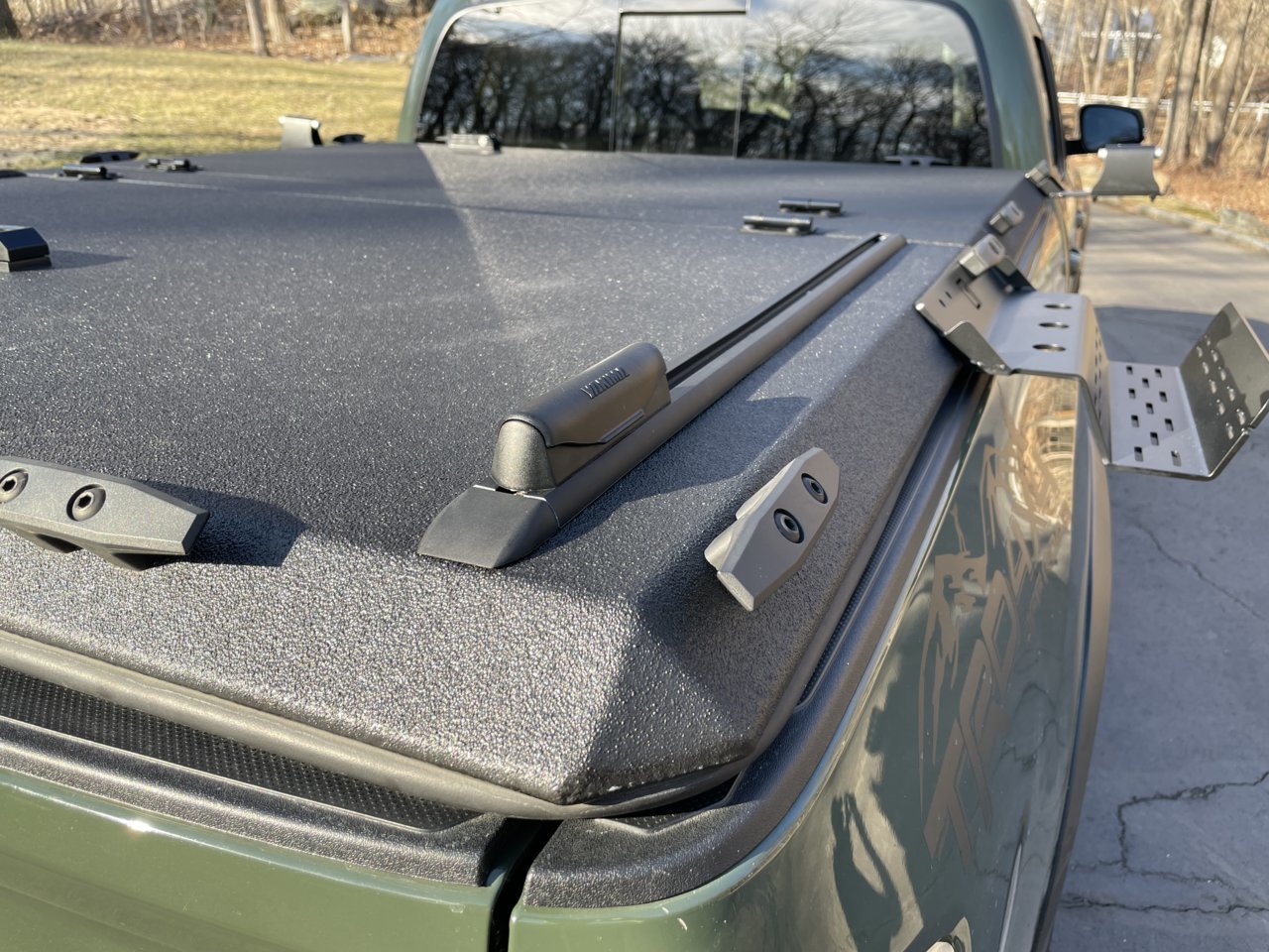

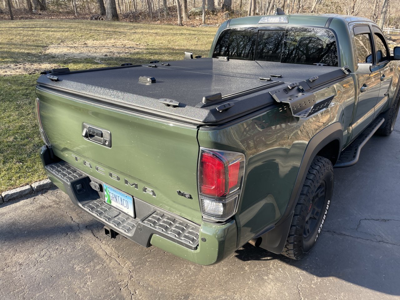

    Finally, after a year of waiting and Yakima and Thule tracks being out of stock… I’ve started installing the rack as per @xkyo23’s write up. Only managed to get one side done, gotta wait for another nice day to come along:

    Nice! looking nice and clean!
    I like the Bike bike mounts. @Nimble9 are those a new design?

    It's actually an idea @woodlandtaco approached me with, and I designed and manufactured :)
