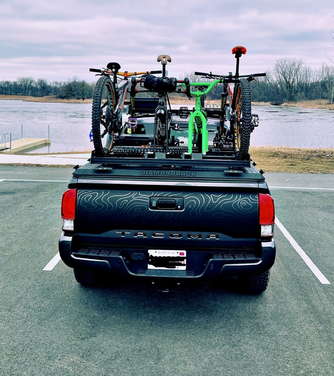

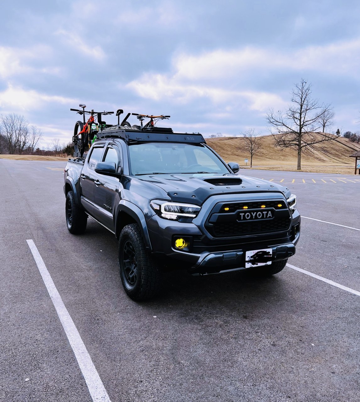

    Nothing crazy!
    Thank you!
    I used my Uptop cap roof rack. I mounted it upside down and cut it in half, so I'm able to open both sides of the cover.
    Not my picture:
    I bought these from Amazon and Prinsu to mount the rack:
    Amazon.com: US Cargo Control L Track Double Lug Threaded Stud Fitting - Use with L Track Rails in Your Truck Or Trailer to Create Heavy-Duty Bolt Down Anchor Points - Working Load Limit of 1,833 Pounds - 10 Pack : Automotive
    Amazon.com: US Cargo Control Black L Track – 24 Inch Length – Perfect for Securing Motorcycles, Dirt Bikes, ATVs, Utility Tractors, and More – Use On Pickup Trucks, Vans, Or Utility Trailers - 4 Pack : Automotive
    Amazon.com: US Cargo Control Airline-Style Track Fastener Pack - Package of 10 Sets of Bolts, Nuts, and Washers - Quickly Install and Secure L Track Tie Down Systems to Your Pickup Truck, Van, Or Trailer : Automotive
    I used lockable bolts from Home Depot for the bolts.
    Two sets of Prinsu tent mounting feet:
    Prinsu 1” Tent Mounting Feet (set of 4) - Prinsu Roof Racks
    It's pretty much like a Lego set now. You can build whatever you want from there. I was very skeptical about drilling into the Diamondback, but I used really good double-sided sealant under the L tracks.
    I hope this helps a little bit.

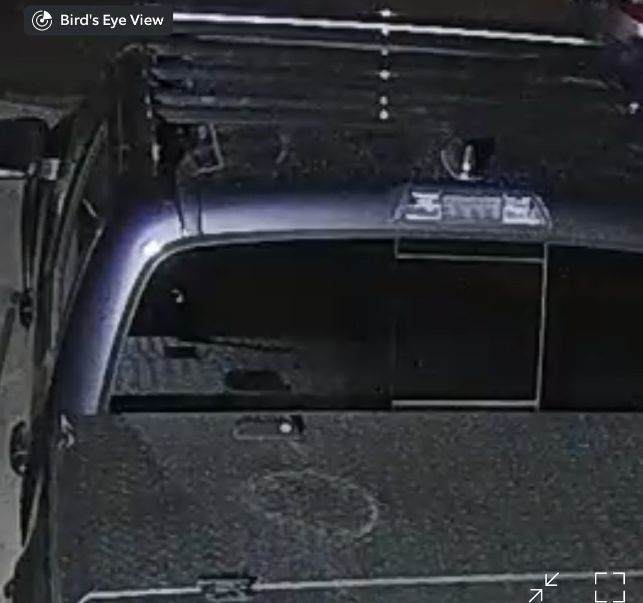

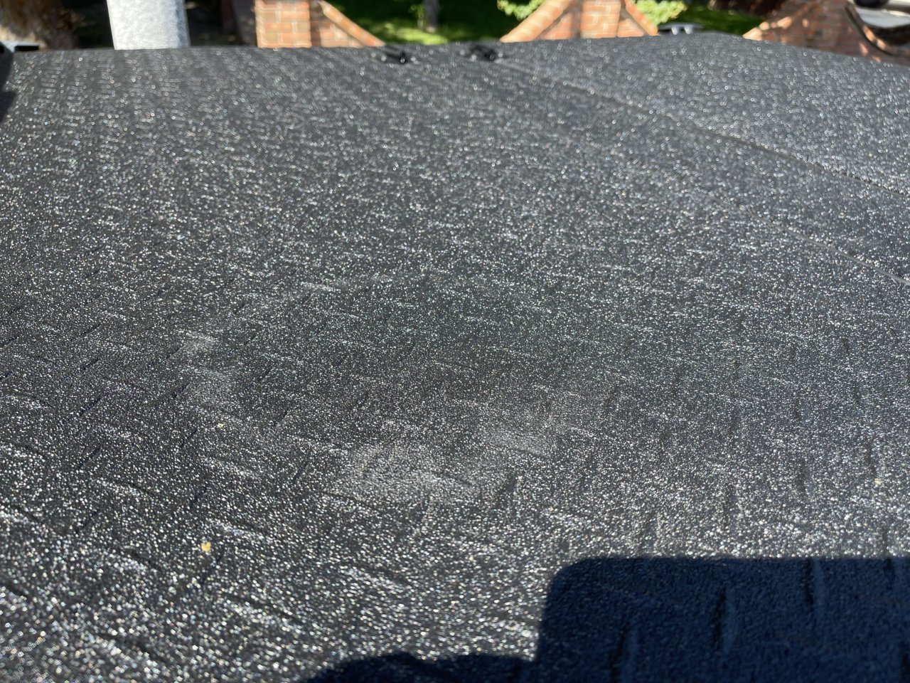

    I’ve had my DB for less than 3 months and this discolored circle (but not a perfect circle) has appeared. I hit up DB support and they suggested a bedliner conditioner. Just watched to see if anyone has had this happened before?

    Hasn’t happened to mine but diamondback sells a touch up black paint which is what I’d put over that. You’ll not be able to tell it dries like the bed color / texture. It’s like $3.50 for 2 bottles

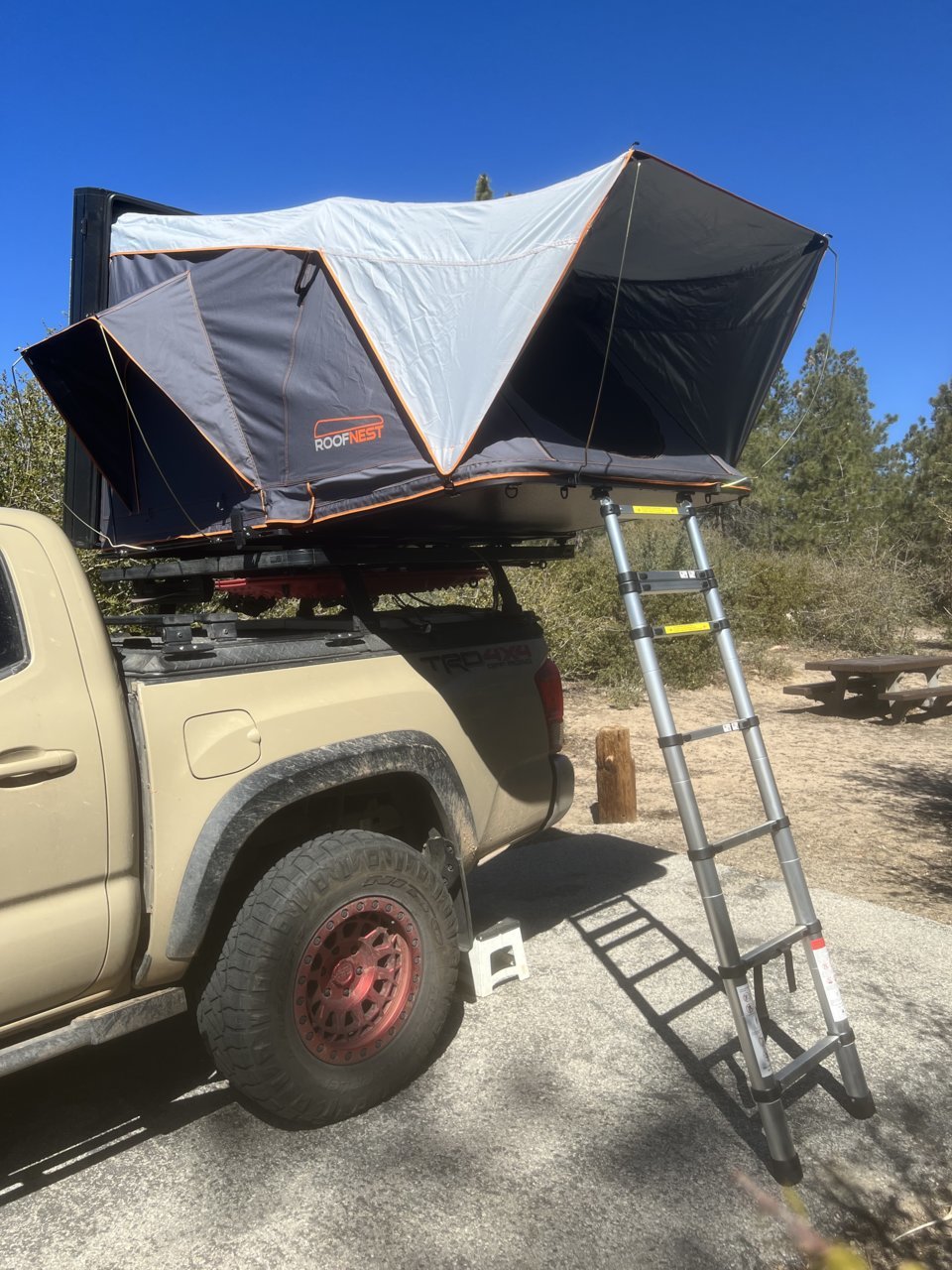

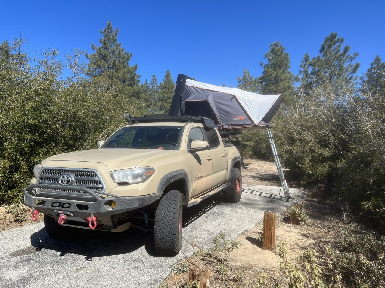

    Finally got to try out this Roofnest Condor Overland recently at one of our local mountains. It’s like those IKamper mini style tents, but with an aluminum shell. A bit heavier, but roomier than the Tepui Ayer II we previously used.

    Someone asked for a picture of the cover opened with bikes on it. Here it is. I removed the back rack since I only needed to carry two bikes.

    Have you tried washing it with automotive soap and scrubbing it with a stiff tire or wheel brush? I had a few little spots like that on mine and I scrubbed em away with my tire brush/scrubber. Gone for good. Hopefully that works for ya.
