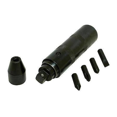

    If you don’t have an impact gun, I’ve had luck with these…

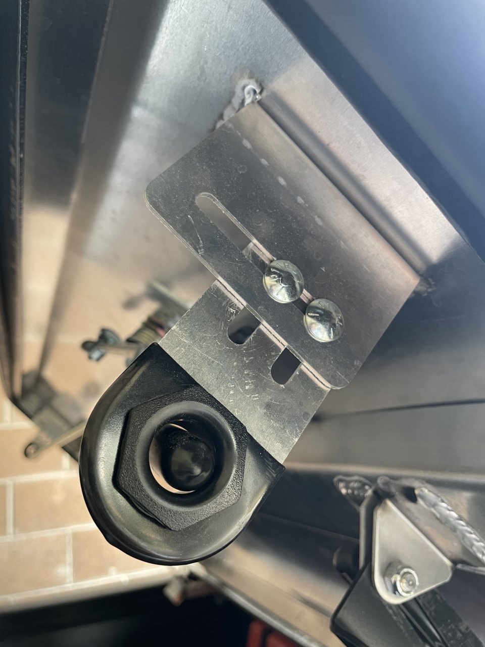

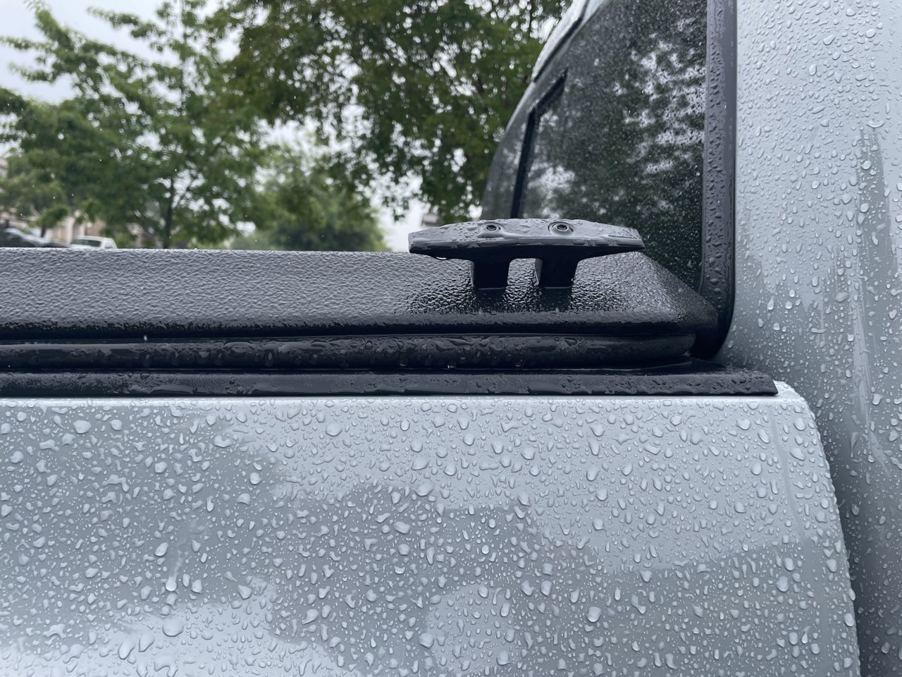

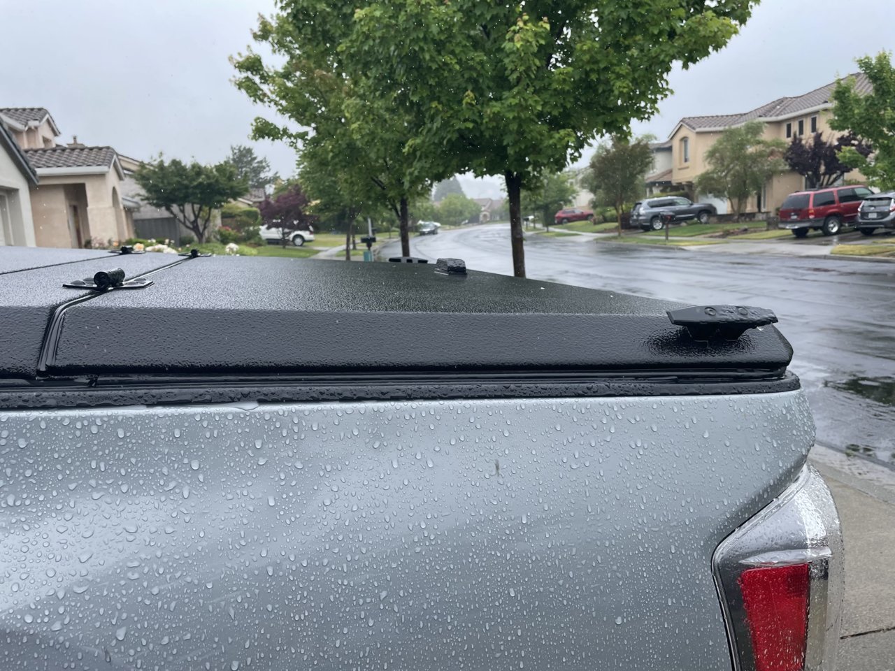

    Anybody have any tips to get the front panel seal to fit better? Pics attached, you can see the rear panel fits nice and smooth but the front panel doesn't sit as well.

    Put some weights on the front panel and get under the cover with a ratchet to make the adjustments to the locking bars...You’ll have to move the adjuster up/down to get the proper fit. I’d recommend a sharpie to make a line and follow that going forward

    You're talking about adjusting the locking bars with these *deez nuts* (sry) right? I had trouble with these since you don't get much room to operate as the locking bar has to fit into the bed rail track, whereas the rear panel locking bars has that extended metal part DB gives you. Sounds I need a buddy to stand up there while I try adjusting them again.

    Correct those are the adjustment bars I’m talking about. Definitely have someone stand or sit on it while you fine tune the adjustments

    When i shut my front side, I have to give it a good shove down while i lock it to set the rods in place. I had my partner sit on it while i tightened it down and that was perfect.

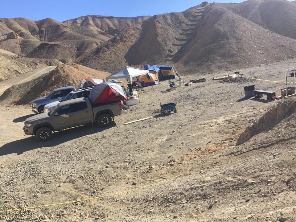

    Prior to having a bedrack & rtt system, I used that method to strap a smaller Lifetime folding table to the back panel so that it created an extension of sorts to the DB cover. From there, I proceeded to set up a 2-person backpacking tent on the longer footprint of the DB cover with a table strapped to one end of it. The cleats served as good tie down points for the tent. But, I used longer guy lines w/ reflective material to stake the rain fly into the ground. Nothing fancy, but it was functional.
    Photo is courtesy of my friend during our camp and shoot trip.

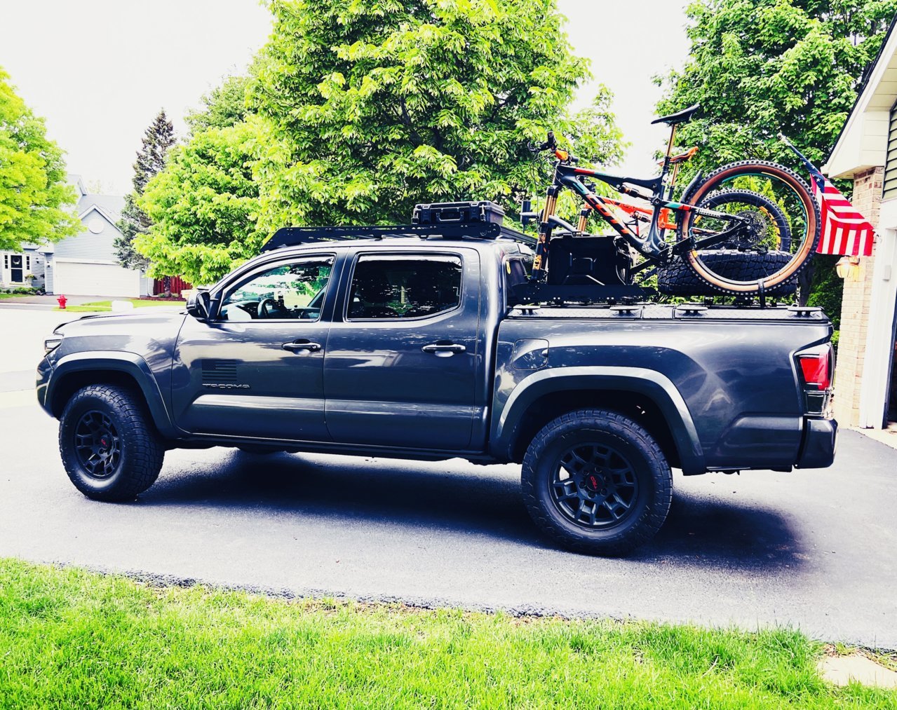

    Nothing crazy!
    Test fitting bikes, Jerrycans and boxes.
