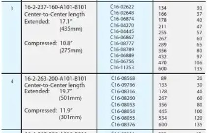

    Standard struts are 80, Heavier struts are 135. I added a Headache Rack to my cover--needed the 135's to allow the cover to open.

    Here's a snip of part number from Suspa's catalog I found in an ealier post. Hope this can help anyone.
    The stock ones are C16-08789 I believe.
