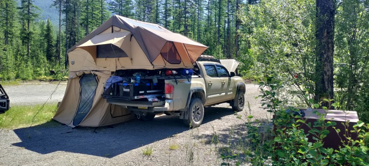

    Nothing crazy!
    Home for few nights!

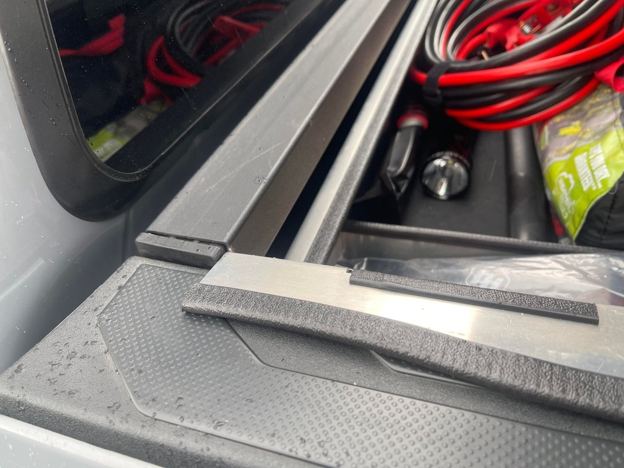

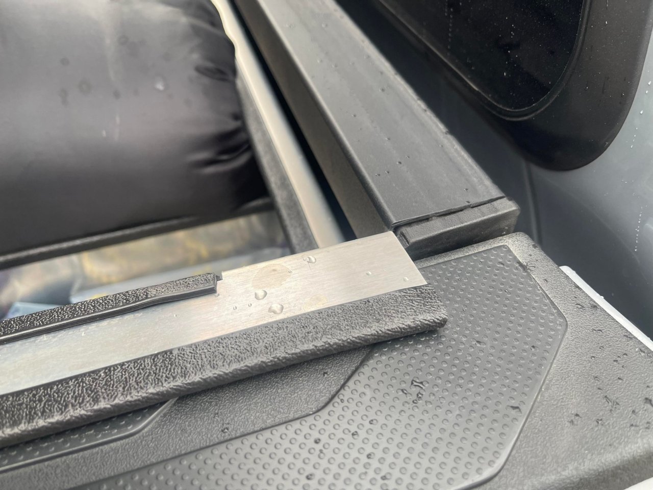

    Has anyone with a crossbin encountered the issue where the crossbin would dig into the front rail crossmember and its sill covers? I removed the tie-down hook on the front side of the bed to push the bin all the way to the front and maximize space, but it seems inevitable with the crossbin shifting while driving.
    Driver side:
    Passenger side:
    Any solutions? I don't think it's worth to replace the crossmember as the damage has been limited, but a bit disappointing nonetheless.
    Not sure if the asspensive $60 OEM rubber plugs would even help.

    I used t-nuts to bolt the bin to the side rails, & tig welded a plate to bin for extra strength to bolt it if I remember right. Solid for 2 years now.

    Get the t nuts that fit the rail. I got mine from Amazon for $30 with Allen head bolts. Drill and bolt down won't shift anymore.
    I suggest a little dab of blue (medium) strength thread lock as well as prior to using it I've had them loosen on me a little
