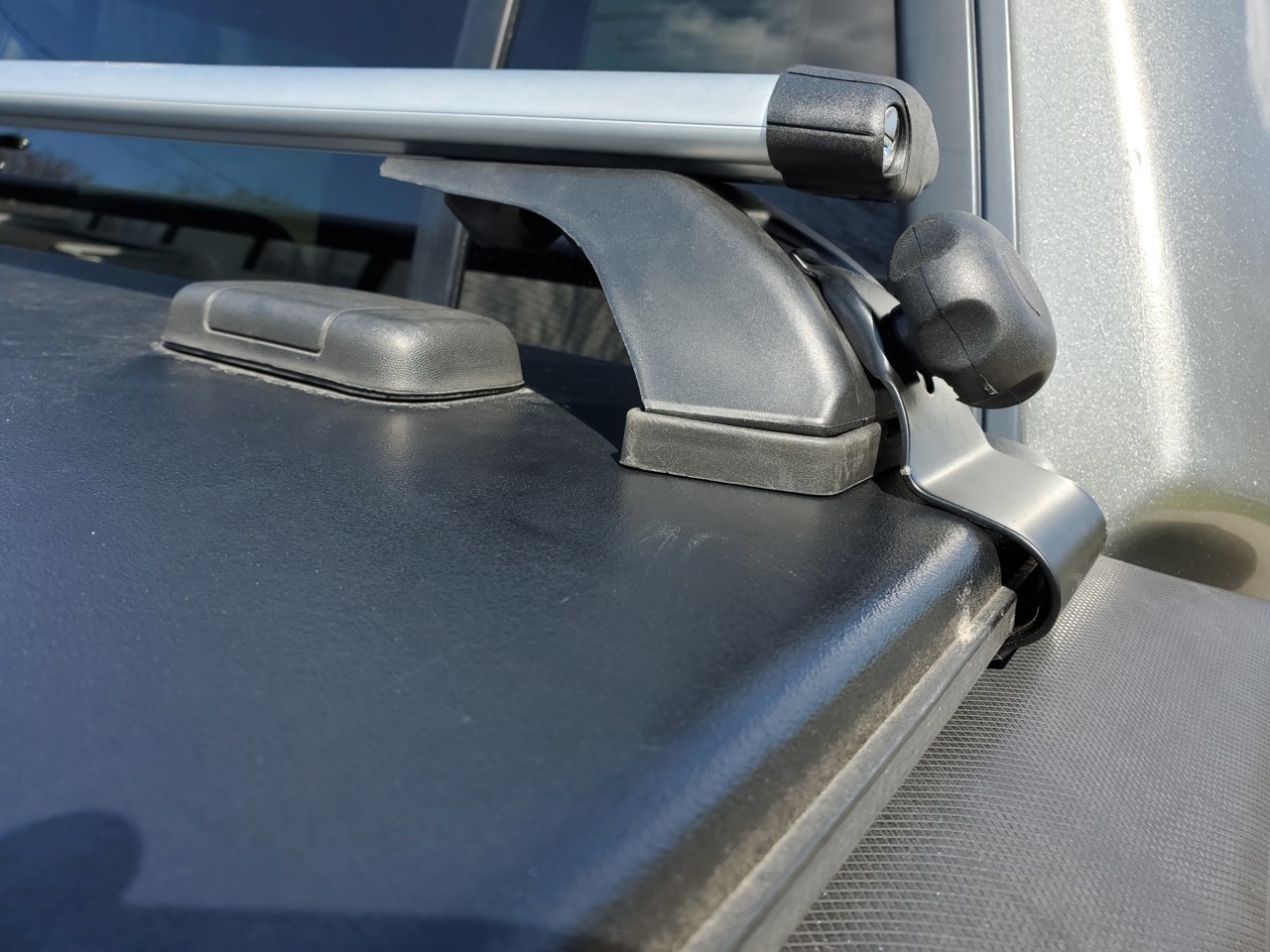

    I wish I had the cad skills to build out this rack

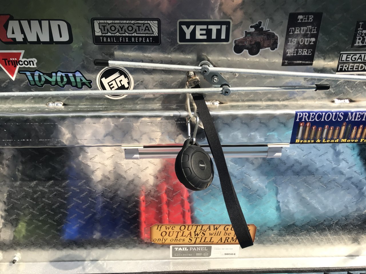

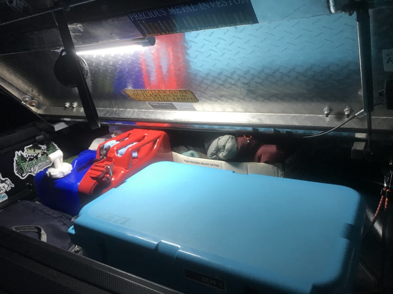

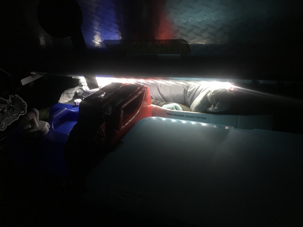

    Added the diamondback bed light (not seen in photo)...I’m not super impressed..there’s not a lot of output for how much it cost and this is coming from a diamondback fan / supporter.
    I also added a portable led light bar to the bed via magnetic adhesive. Big fan of this light. Crazy bright and 3 different settings + it’s magnetized. I’ll upload pictures tonight of the difference between the 2 lights
    https://www.homedepot.com/p/Commercial-Electric-13-5-in-LED-Portable-Task-Light-WHQ30-44/304968662
    EDIT: diamondback light vs Led Bar light.

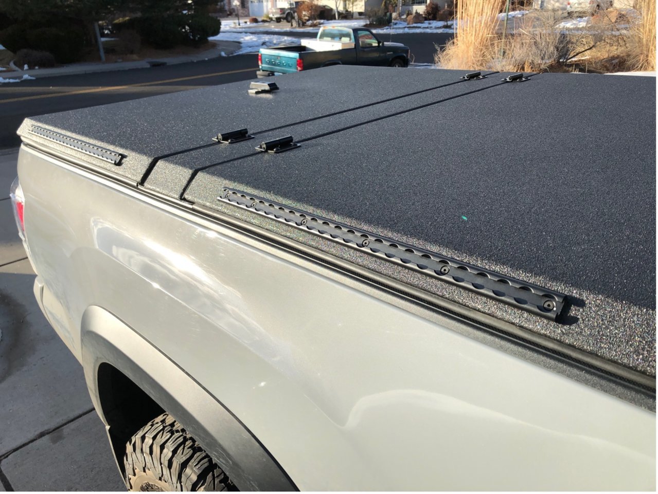

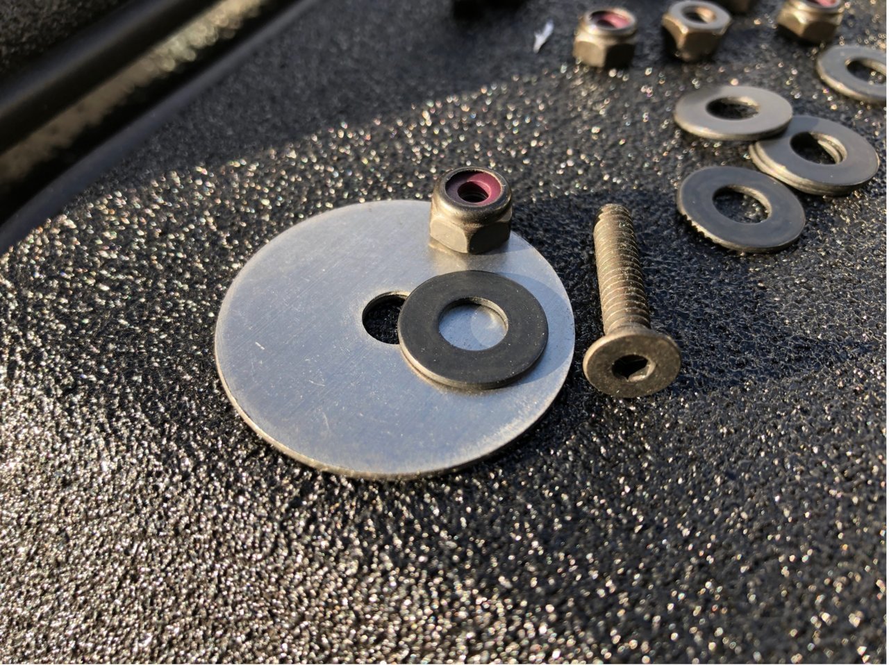

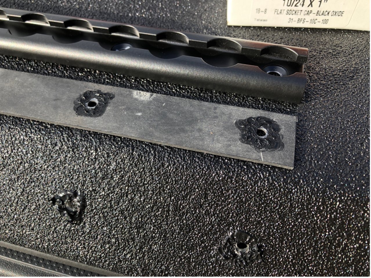

    I'm a REALLY big fan of the "L" Track. I mounted mine on the angled edges of all four sides so they wouldn't interfere with the flat area on the top. two 24" tracks on each side, and two 12" tracks on each side on the front (behind the cab) and back (over the tailgate). With the wide variety of snap-in fittings, it only takes me a minute to have places to attack ratchet straps, bolt down mounts, etc.
    I got the black anodized stainless steel hardware to attach the track to the cover from McMaster-Carr. I used a rubber seal, with RTV around the holes to keep it watertight.

    That's pretty much what I'm wanting to do
