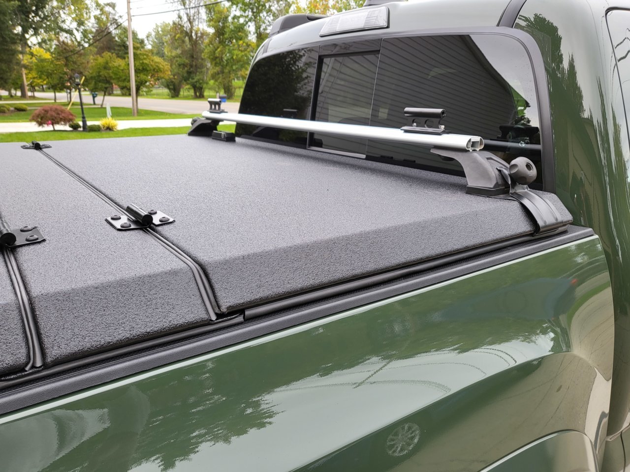

    Was able to fill the gap between the bulkhead and the bed sides with foam, and a little butyl, will tweak it once the cover seals break in. Cleat placement still being decided.
    Also was able to fit the cross bar off the old truck. Should work well for bikes for the time being. Still going to research a solution more worthy of the DB.

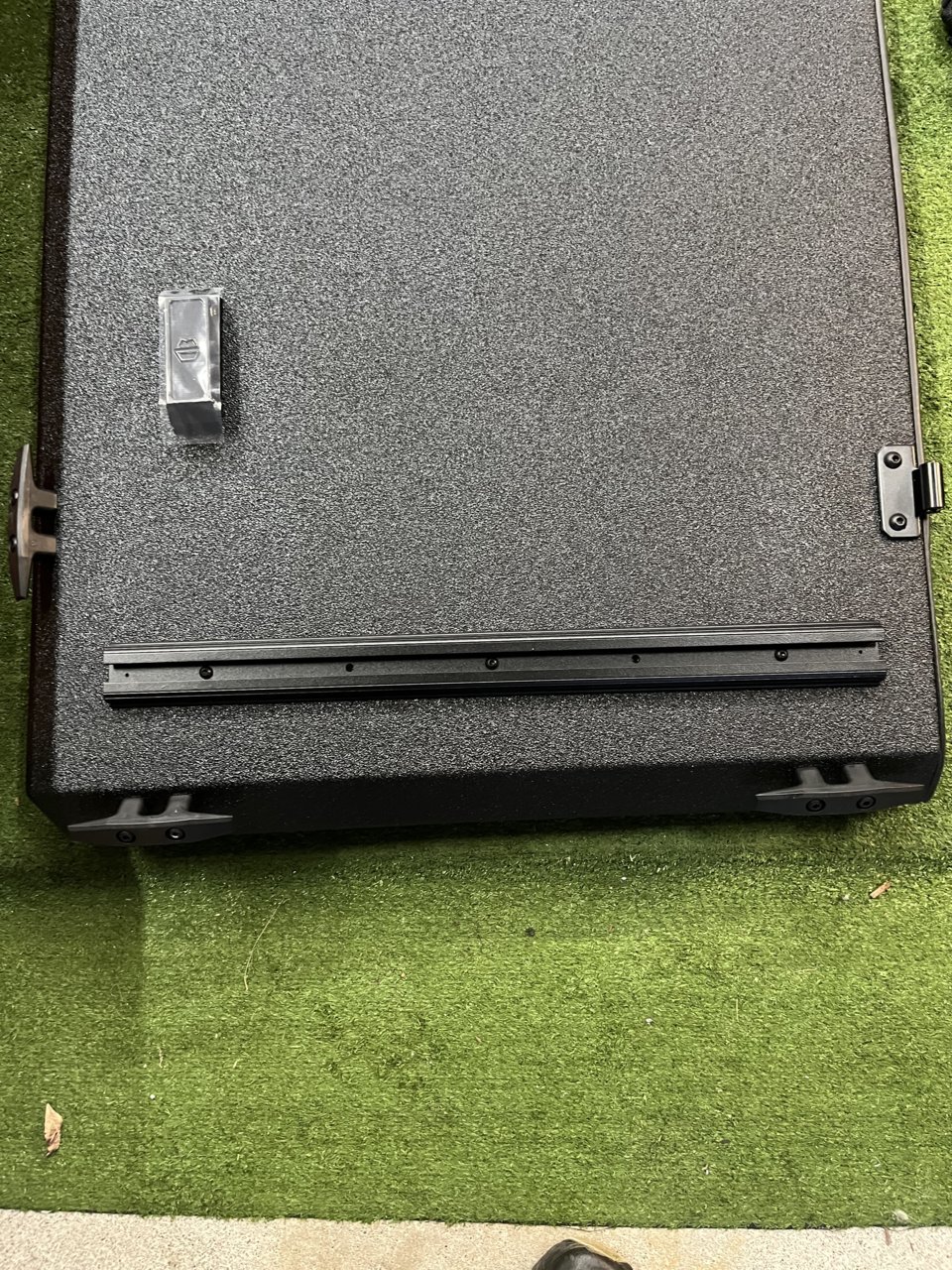

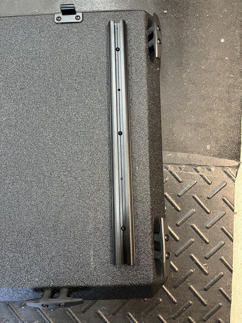

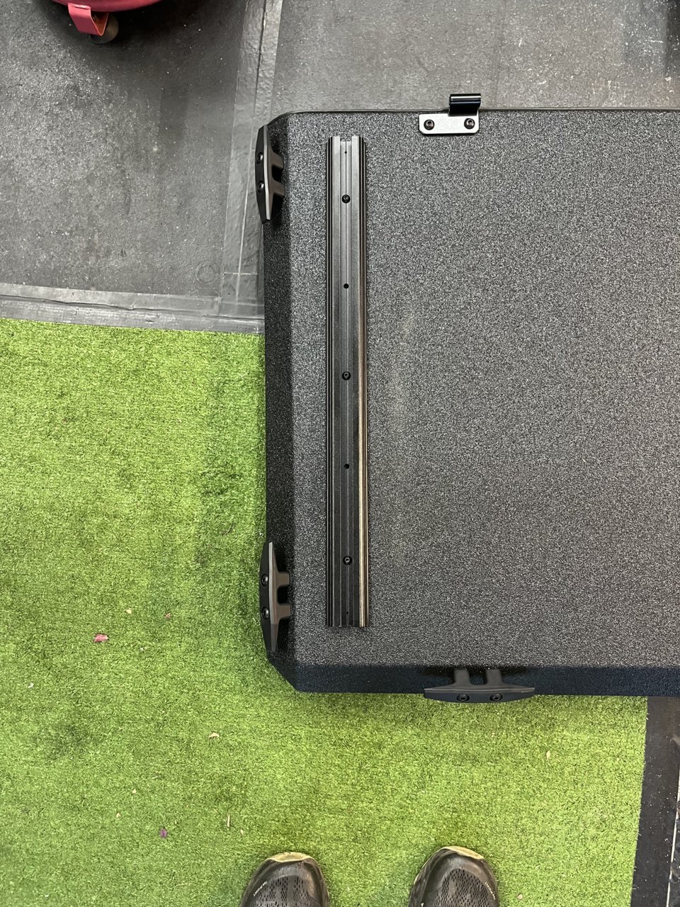

    For those with the Front runner rail system installed. What is the distance from the edge you used? I just received my HD cover from @DiamondBack Covers and it looks like from one end to the other on the rails its different distances. For example, one end might 1.5” and the other end is 2” from edge. Tried to take pictures to show. My concern would be when I actually installed the front runner bars they won’t line up evenly. Really don’t want to have to redrill as I paid to have them from the factory. Thanks

    The diamondback cover is actually tapered, so you in theory should be good.

    That would actually makes sense I haven’t lined them up together yet. I’ll take a look tomorrow. Thanks

    I would make sure your DB cover is installed when you are trying to line up the FR rails. Like the previous said, the rails taper in. The DB cover actually is a trapezoid when seen from above. However, I would try to keep the rails parallel to each other as much as you can. It will make moving racks and such less of an issue later on. Mine are slightly out of parallel and I wish i would have paid more attention to it, but I don't move my racks that often, so it isn't a huge issue I guess.
    I only have the two rear rails on now and I got the taller brackets (1-2" taller, I think). I use them to carry a roof top tent and it allows full access of the front DB leaf.
