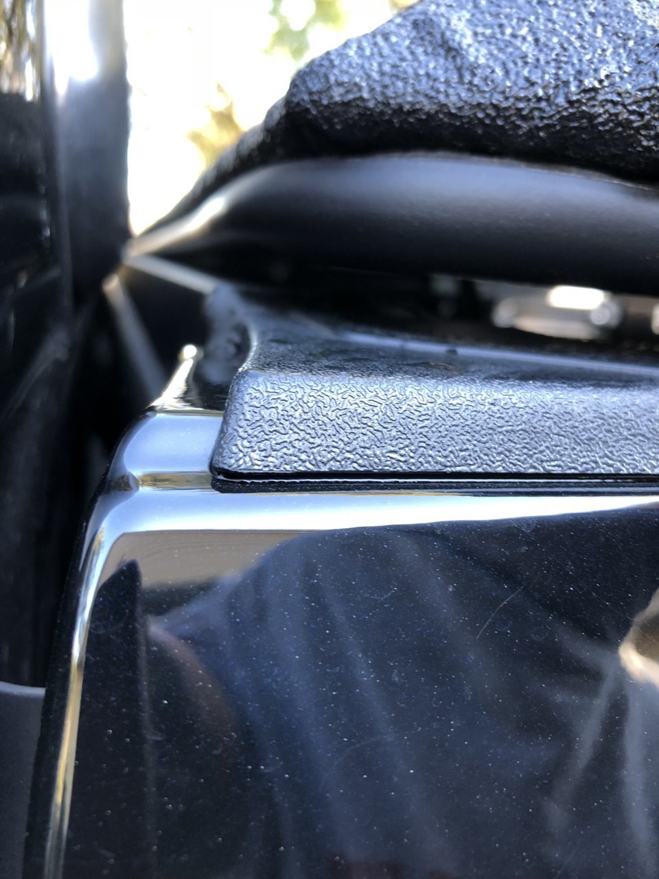

    Definitely the same idea. I guess when metal is heated & cooled it may expand/contract and come out of flat. Here is a pic of the cover resting closed but not pushed down to latch. The cover is making contact on the passenger side and about a finger width up on the drivers side. This allows you to get good compression on the passenger side without help. Like I said, I was skeptical, but it made a difference.

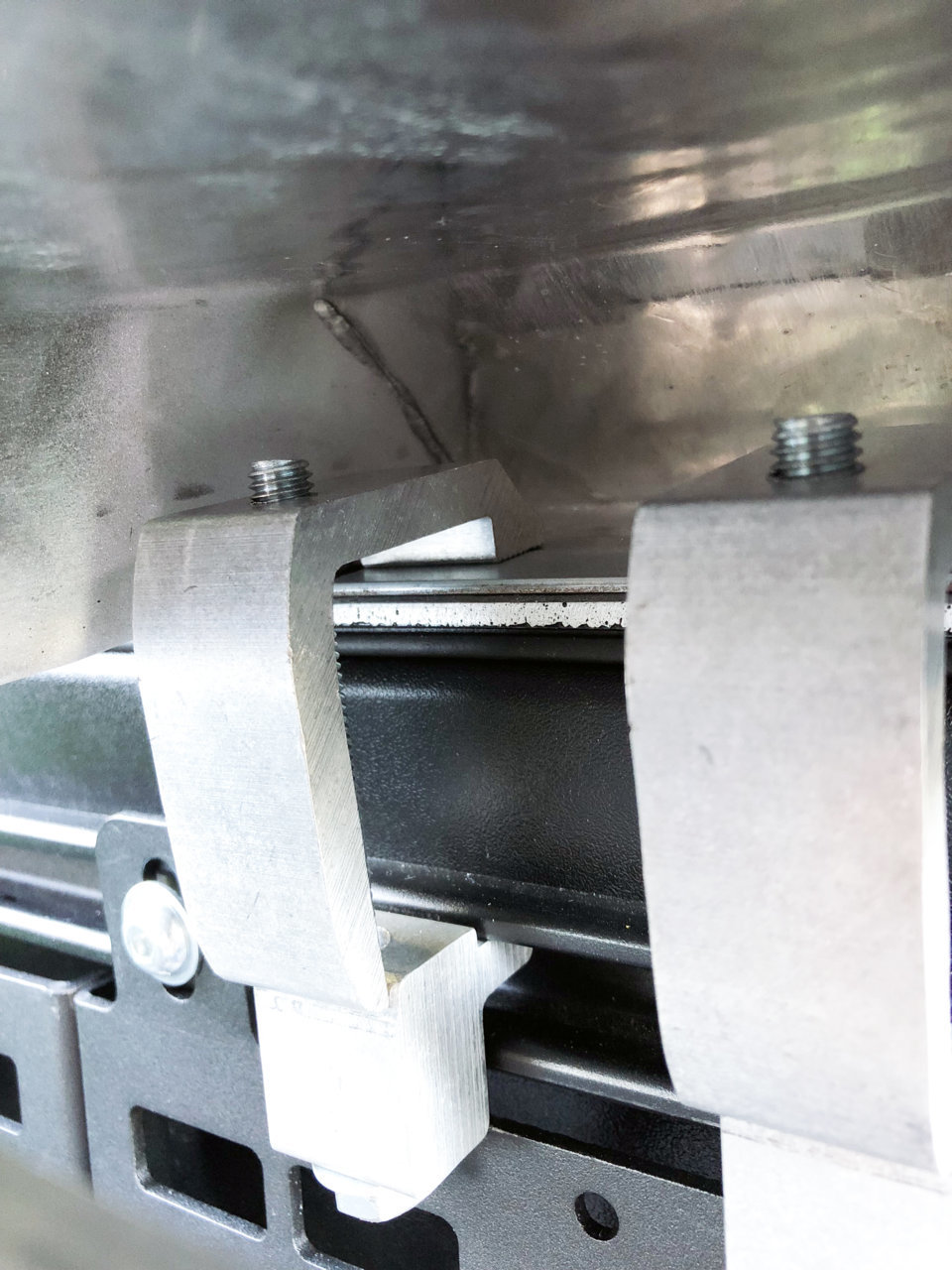

    First is that I mounted a piece of flat bar (described above) in the center panel to eliminate the "ledge" so the clamp seats flat and contacts correctly. This seems to give a more even pressure. In the pic you can kind of see that the clamp jaw spans the aluminum and the flat bar:

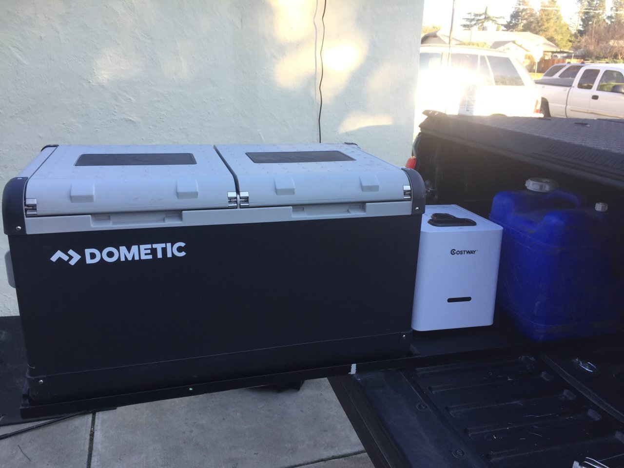

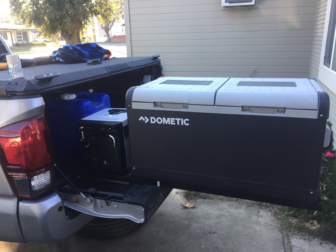

    I agree. I’ve seen the roll ups and I’m very happy with mine. Just made a DIY bedslide for one half of my truck to hold my Dometic fridge and freezer that JUST barely clears under my DB :)
    Hot water heater and water tank tooA3454BC0-2A13-4BDC-8CCC-40C86603D8D2.jpgC82D877E-3DA0-4C71-9BBB-2024A6C564C5.jpgA1E6FEF9-2A24-412A-B912-949154D7B996.jpg
    BRFab, The Pirate, Al Hoff and 8 others like this.

    Nice job. Any better picks of the clearance from the locking rods to the top of the fridge. I assume that's super close.

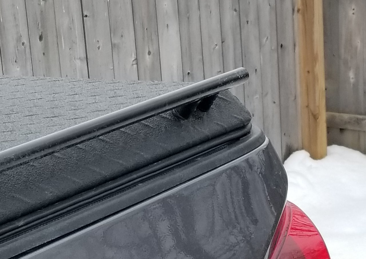

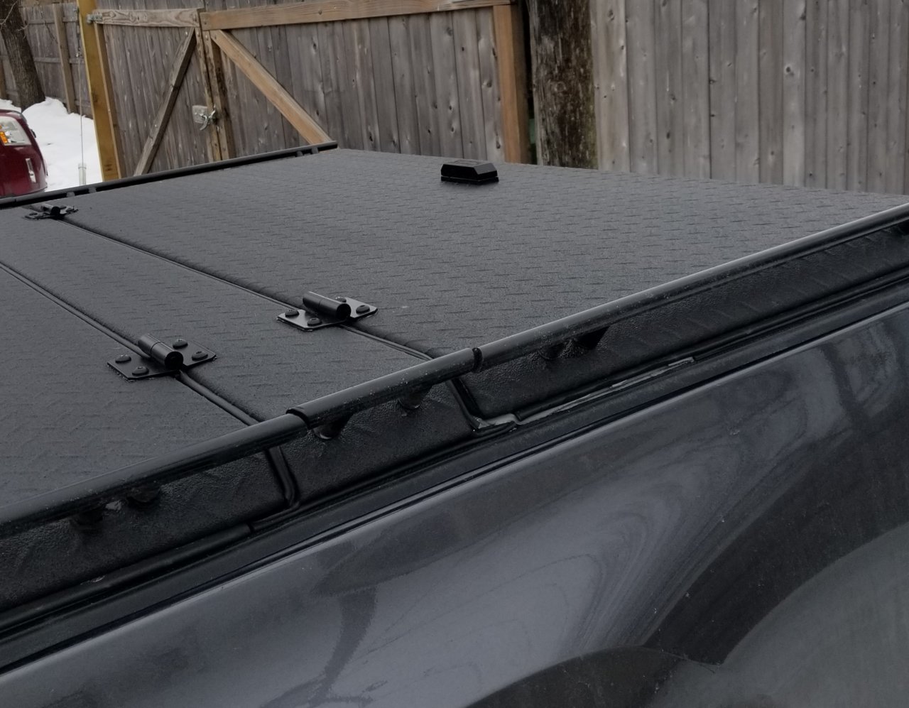

    As a mod I wanted to have tie down rails length of bed on each side. I used 3/4" aluminum rod threaded so no bolt heads exposed on outside of cover.
    This is a good option for me as i tend to haul cargo on top regularly and makes for a slight raised stop on each side along with easy tie down options. Sending the rods and spacers out for powdercoating next week.

    Don’t have a photo but yeah very close

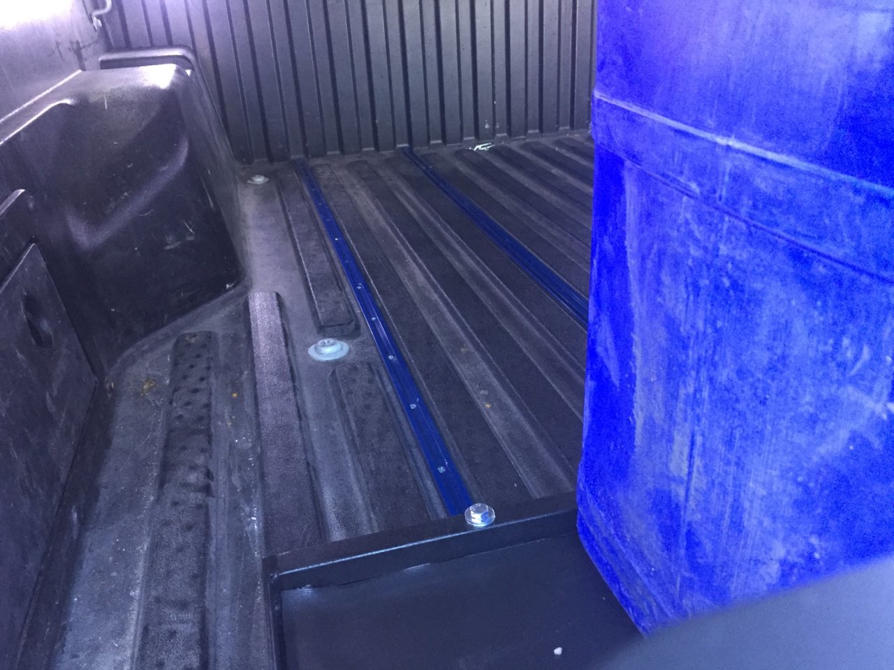

    The slide works well enough as designed to easily pull out items from the left side of my bed. I will say it isn’t perfect but makes it easier for sure. I built a basic frame using angle iron from Home Depot, with 3/4” square tube crossbars. I got a guy to weld them and I added a sheet of 5/16” aluminum to the bottom with rivets. To keep the slide from tipping out when extended I used 2 C channel slides that are often used for guides on table saws. So the end of the slide it has 2 T nuts that anchor it down and the C channels are bolted through the bed. Works great for what it is, an anchored drawer that slides on the bed and tailgate.
    My build is to convert from off road to DD so I made this to pull out and my bedmat goes back in over the C channels like they aren’t there2D28680E-A520-4249-81C0-60E66F6D577B.jpg092A47FA-BB21-4838-B5B1-69BA07559289.jpg

    Dude, this is exactly what I’ve been looking for! Which dometic fridge do you have? I want to pull up the dimensions to see which other models will work with this cover.
    Edit: never mind. I found your post on page 3 of this thread. This is good to know since I’m thinking of getting a CFX 50.
