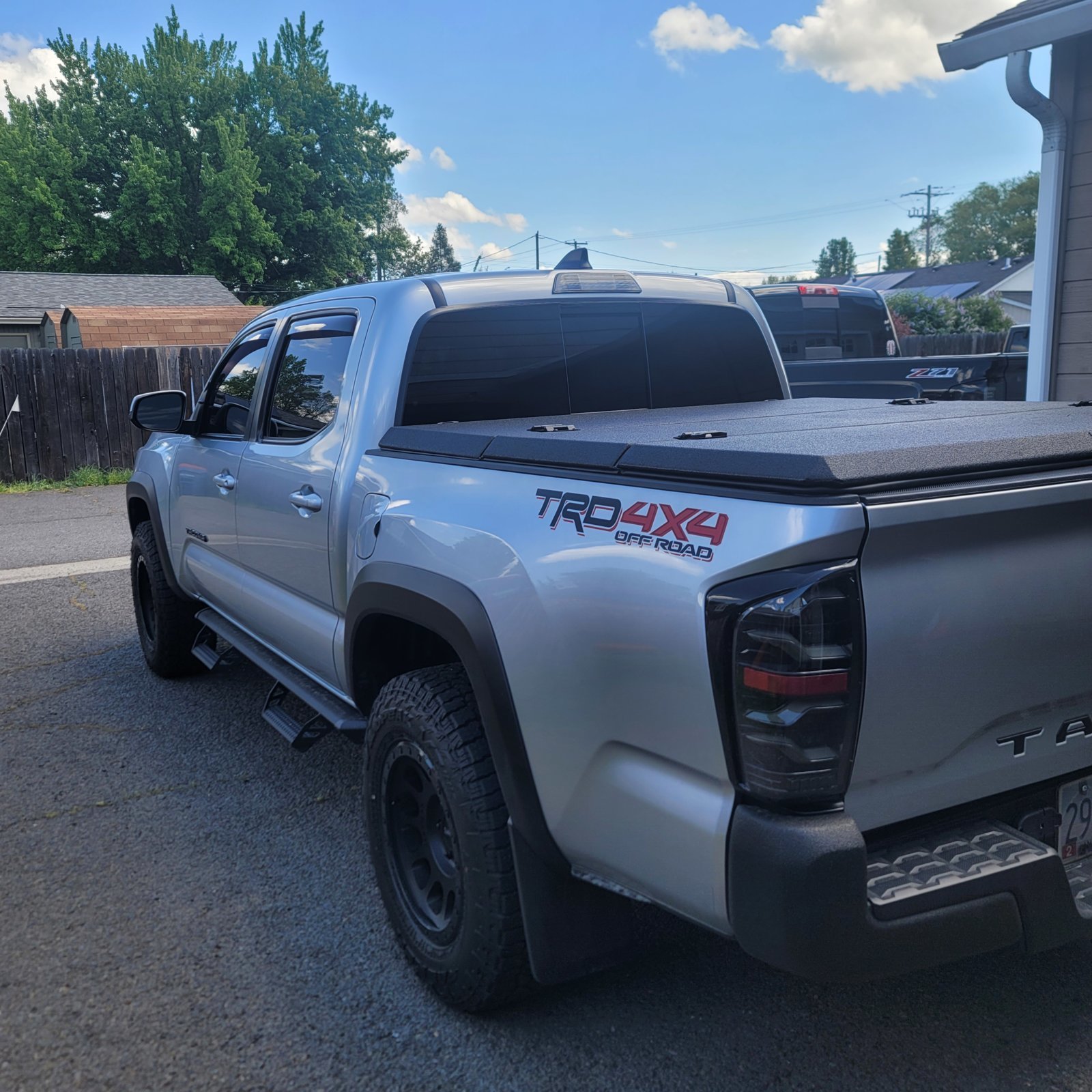

    I like it, I love it and it bad ass looking, I did have a problem with the strikers and clamps not locking or engaging with the striker plates LOL, so I tried again the next day and come to find out I had to give the handle a twist and it slide right under the striker lol and it Lock in place. Not sure why this cover only has a 4.6 star ratting with over 100 reviews its defiantly needs a 5 star rating Love the cover @DiamondBack Covers :bananadance:

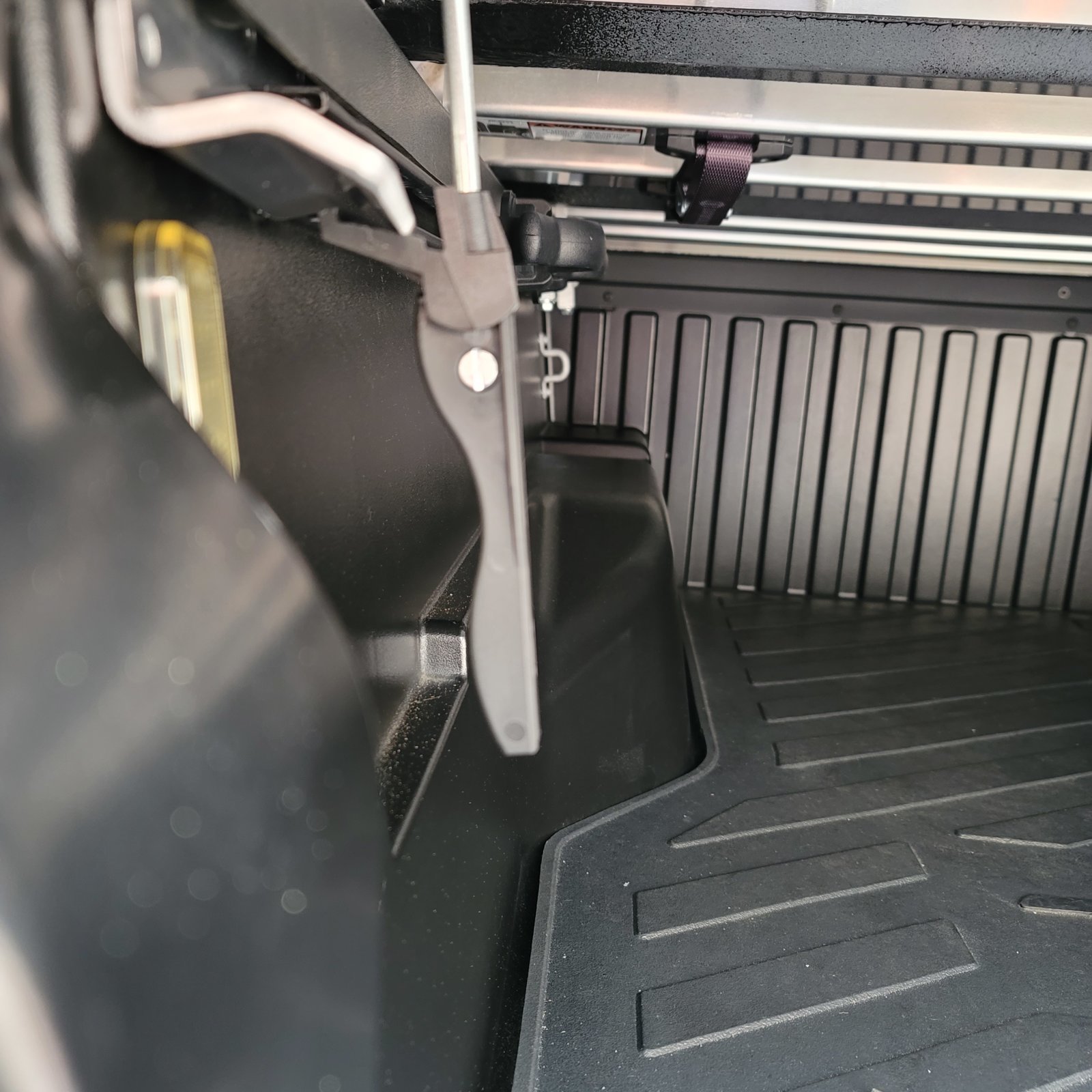

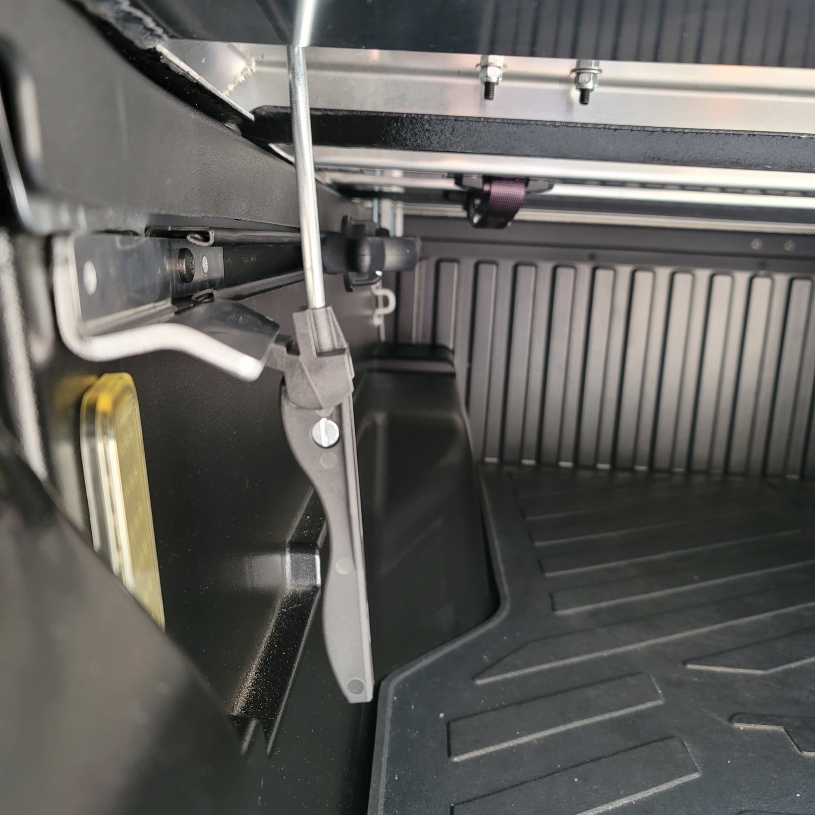

    I torque them to 4.5 ft lbs 5 ftlb seems to much. As for the U bolts I think I'll definitely pass on that, cause it seems like it would definitely start messing up that the gasket on the tailgate since it would be a lil tighter. This is what it looks like.
    I did call them today and talk to them, they have 3 sizes in the rods and I already have the longest size. After I figure out how to lock it in place I gave them another call. I also ask for some bulk head sealant , it's what they sent if you have a Tundra it's like a black putty type so I can get it in in the spot that stills shows light ...

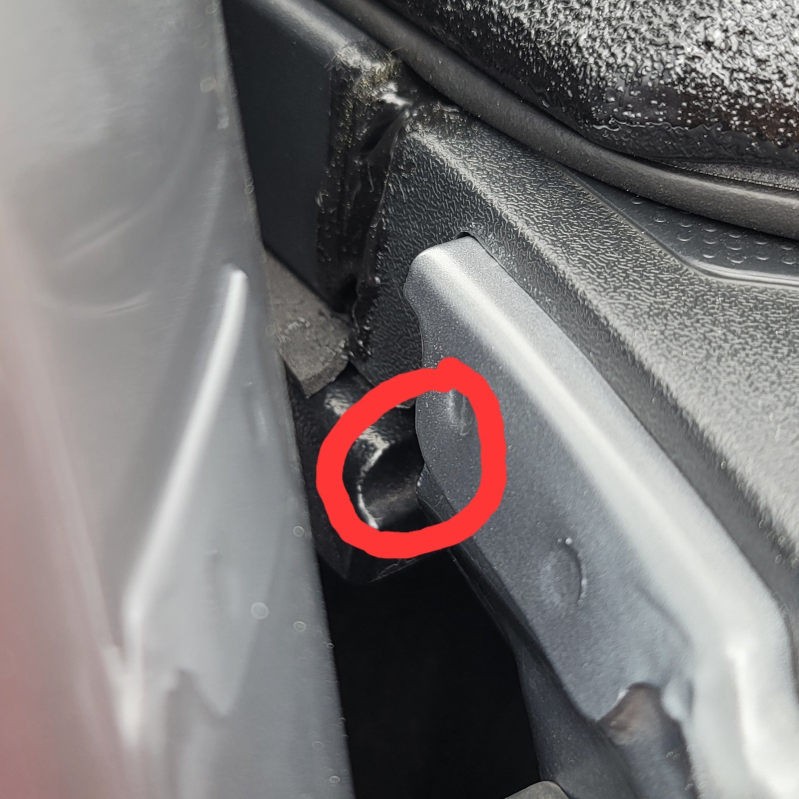

    Black putty will fix this problem
    If you notice you still can see light from the inside of the bed wen you look at each corners, this is the out side part that....
