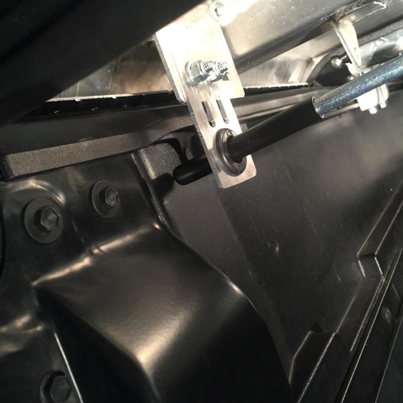

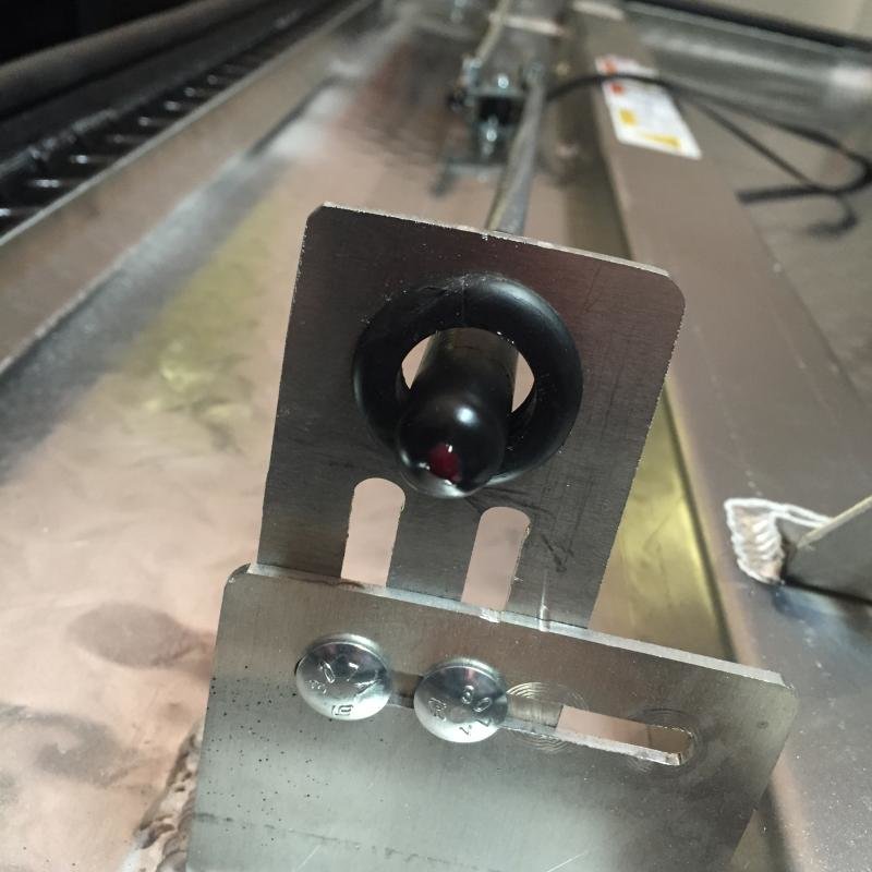

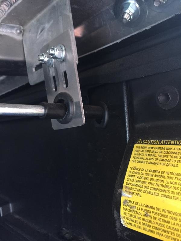

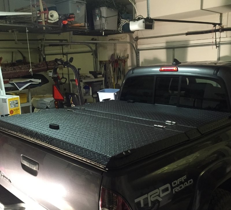

    Yeah got it will post review here shortly sorry been a crazy month at work!
    Attached a teaser pic will mention you do have to drill two wholes for the lock by the tail gate But its not bad comes with grommets.

    Have had my diamondback truck cover for about a month now happy I got it. I needed something that was tough and secure when transporting gear, but something that could be taken off when I needed. I bought the SE can hold 400lb on top with tie downs I don’t have an ATV so it was pointless to by the HD in my situation. I did have it line-x since it matches better to my truck I think.

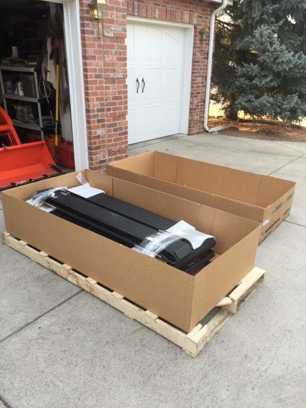

    Will warn you cover comes on a huge extra-long pallet, its 140.00 to the closest hub or business they or you can find. Just before my cover shipped they offered to residential for 150.00 might check and see if this rate still applies when you order. For me ten bucks was a no brainier.
    Over all I love the cover for the things I plan to do with it. Since I can transport the gear I need knowing I can lock it. This was my way of getting a truck vault without spending 4,000+ or as close as I can get at 1/4th the price. It’s nice to know it’s locked and there are no windows or ability to see what’s inside. You will need to add a Pop-n-lock or some other tail gate lock in order to have everything secure.
    Some notes on install!
    Have two people to install, doing this by yourself for the first time is a PITA since everything is new there is a little bit of fitting and adjustment that 4 hands make easy compared to two. Cover mounts right to your bed rails just bolts right on. I will mention since the 2014 rails have slots cut every inch or two makes sliding the clamps forward to back difficult also it may clamp on at an angle so you might have to adjust the clamp to make it square and or even pressure.

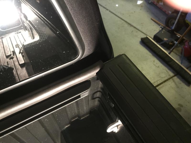

    note i cut the weather tubing at an angle to try and get as much sealed between the cover and the bed rails.

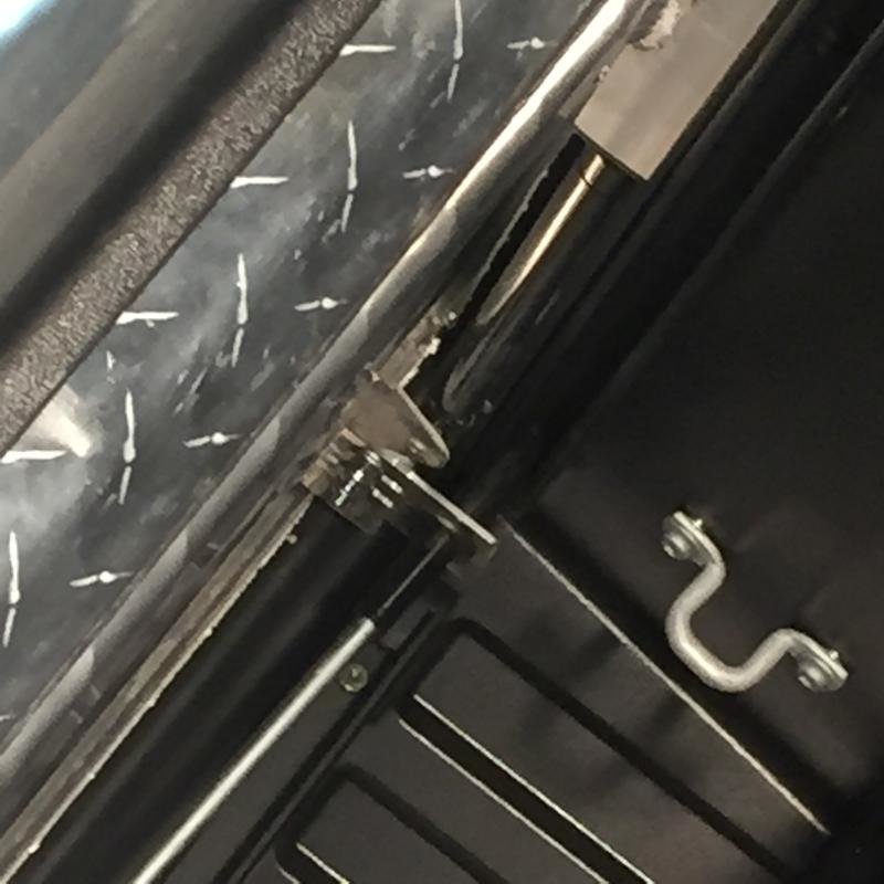

    iphone%20feb%201%20018_zpsxb5xpbl0_de5ee8dbfbbfcfefe003ef16de1da6755af47f6d.jpg you use the rails for the back of the bed bar lock by the cab.
    used paint to figure out where to drill the other two locking points.
    7b6899a8-3dec-48fa-b613-2a1f18208cda_zps_ae0be0a80dbcc053cc93cd4f1817dac277a94a04.jpg
    I decided to keep my bed rails on due to the clamp mount, can’t be torqued down that fare it bottoms out and is currently bottomed out or close to it. when it gets warmer ill post some pictures! say’s torque to 25 foot lb but just starting at 10ftlb I am bottomed out or out of thread on the bolt and the plastic rail is bending slightly I may upgrade rails or remove depending on how it looks here in a couple months or when its warmer. Currently I have the topper torqued to 10 ft lb I have gone back and check it after 100 miles just to be sure. But any more and I would be breaking the bolts or the rails cracking.
    All in all very happy with the outcome, I like how the topper sits a little higher, giving me what I was wanting.

    Thanks a lot! Answers a lot of questions.
    Is your truck Spruce Mica as well? I definitely will be getting the LineX option.
