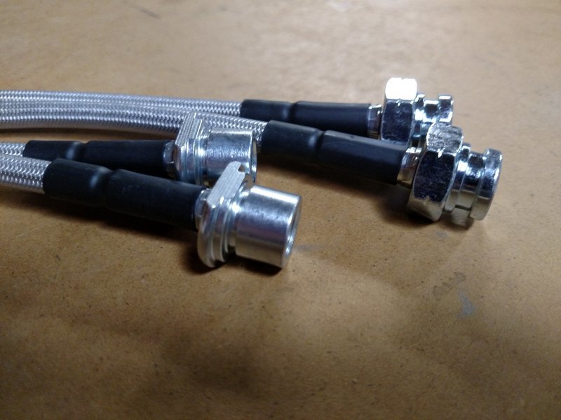

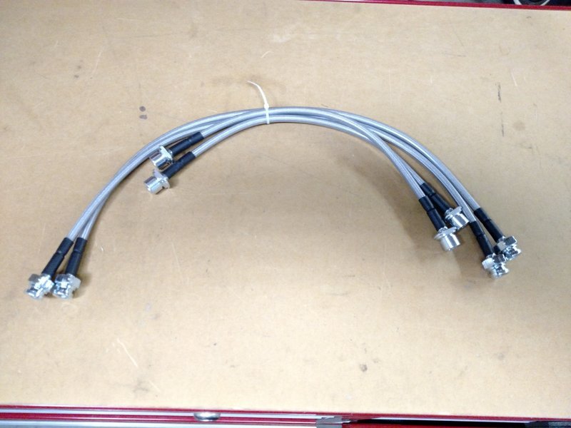

    Update:
    Installed. OCTaco/Goodridge brand extended brake lines, stainless, clear sleeve.
    Rear 23 inches (OEM is 19)
    Front 14.5 inches (OEM is 11.5)
    After much discussion and debate, I was skeptical of seeing an improvement in brake feel/performance, which merely would have been a bonus, because I put these on primarily for mid travel droop. In the future I will be installing aftermarket pads, but only after the OEM pads wear out, currently at only 12.5k miles.
    I must say that there is a clear improvement in feel and firmness as foot pressure is increased. Toward the end of pedal range, when pressure is highest, is noticeably more firm. Not dramatic, but noticeable. This is based on city grid stop-and-go driving, which is pretty typical for me most days. I did some hard stops and some routine daily route braking into sharp 90 degree turns at normal speeds.
    No other modifications were made at the time of line install to muddy perceptions or results.

    Excellent. Thanks for confirming one of the great internet rumors. We should send this to snopes.
    I thought my brakes felt firmer but given everything changed at once I considered it likely to just be butt dyno placebo effects. I guess I really did feel something.
