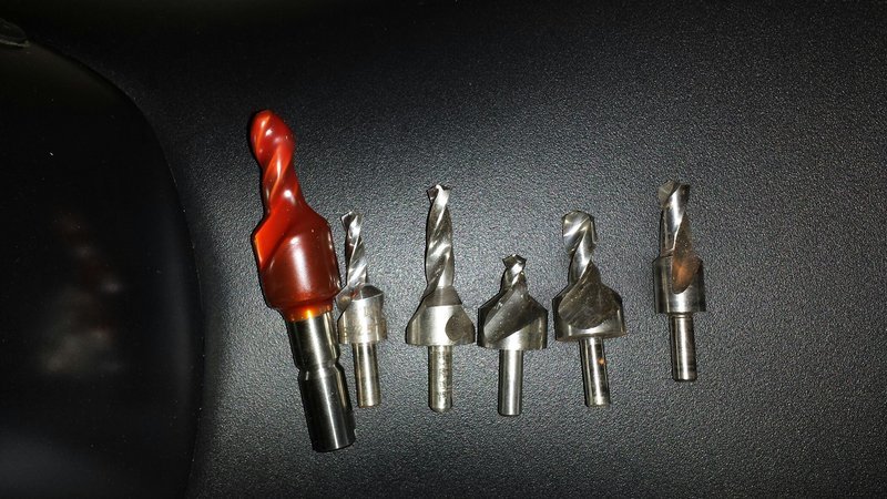

    Would a step bit get the results of chamfered edges ?

    Thanks, Stinky Winky. Yeah, I think you are right. But thanks for the effort.
    No, I don't think so. They're meant for thin stock and to continue cutting. A chamfer bit will provide a continuous, consistent angle around the circumference of thick stock at a precise depth. For my situation, it will need to be precisely handled on a press with depth stops.

    Understood. Thanks!

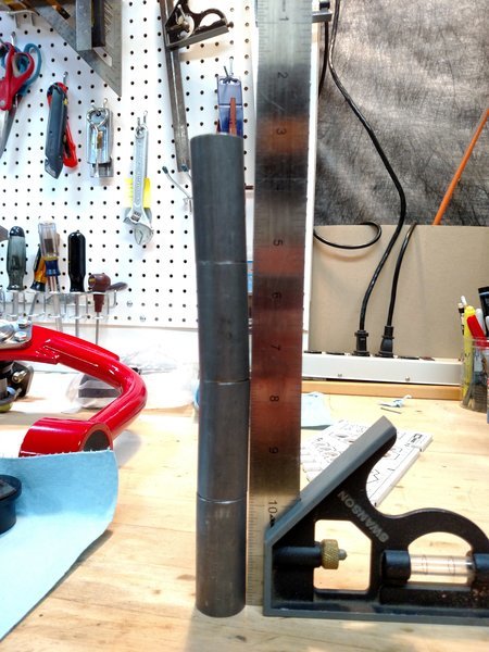

    I actually had time to open the JBA UCA box yesterday. And look at stuff. I actually have concerns about the way the steel bushing sleeves were fabricated. Or more accurately, hacked. And no special tool included for the rebuildable BJ. It takes a pin spanner of some sort. In his video, he shows a billet adapter of some sort, I would hope to accept a 3/8 drive for torquing the recessed external thread cap. Finally, the bolts fastening the BJ to the arm are too short. It is clear that when snugged down, the nylock nuts will have little if any thread sticking out. The bolts are 1 inch, and would be better at 1.25 inch.

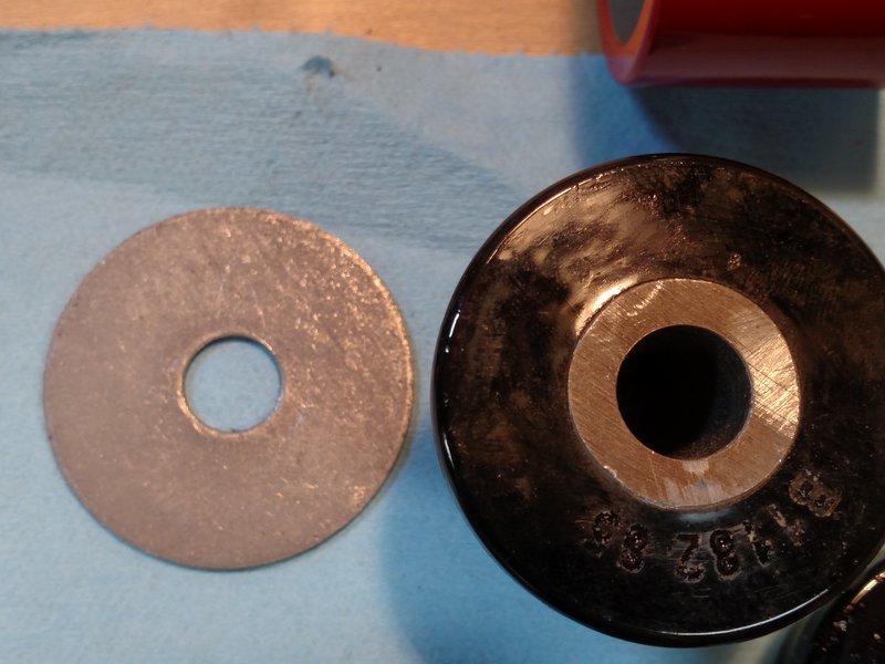

    So keep in mind that these bushing sleeves will be up against washers against the UCA bolt pivot point on the frame, a point of rapid and constant micro-rotations while driving under any conditions.
    I could tell something wasn't right, but it was hard to tell exactly what until I dicked around a bit.
    Hmmm.
    Blarg!
    Dreck
    Here you can see the cutting/grinding wounds and poor chamfering on the ends of the bushing sleeves. All were like this to some degree. They came in a sealed plastic packet with the elastomer bushing, likely from some third-party vendor. The bushings themselves fit very well and snugly into the UCAs and the sleeves fit very snugly into the bushings. But the ends appear to be hacked by child labor with a handheld grinder, or something like that.

    Totally Unacceptable.
