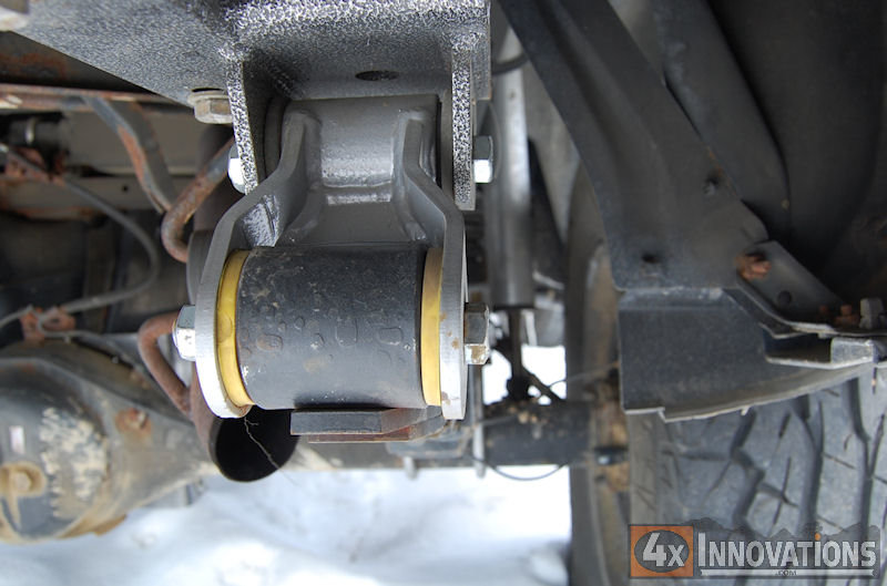

    Yes. And it's confirmed by 4x innovations they work as a direct replacement for OEM.

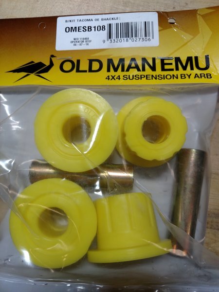

    @tacomgee here are the SB88s. I like the circumferential grooves on the flanges on the bushings that rest against the shackle arms/plates. In my opinion, that groove helps keep grease available in there, whereas a totally flat and flush bushing-to-plate contact would squeeze all the grease out pretty quickly.

    Yeah, that is all first gen stuff, those are greasable first gen shackles, OMEGS12. No such animal for 2nd gens from OME, or anyone else that I'm aware of. That's why I'm learning all over again. :(
    The SB108 bushings fit both ends of the CR047 Dakars for 2nd gen and have the same groove features. It's that damn upper, or rather lower o_O, inverted frame mount shackle with a factory metal-sleeved bushing that is what I am solving for. There is an Energy replacement bushing, but it requires that you extract that inner metal sleeve from the shackle, which is a huge PITA. this is all the stuff in Crom's thread, and a related thread I was reading up on and decided to pre-empt the whole lot of fuckery from the very beginning. Just a stupid, annoying factory design.
    EDIT: 40mm, fits both ends of Dakars. I'll be ditching the fron rubber pre-installed Dakar bushing too.
