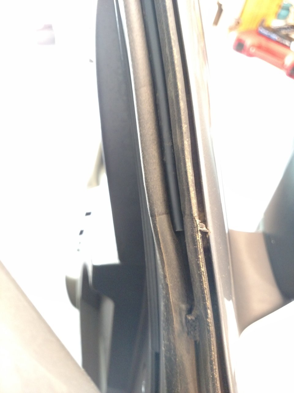

    Actual truck stuff today while down at dad's on health watch.
    Starting some 30k service items, first time I've touched some in a 2nd gen.
    • Cabin air filter Napa 4871 Enviroshield
    • Intake air filter Napa Gold 6888
    • Door seal kazoo fix, 1/4 in. drip irrigation line I have a couple hundred feet of

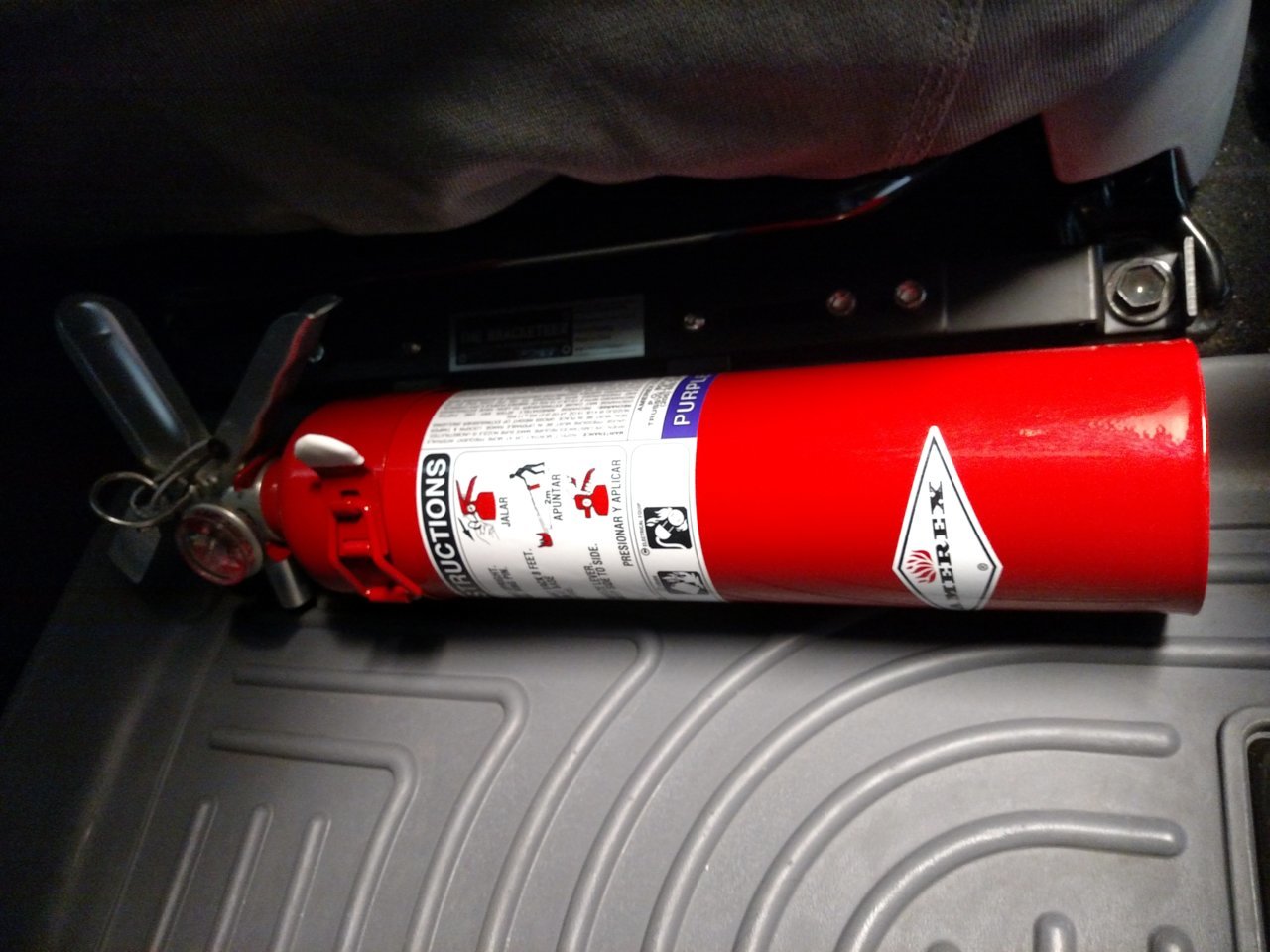

    • Amerex Purple K extinguisher mounted in a Bracketeer under the front driver seat

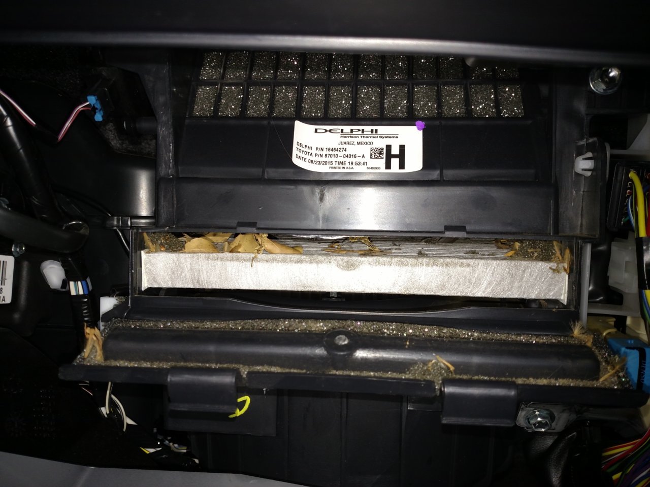

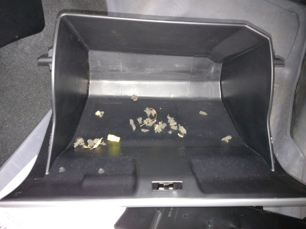

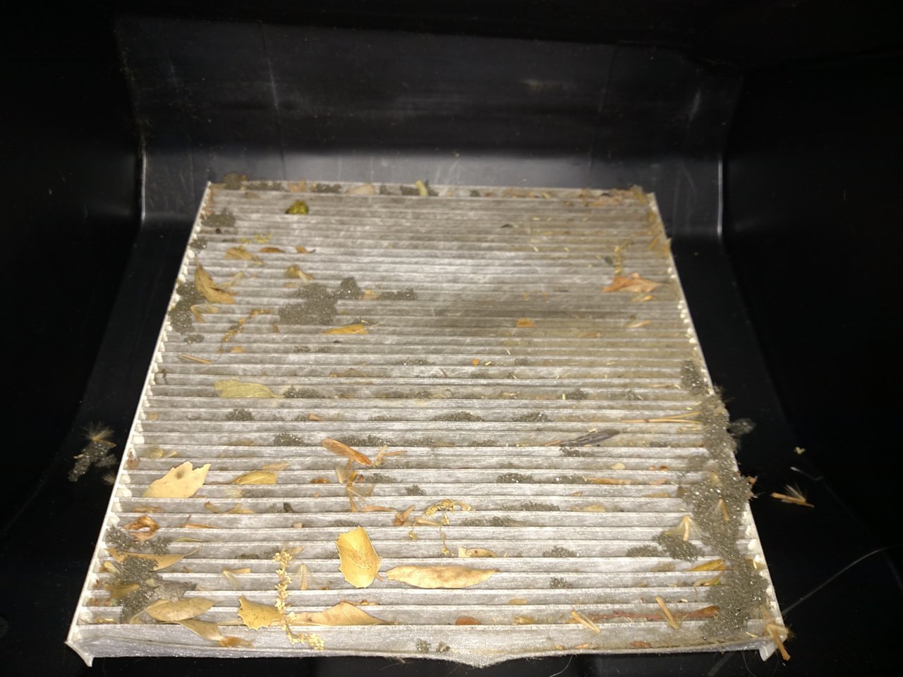

    Cabin air filter. WTF is with all this cheap ass foam from Toyota? Is the filter in here just to stop the disintegrating foam installed at the factory? Thanks, Obama.

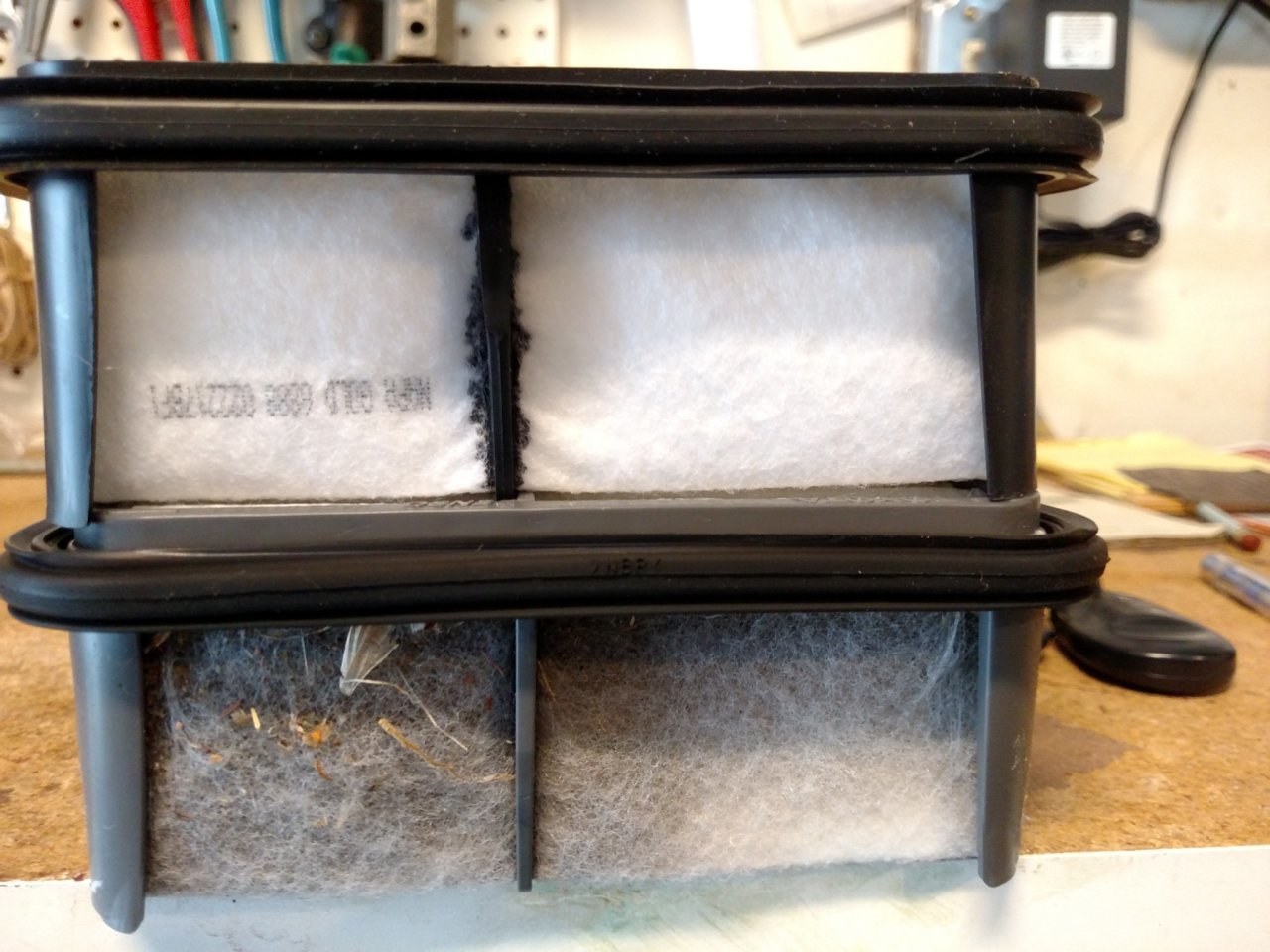

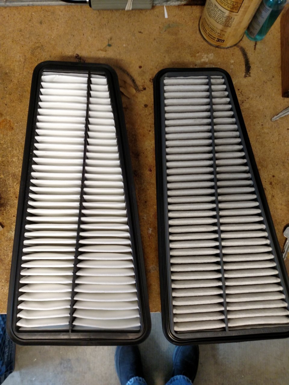

    Intake AF. Observation: 5VZFE takes about 5 seconds to change the AF, but the oil filter sucks. 1GRFE, just the opposite. Fucking wrestling match.

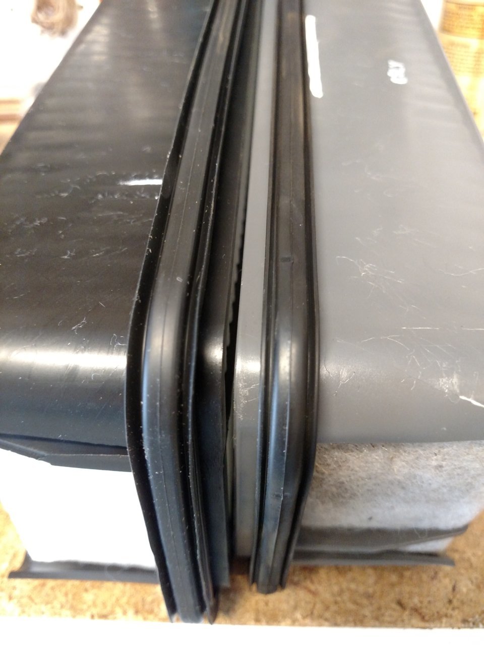

    Anyway, comparison of Napa Gold to OEM. They have exactly the same number of pleats, and the medium appears to be identical.
    30k, 99% pavement
    This last pic shows the only difference of note, the larger gasket edge seals on the Napa part. I'm good with this.
    Kazoo fix. There are fairly predictable hard cross winds on I-80 near the Carquinez Strait, always worse going westbound. I often forget how annoying this is until I approach that stretch of highway once a month or so. We'll see how this does.
    The extinguisher and mount (hard to see). All credit goes to @DVexile for his stellar research on this. I just copied him. I had an old, small ABC extinguisher in my old truck(s) for years, and it was time for a thoughtful upgrade, especially with a wee one strapped in the back seat. Thumbs up, K K K Ken!

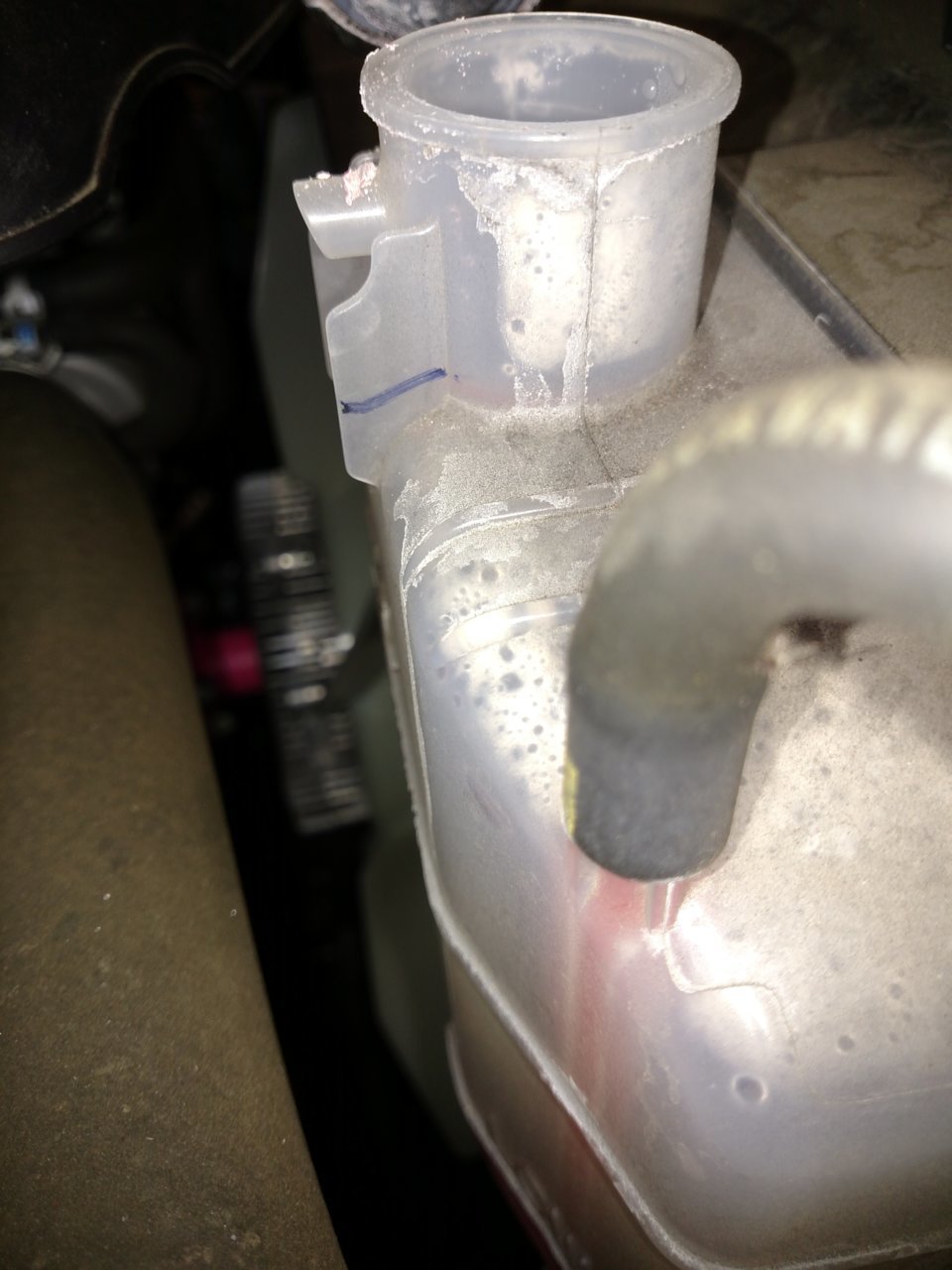

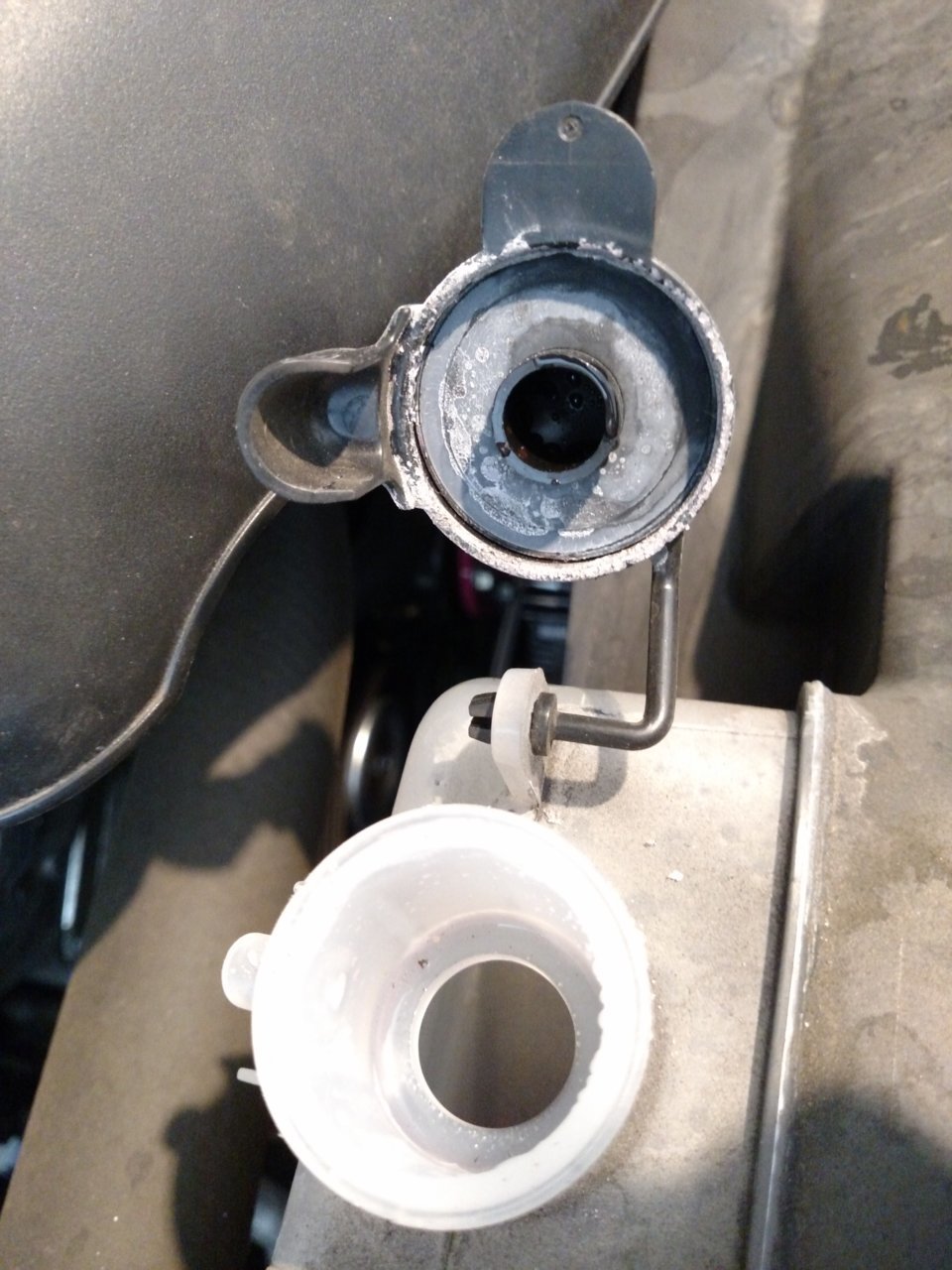

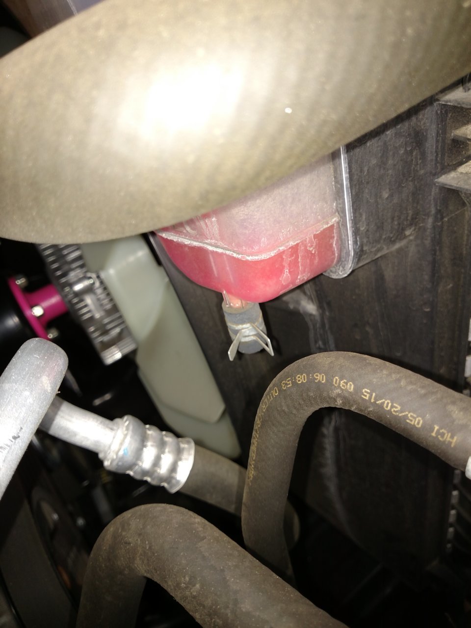

    On another note, I often noticed a faint coolant smell early on after purchasing the truck, and never could find evidence of leakage. Other late model 2nd genners have had similar experiences. Today I noticed what I deem an unusual amount of crystallized coolant on the outer edges of the expansion cap seal and tank that I had never noticed before. I generally keep coolant and vented battery acid cleaned up and tidy. Coolant (cold) was at the low limit fill line. Radiator was full. I realize these have an overflow vent integrated in the cap, clearly shown in these pics, but it appears the coolant is not exiting there, but around the cap seal itself. Doesn't seem quite right. Perhaps it is just another indication of Toyota's commitment to cheaper, substandard materials. Will be monitoring this.
    EDIT: I actually suspect it my be a bad seal caused by untrimmed plastic mold flashing around the neck of the tank. This occured to me and then I got distracted before I could grab a knife and trim it off.

    You're going to be surprised how much of a difference a new cabin filter makes. I have always been happy with Napa and Purolator filters.
    Regarding the coolant, I wonder if fabricating a thicker gasket would solve the overflow issue.
    Thinking about it, I wonder if the overflow mechanism is plugged and the pressure is forcing the coolant out through the cap-tank seal.

    I notice the same around my overflow tank. I put a zip tie around the rubber hose to make sure it wasn't coming from there and add a little coolant if I notice it getting low. I've only had to top it off once. I'll have to take a look at the plastic to see if it needs trimming.
