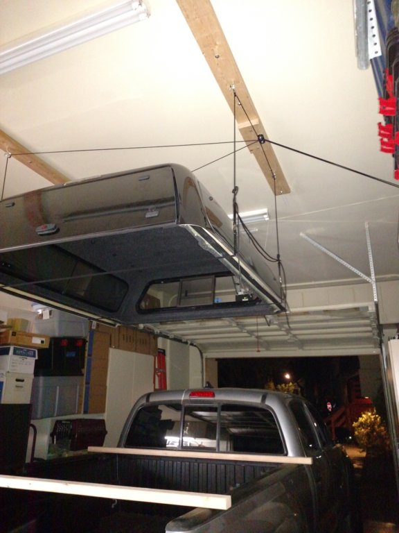

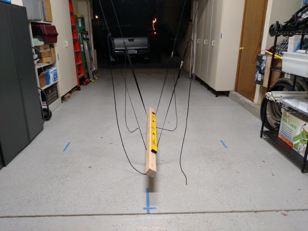

    OK. Well then.
    So, moving on to trucky things...
    Minor adjustments to the horndog harness to make sure it doesn't' kill me.
    And a one, and a two and a....
    I didn't die yet.
    Did some huffin today too.

    Engineered joists run crossways, so each of those 2x6 plates is lag screwed to about 6 joists. The pulley anchors are special lag pigtail hooks that come in the Harken kit.
    There is no access above. Those are bedroom floors. So through-bolting is not an option.
    The kit is 200 lb capacity, so the load is very dispersed and minimized to the joists.
    I'm going to add secondary eyes for ratchet straps, too. The Harken system include great hardware and a line lock integrated into the block and pulley system, but I added a wall cleat for a additional safety, and I also don't want to rely on that line lock for stopping 200 pounds and thousands of dollars of damage, or maiming or death, IYKWIM.

    Those are nice, but I just followed the spec in the Harken instructions. They provide the special stuff, and specify the hardware to match the buyer's install situation. I didn't see any reason to deviate, and it will make any lawsuits slightly more straightforward.

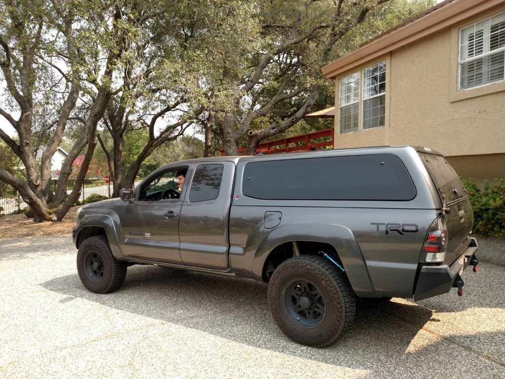

    So this is what they look like when they match...

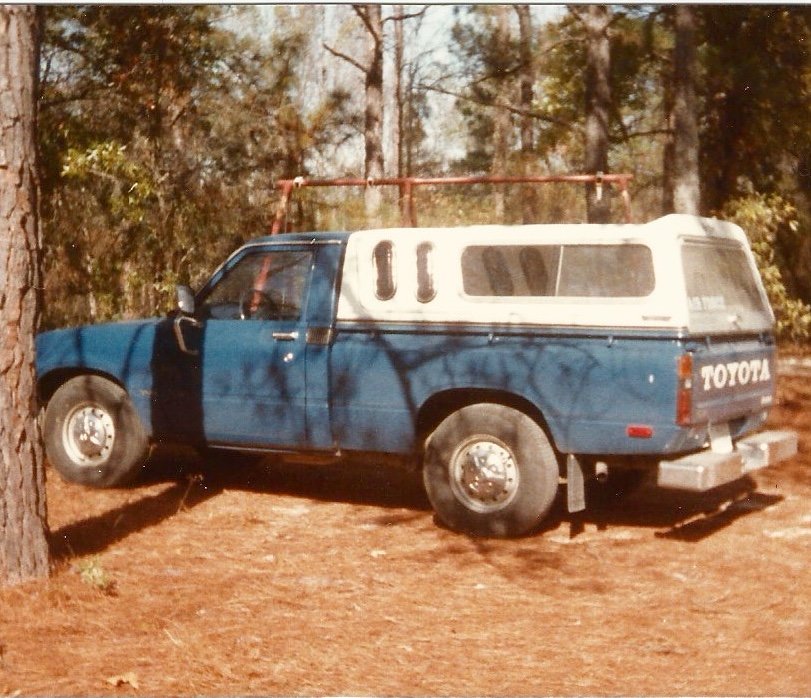

    I flashbacked to the days of white toppers...for posterity's sake ...
    Nicknamed "Trigger" by my wife...my 1981 SR5 pick-up ... sometimes I miss the rugged simplicity that was Trigger. :)

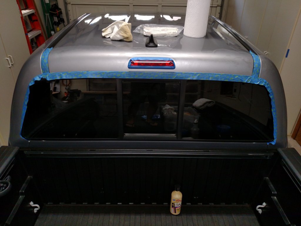

    Some intercapular TLC before the next one goes on, appt. on Wednesday morning.
