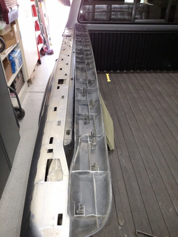

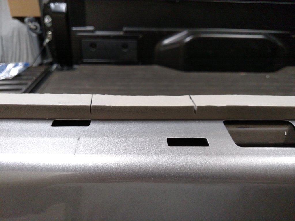

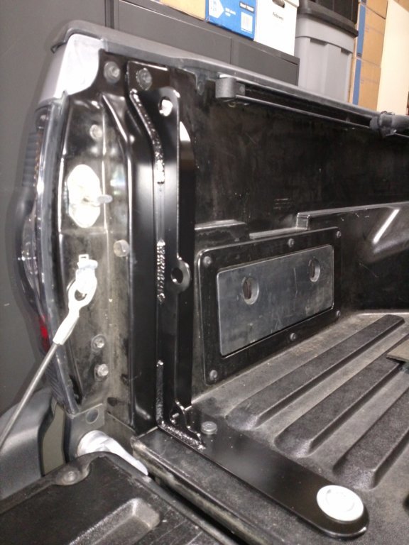

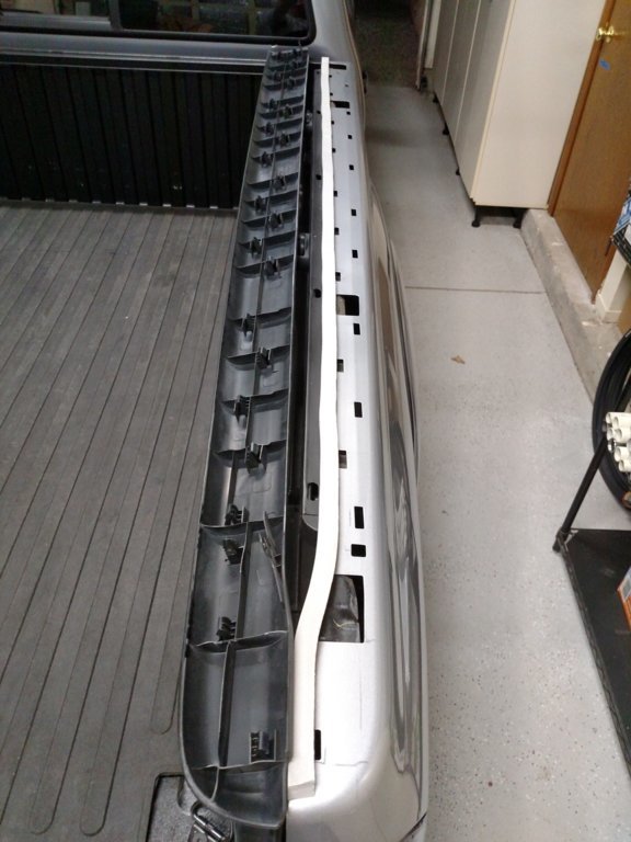

    OK so here are the other pics that didn't upload last night.
    This is where to lay in the foam seal.

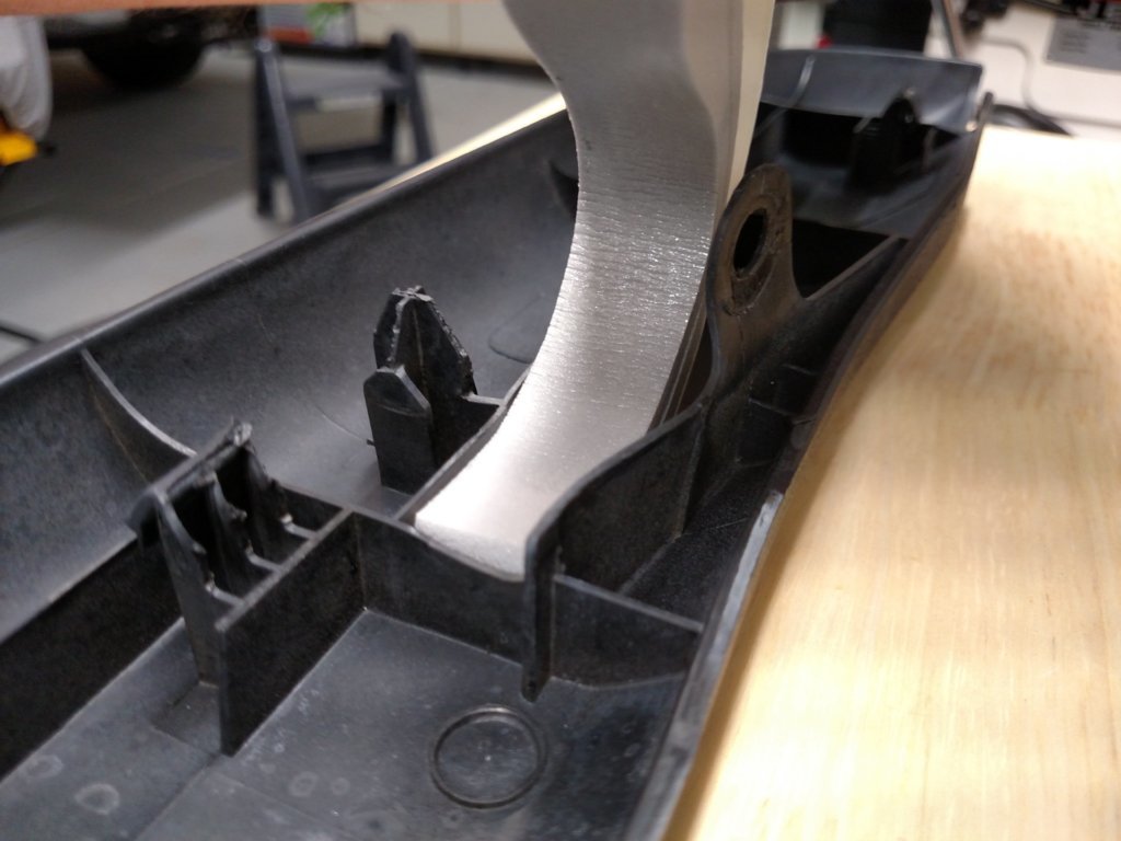

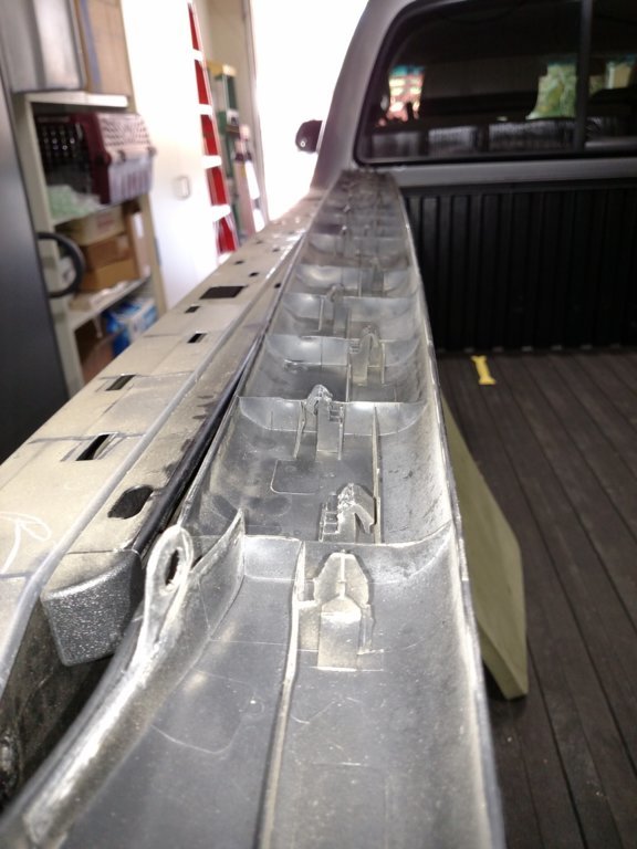

    And this is where it gets interesting. If you just install the Twat Waffle onto the foam as is, it will create wavy ridges and valleys in the foam seal, thereby greatly diminishing the dust barrier, and also creating a lot of resistance on install. So...
    First lay the Twat Waffle onto the foam without engaging the clips. Align it carefully front and back, and then press down, again, not engaging the clips. Now quickly pull it off, and you will have strong but short-lived impressions in the foam from the Twat Waffle grid. This is where I created relief incisions with a little kaizen knife to accept the Twat Waffle ridges and allow the foam to better fill the void above. I cut about 3/4 of the way through. Then, standing on the ground outside the truck, lay the Twat Waffle back over the rail, align it, and peering under the edge, you can slowly and gently work with a blunt instrument like an auto panel tool to nudge the foam back and around the clips before doing a final push down and clip engagement. It worked really well. I wanted to take a pic of that poking process, but I only have 2 hands, not 4.

    Oh and this.
