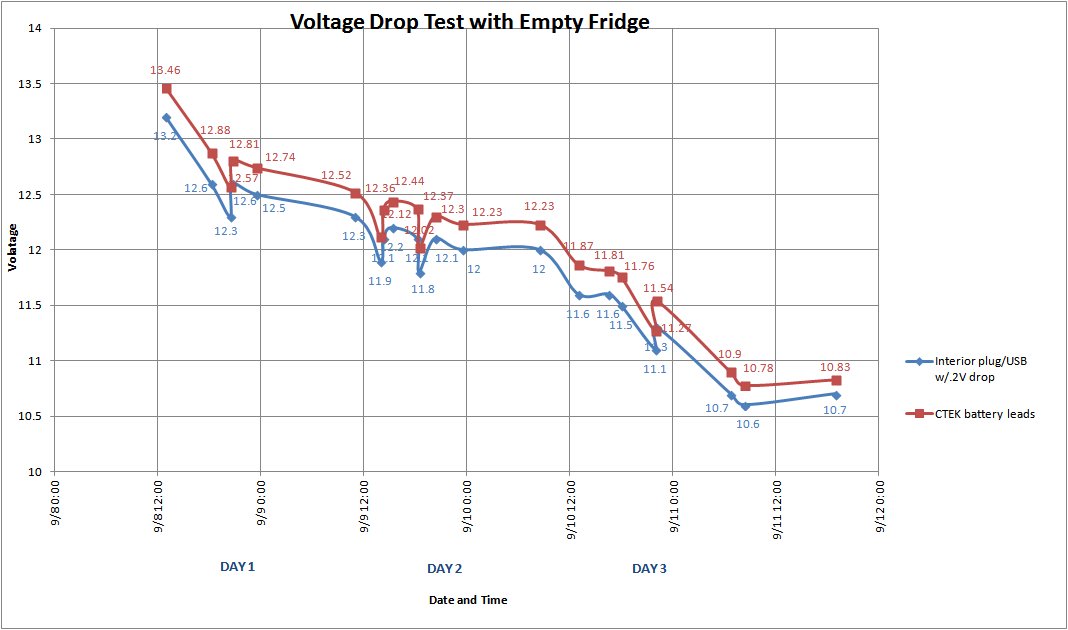

    So I freaked out on our last trip when the ARB went into power save mode after 1 day. Usually it has lasted 2.5 days to 3 when stationary and not getting a trickle charge from the truck.
    I flipped out, figured it didn't get the trickle charge from the truck on the 5-hour drive in, checked fuses, 7-pin, everything I could in the middle of nowhere. What I did not check was the battery saving monitor setting in the ARB that I always have on med or low (10.1v shutoff). Somehow, I found out much later at home when diagnosing, it got set to high, and that is what screwed me. Now I know better to check that first.
    But the whole scenario motivated me to take a hard look at the system and do a controlled test.
    I fully charged the battery using my CTEK.
    The fridge was empty. It is harder to keep air cold than a full fridge. So that was a bit of a stress test for worst case scenario/max power consumption.
    The USB Voltage meter on the interior plug (inside the trailer cabin) is one of these little Palumma units I bought on Amazon. Got one for the truck cab, and the Leer 12v outlets, too. Consistently saw ~.2v difference ( I assume basic voltage drop on the circuit), but it only reads to tenths of a volt
    The CTEK battery lead data us from me using a multimeter directly on the charge leads to the battery. My meter was reading at 100ths of a volt.
    The strong dips and peaks indicate when the fridge compressor was running, and then after it shut off. This was all pretty random interval over the weekend.

    I'm not too concerned about reducing volatage drop, because there just isn't much that can be done, or it probably is not the effort. It is a very short run from the battery in the trailer to the fuse block, maybe 2 ft, and all that length is needed just to be able to pull out and disconnect the damn battery. Downstream of the fuse block the wire is hidden, but it can only be 3 to 4 ft Max. And the ARB power cords are specialized and whatever gauge they are.
    I mainly wanted to get a baseline to work with and better understand the system, which will enable me to have a more measured approach when requesting the boy to QUIT FUCKING WITH THE LIGHTS.
    But I'll likley hardwire a voltage meter into the circuit somewhere back there.
    Oh yeah, and my next question how much trickle charge is going from the truck to the battery per hour when driving.
