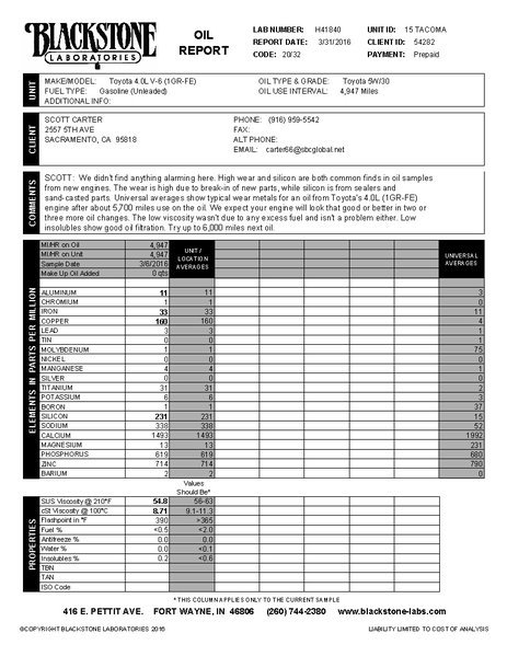

    Baseline Blackstone report came in from first oil change (break-in). I'll probably take another sample at 15k miles.
    We didn't find anything alarming here. High wear and silicon are both common finds in oil samples
    from new engines. The wear is high due to break-in of new parts, while silicon is from sealers and
    sand-casted parts. Universal averages show typical wear metals for an oil from Toyota's 4.0L (1GR-FE)
    engine after about 5,700 miles use on the oil. We expect your engine will look that good or better in two or
    three more oil changes. The low viscosity wasn't due to any excess fuel and isn't a problem either. Low
    insolubles show good oil filtration. Try up to 6,000 miles next oil.
    Also attached as PDF for better readability.
