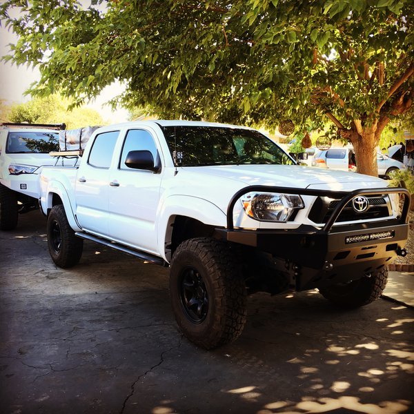

  8. Jul 16, 2016 at 7:59 PM
    #1148
    ChadsPride
    Nov 26, 2014
    #143119
    127,312
    Sponsored by TacomaWorld.com
    Dat bish is nice.
    Wood
  9. Jul 16, 2016 at 8:44 PM
    #1149
    cmack
    cmack Well-Known Member
    Jun 10, 2016
    #189259
    7,436
    18 Burrito
    Thanks. I have a rear that I need to get on eventually
    ChadsPride[QUOTED] likes this.
