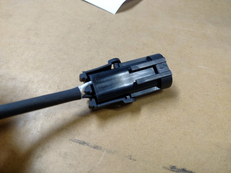

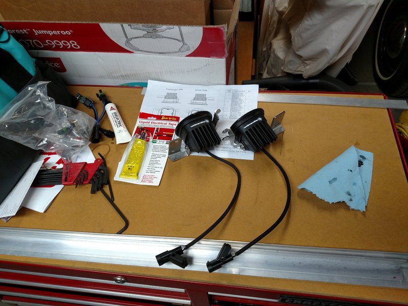

    Finally starting on the Baja fogs. I've had some pretty serious family stuff to attend to, and work has been a shit show for weeks.

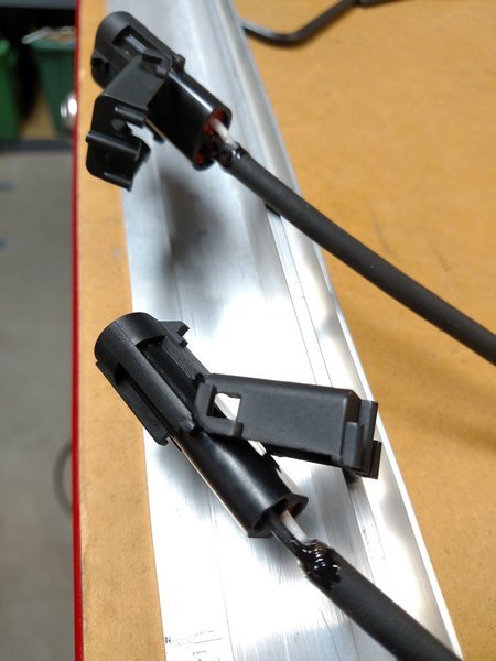

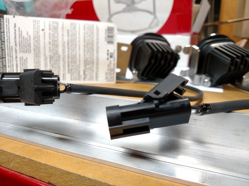

    Anyway, put the fog plug-and-play brackets on, and doing a little extra sealing on the wiring where they exit the Baja harness and into the weatherproof connectors.

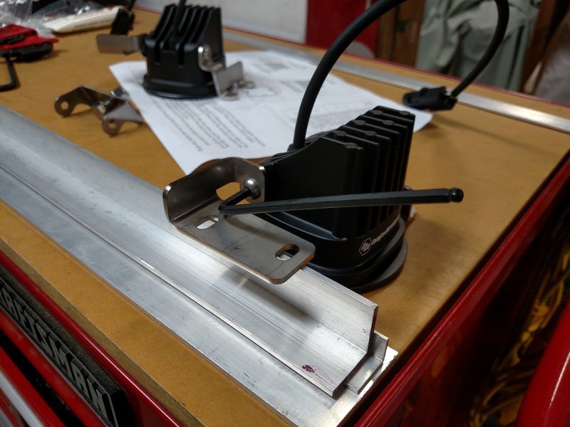

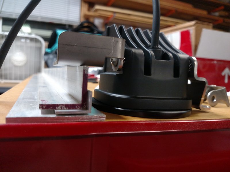

    To square up the brackets with the lense faces, I used some aluminum stock of various thicknesses.
    I did not like the simple cut with frayed cord exposed to wick up moisture, which could potentially migrate right up into the lamp housing over time, or if severely submerged for some time or repeatedly.
    Liquid electrical "tape" needs to cure 24 hours, may put another thin coat on.
