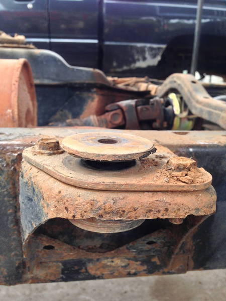

    Hey guys... so this isn't really what I would consider a build thread but just wanted to show some of the work i'm currently doing on my Taco so far. The Taco needed some TLC, the chassis had some rust issues :facepalm: and needed some new ball joints and steering rack ends. the truck was imported into the country a few years ago and it seems like the person just sprayed undercoating on the undercarriage just to hide the rust :mad:. So i acquired it from a company that had bought it from the importer knowing the work that had to be done....

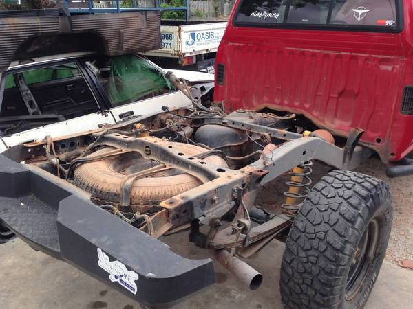

    So onto some pics.... This is how she sat when I went to pick her up
    A few days later... after some servicing and replacing the broken leaf spring and general TLC
    Then made a custom roof rack and installed some Vision X LED bars

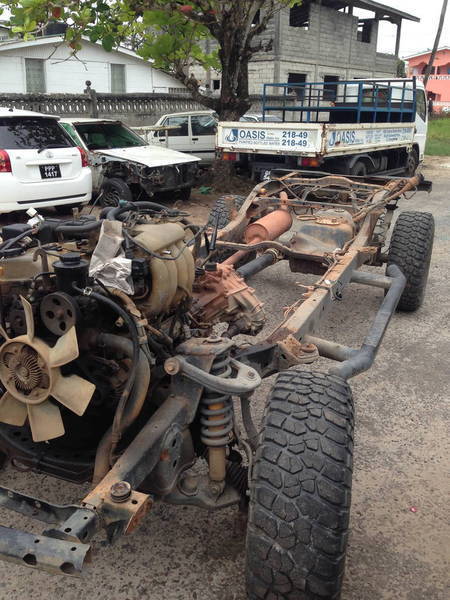

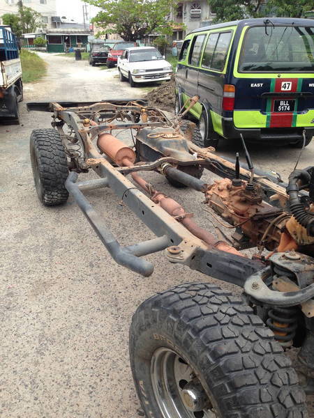

    She stayed that way for a little while until a few weeks ago .... Started the strip down

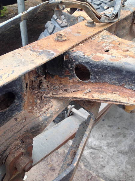

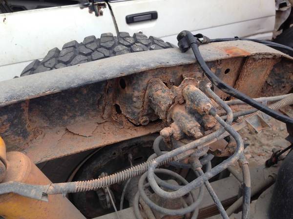

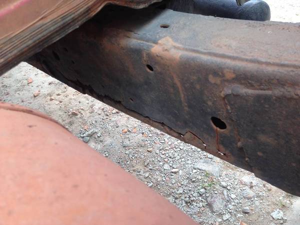

    As you can see the rust is pretty bad... had to replace the brake adjuster/splitter thingy also
    The rust had caused the frame to split at this point
    Cab and Tray off
    Cab mounts totally finished
    More rust

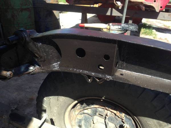

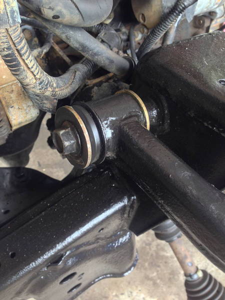

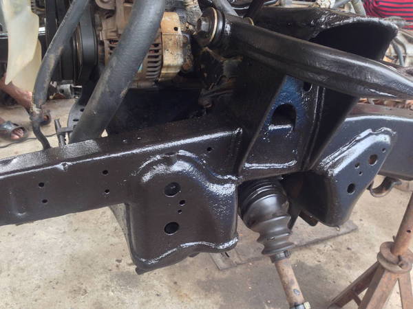

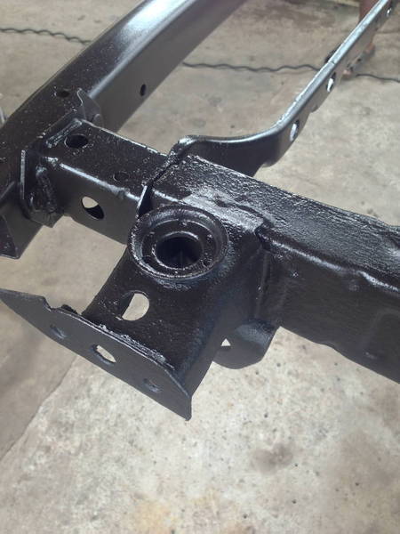

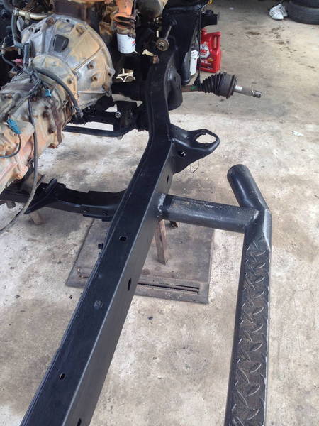

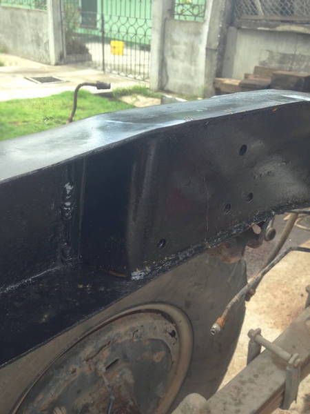

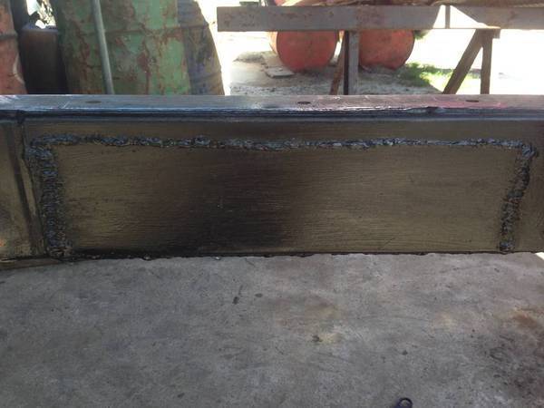

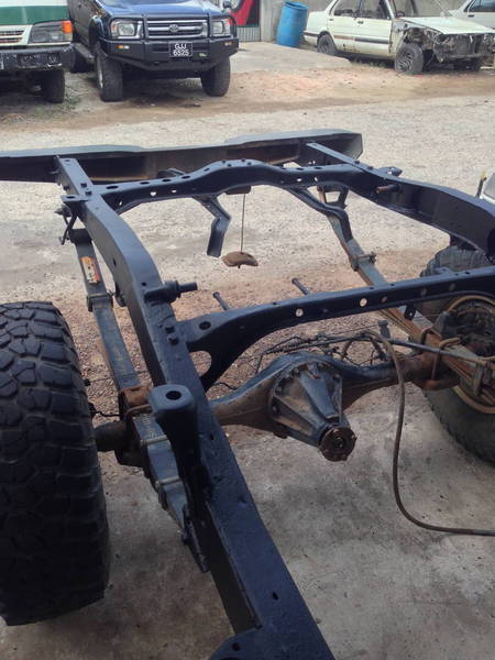

    So the plan was to sand and chip the chassis to remove rust and painted over rust along with cutting out some of the very rusted spots and re-plating them, then we would do a 1st coat of anti-corrosive paint followed by a final coat of Rustoleum Road Warrior coating
    Anti-corrosive... this is the same place in the previous pic that had the brake adjuster/splitter attached
    Another spot

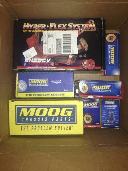

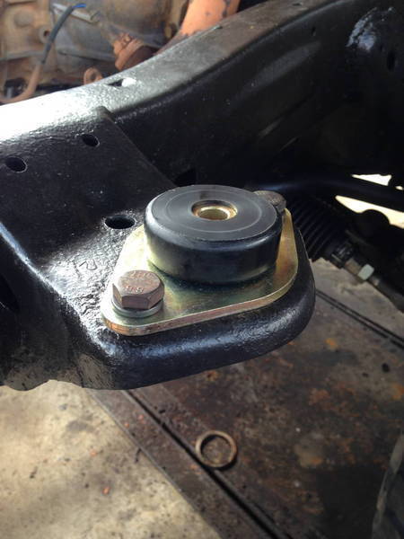

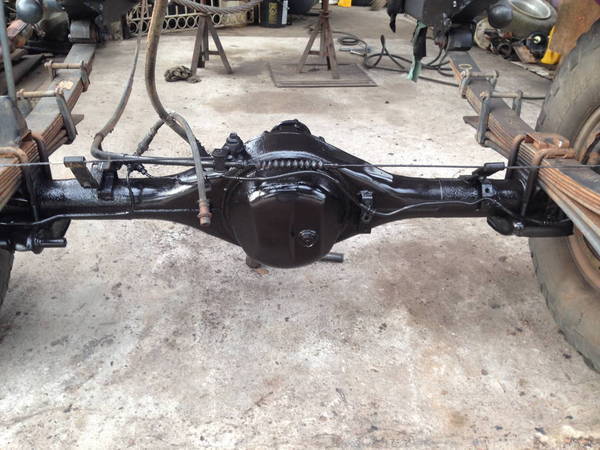

    So I had bought the Energy Suspension Master Bushing kit along with Moog Upper & Lower Ball Joints and Inner and Outer Steering Rack Ends oh also Sway-bar End-links
    A few pics after the second coat with the Rustoleum
    These sections were where the rust had weakened the chassis causing the split, we cut out the bad sections and welded in new metal

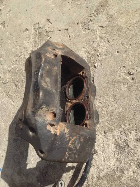

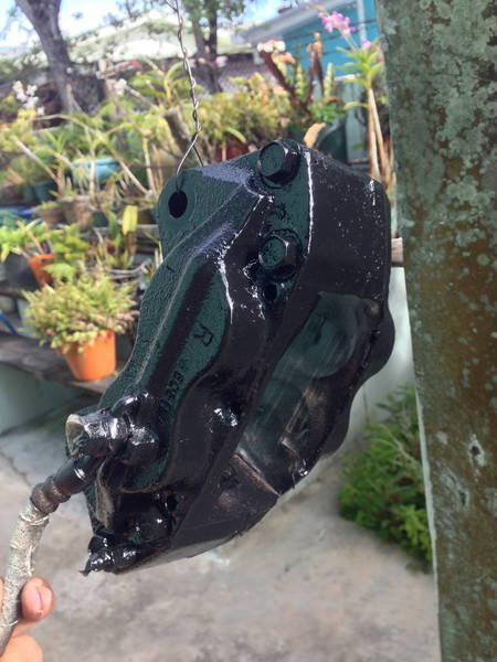

    Brake caliper clean up, a caliper rebuild kit was also installed at this time and resprayed with Rustoleum's caliper paint
    Rear of chassis re-coated
    New cab mounts
    That's it for now... will update in the next few days as we proceed. Thanks for looking and comments are welcome
