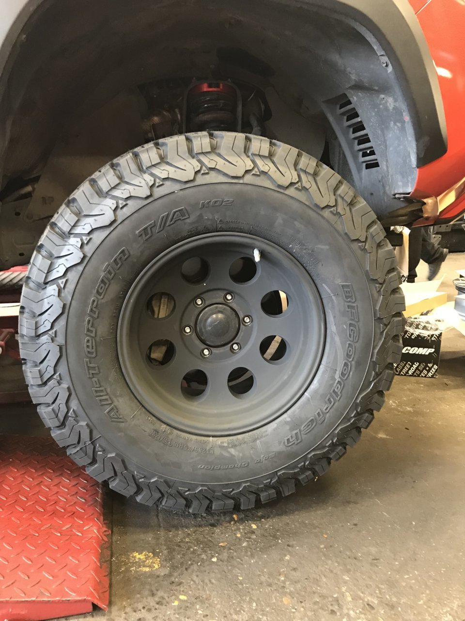

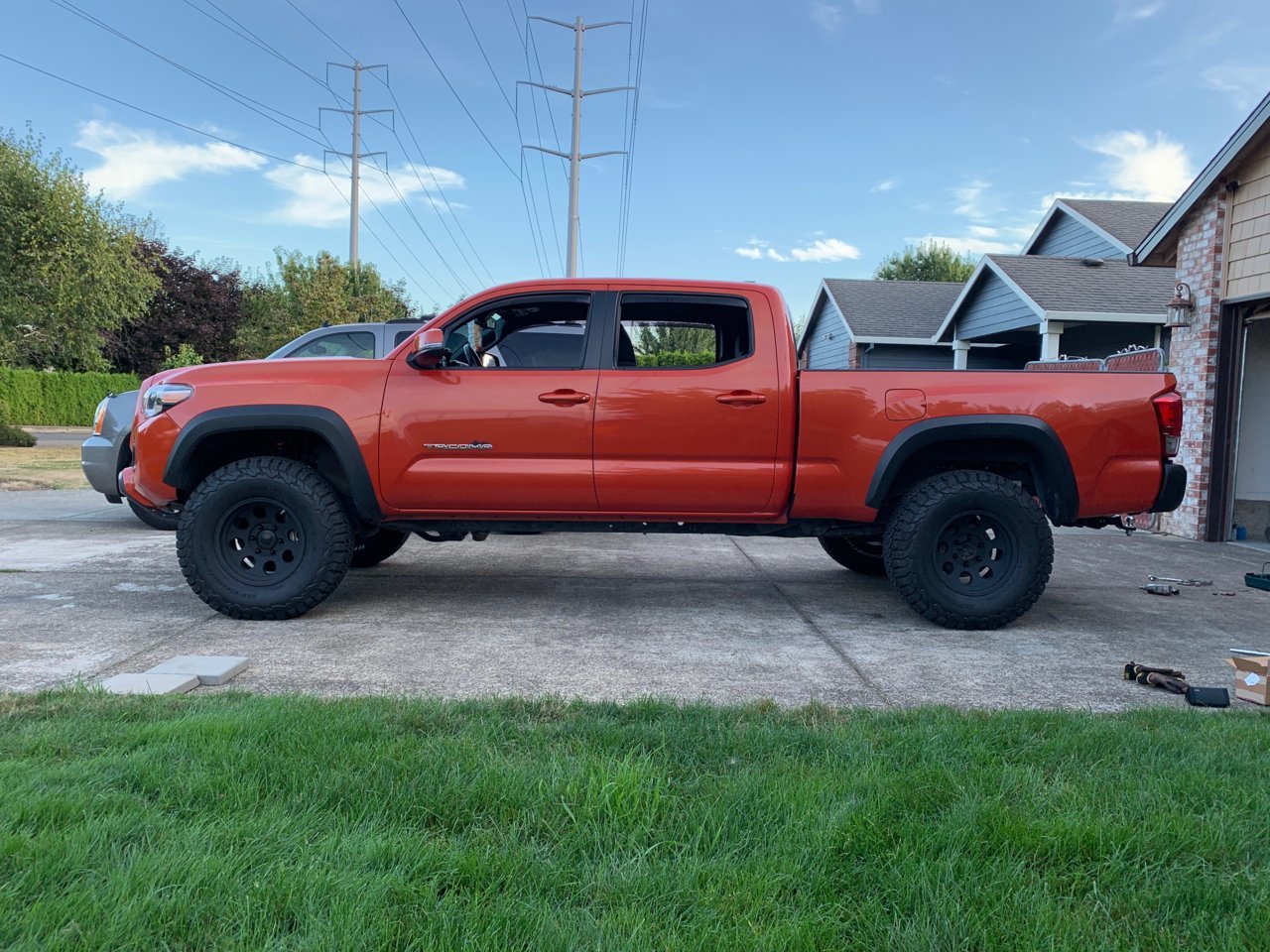

    2inch RC, Pro comp 16x8 -12 offset, 285/75R16 KO2k’s. Was going to do the ridge grapplers but decided to try our KO2’s. Doing CMC in the next week or so and had trim trim front fenders a little but happy I finally pulled the trigger. Have 1/2 blocks for the rear as well but mite do 1inch.

    I have the same pro comp wheels, I dig em :thumbsup: how is the balance? I'm always rebalancing mine, especially losing sticky weights offroading. But, I have the pleasure of doing all my own work in my shop.
    Truck looks good! Cmc tho... Ouch.

    Thank you, I’m really glad I went with the flat black on the inferno. They seem good but get slight shake from about 52 through 55 then it settles. The CMC shouldn’t be to bad have a buddy that welds and fabricates for a living. Have room but it’s close and I want to do it for piece of mind because I occasionally go Offroad.

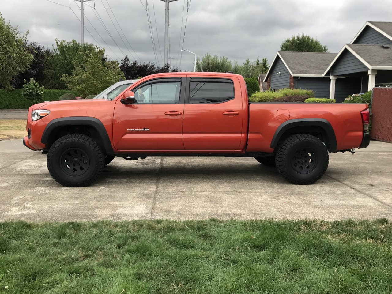

    Added 1inch rear blocks today. So much better

    So 2" front 1" back?

    Yes, did 2inch rough country spacer in front and 1inch Toytec block in rear. Drives almost the same as factory.
