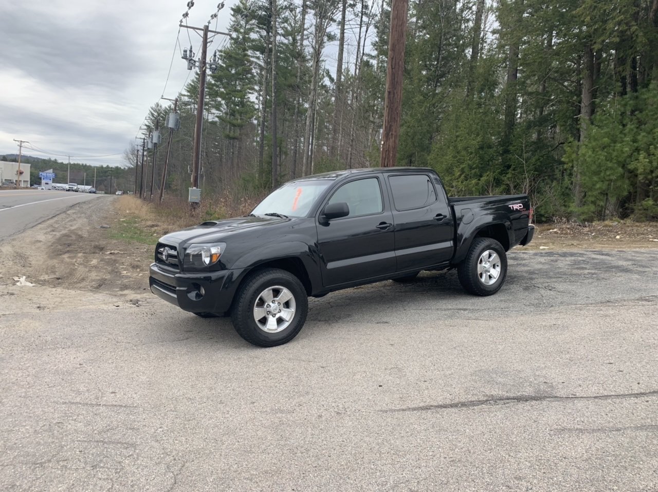

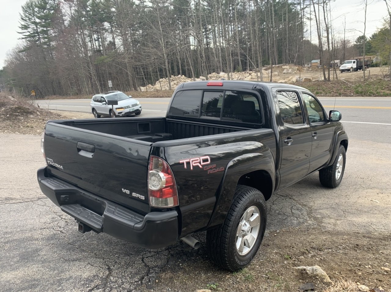

    Just got a 2010 DCSB, v6 AT. It has the TRD off road sticker, power plug in the bed, rear view camera in the mirror, and outside temp/compass. But no RR locker button? And doesnt look like an actuator motor on the rear diff? Was the locker an option or standard?
    Running the vin doesn’t come up with much specific info at all, barely any options listed.

    Yes, rear locker is exclusive to TRD OffRoad and TRD PRO models, if it doesn't have a locker it's not a TRD OffRoad.
    The inverter, compas/temp mirror, & backup camera I believe were optional on SR5 models and standard on TRD Sport and OffRoad models.

    ?? Hood scoop? It’s got one of those. Maybe it’s a sport.

    TRD Sports have hood scoops, color matched bumpers & side mirrors, the newer ones had turn signals in the side mirrors, and the sticker says TRD Sport unless someone changed it.
    Post up some pics:thumbsup:

    I’m good with it. Just like to know what I’m dealing with as I get familiar! I get it, stickers are easy to slap on. But if it’s not an off road or TRD sport I’ll take the stickers off. Looks like blacked headlights but they could be aftermarket too

    Those are sport wheels as well

    Looks like a TRD Sport that someone slapped some OffRoad stickers on.
    Still nice truck:thumbsup:

    If it is a sport it will have the LSD rear diff

    It’s got LSD warning lights on the dash. Sport it is, mystery solved

    LSD is simulated using the ABS on 09+ models, 05-08 models had a mechanical LSD.

    Tailgate has an SR5 badge.......

    Looks like somebody lied to you
    Some things I can see:
    -the sticker doesn't look real
    -if it's supposed to be 4x4, should have come with mudflaps with white print "4x4"
    -some Tacos came with black headlight housings; sometimes people install them afterwards (I did)
    -look under the back. Old TRD Sports had a mechanical LSD 8.4", and TRD Off Road was 8" e-locker. If there's no e-locker, probably not an OR
    -has 17" 5-spoke TRD Sport wheels
    -TRD OR should have a gas tank skid plate with holes in it; yours might not have one
    -TRD OR had chrome rear bumper. TRD Sport was painted body color; yours is body color
    -yours has a hood scoop; TRD Sport had them, TRD OR was no scoop for better off road visibility
    I don't know if non TRD came with non yellow/blue "TRD" shocks; it's possible

    pre-2012 all the TRD ORs and Sports had an SR5 badge on the tailgate. OR and Sport are packages added to the SR5 trim
