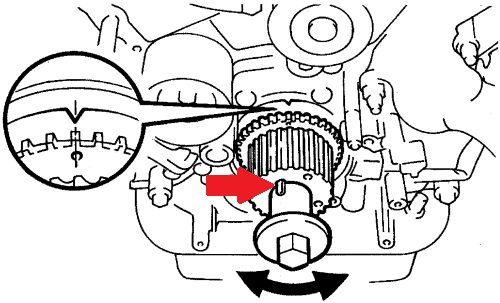

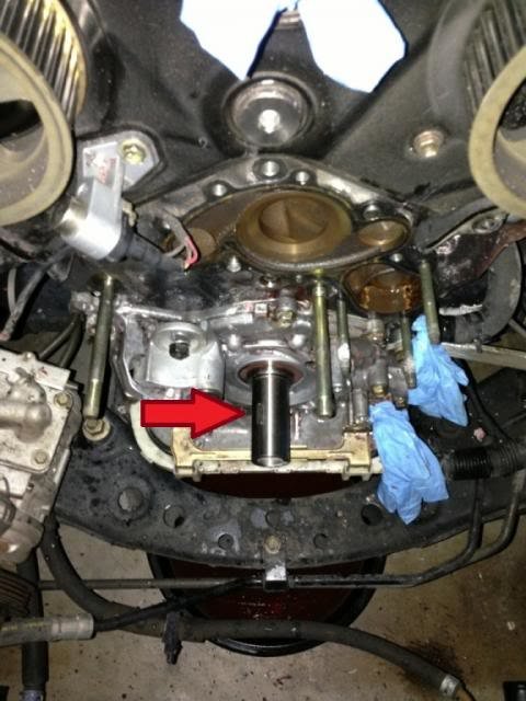

    Here is the diagram showing the little piece that broke:
    The following is not my engine. Just some pic i found to show you the part.

    It's called a key (crankshaft key, shear key). It's basically there for timing purposes. From what you wrote, they screwed up. If it ran when you brought it in, no matter what, it should run after a simple timing belt change. If they knew what they were doing that is.

    We need pictures of the problem to give you an accurate response.

    So they want you to pay to replace the entire engine for a shear key and a seal? Wow. The key is designed to break (weakest point) to keep the crankshaft from breaking. And the front seal is a replaceable part. I don't understand how they are saying the engine needs replaced. Maybe I am missing something here. The seal not being all the way in maybe cause a groove on the crank, but it shouldn't be enough to cause damage if a new seal is put in. I call bs on them.

    A better picture of the keyway slot is really needed. If the keyway slot has been damaged, then the dealer is correct in not wanting to reassemble, because the replacement key could shear or break, causing possible engine damage, and the dealership would be held liable. Everyone wants to just jump in and sue the dealership before all the information is clear. Shesh. Let's get all of the CORRECT information first here. A better picture for one of the slot for the key.

    That key is a replaceable piece, PN 9028005005 selling for $0.96 online:
    http://www.villagetoyotaparts.com/products/TOYOTA/2004/Tacoma3400CC-EFI--AUTOMATIC--4-SPEED/KEYFOR-CRANKSHAFT-TIMING-GEAR-KEYFOR-OIL-PUMP-DRIVE-SPLINE-KEY--CRANKSHAFTFOR-CRANKSHAFT-PULLEY-SET-KEY--WOODRUFFFOR-TIMING-GEAR/2426689/9028005005.html
    The crankshaft oil seal is also a replaceable wear item. In fact, some repair web sites recommend replacing the cam and crank seals when doing the timing belt, to save on labor.
    So why does the dealer think the engine needs to be replaced?
