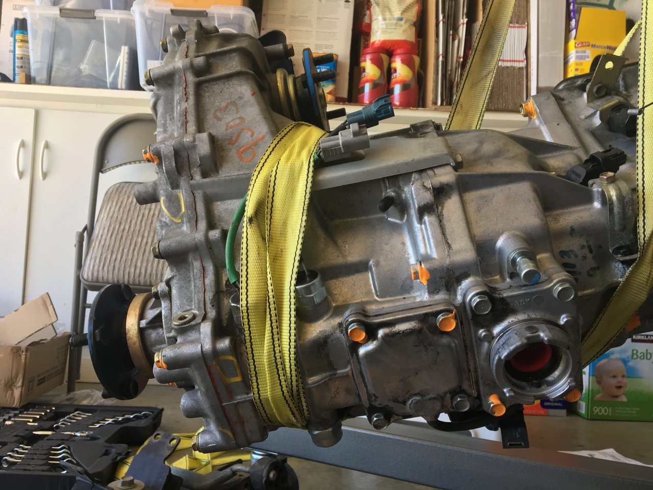

    Is that why the transfer case has an extra section to it? It looks different than the 6 cyl complete tranny assemblies.

    I thought so. I mean there is a slight difference, but a really really minuscule difference. I have the tranny slanted forward on my crane so I can drip all the residual ATF from the tranny into the pan so I can get some kind of sample from the inside. I don't want to open up the pan until I get the OK from the scrapper.

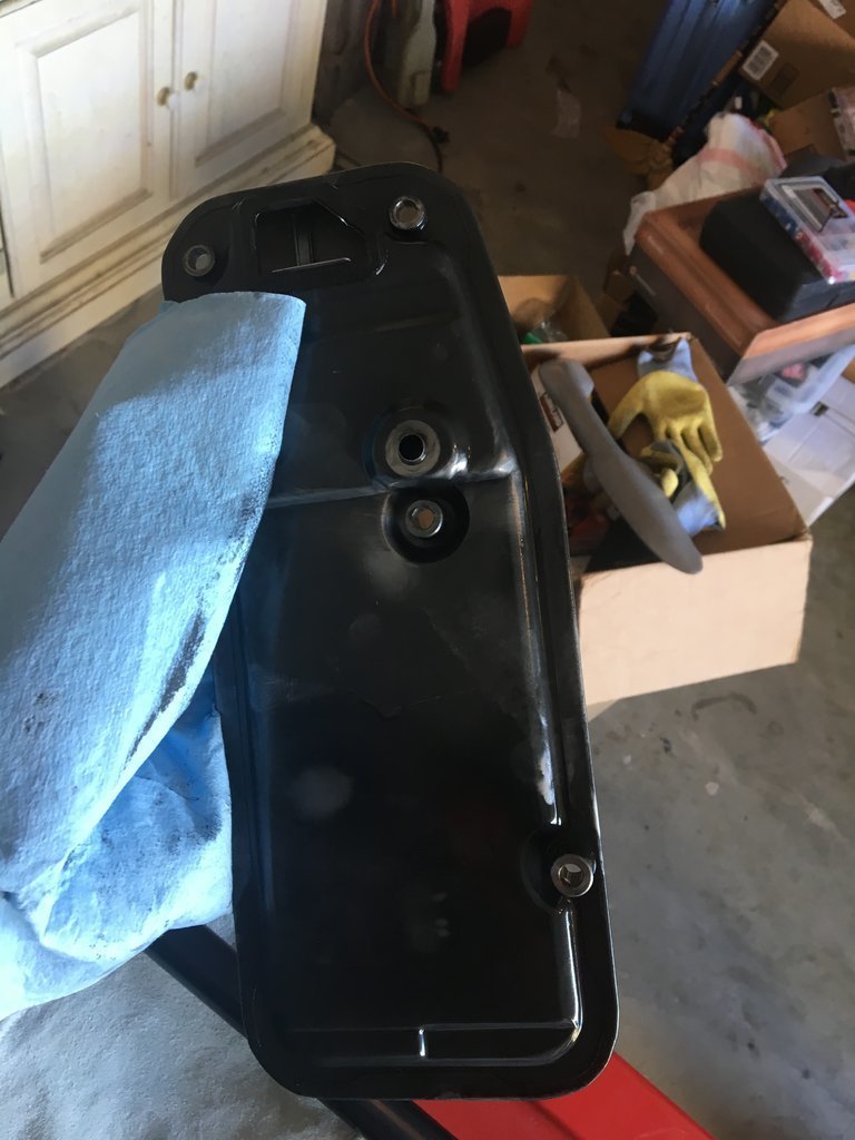

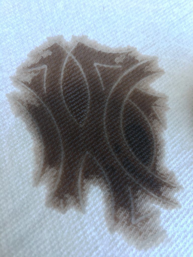

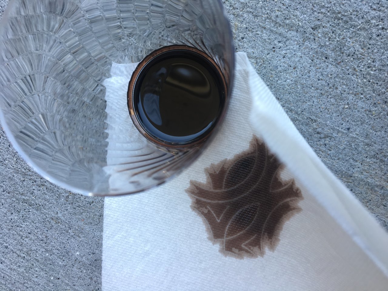

    Here's another sample from the torque converter. Everytime I drain it more fluid accumulates.

  10. Jul 23, 2017 at 12:23 PM
    #30
    koditten
    koditten Well-Known Member
    Sep 8, 2013
    #112077
    19,848
    Kirk
    Central Michigan
    04 trd x-cab 4 x 4 3.4l
    Reserected from the dead.
    You need to mix up a strong drink and step away from this transmission. You are working yourself up unnecessarily.
    Your concerns are valid, but there is not much more you can do beyond installing it and running it with new fluid.
    Get it installed and run the thing.
    ghs57, Wulf and BartMaster1234[OP] like this.

    Just remember, recyclers do not want to put questionable parts into their inventory. They do not want to have to give you another unit. If they had any doubt that it wasn't a good running part, it would have gone directly to the scrap pile.

    this. The transmission you bought is fine. Dirty fluid is normal and not always a good indicator so don't get worked up.

    like stated many times above it should be ok. The issue is not so much the fluid as the crap that has settled into the nooks and crannies inside the trans. If it is not disturbed and is still sitting there a fluid change should be just fine. When the small clumps are broken free and settle to the bottom of the pan then get sucked into the filter screen there is a potental for blockage or some getting past and binding the spool valves... these passages have a very, very fine clearance.

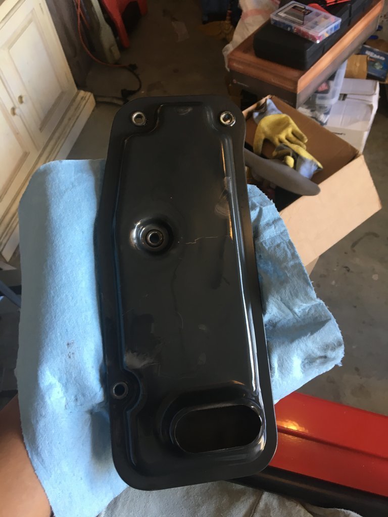

    Just got off the phone with the scrapyard and the manager who sold the tranny to me. He basically confirmed everything you guys said (the owner may have not regularly changed it, just have it flushed, etc.) he gave me the okay to pop off the pan and break the warranty seals to inspect so I will be doing that right now. Stand by for pictures.

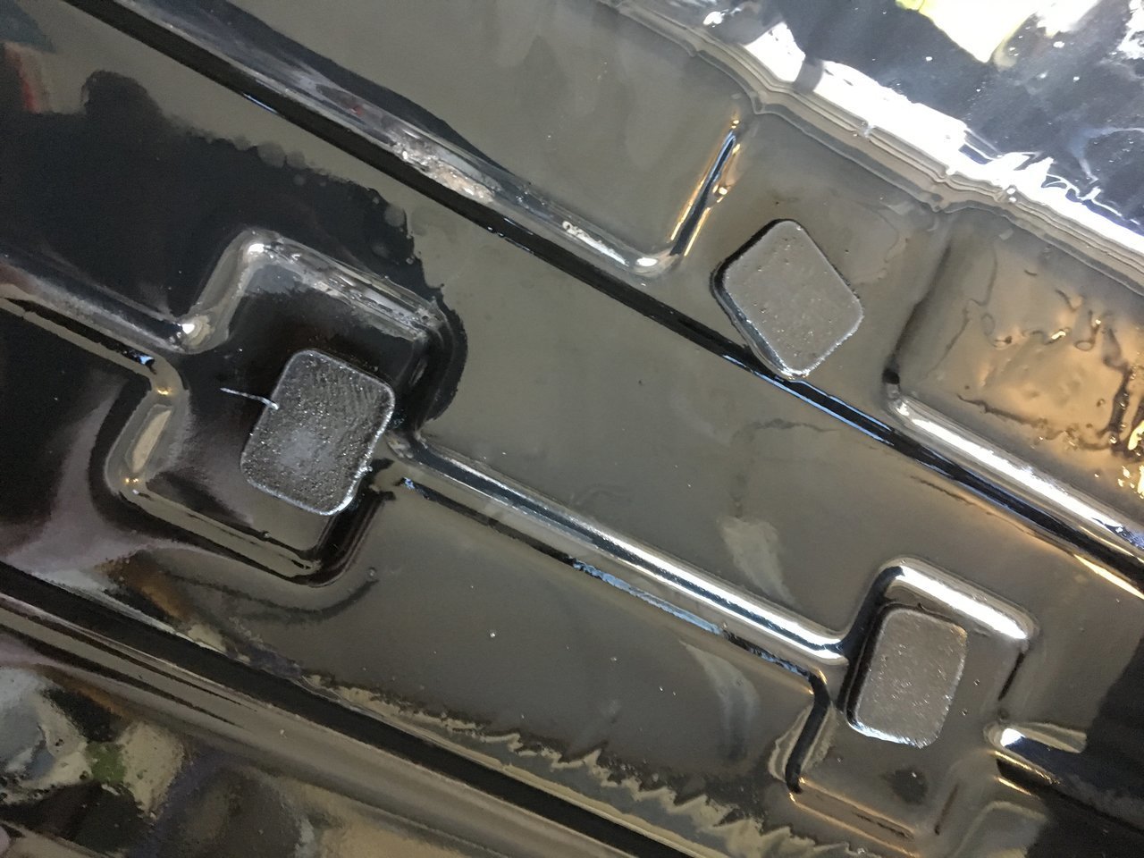

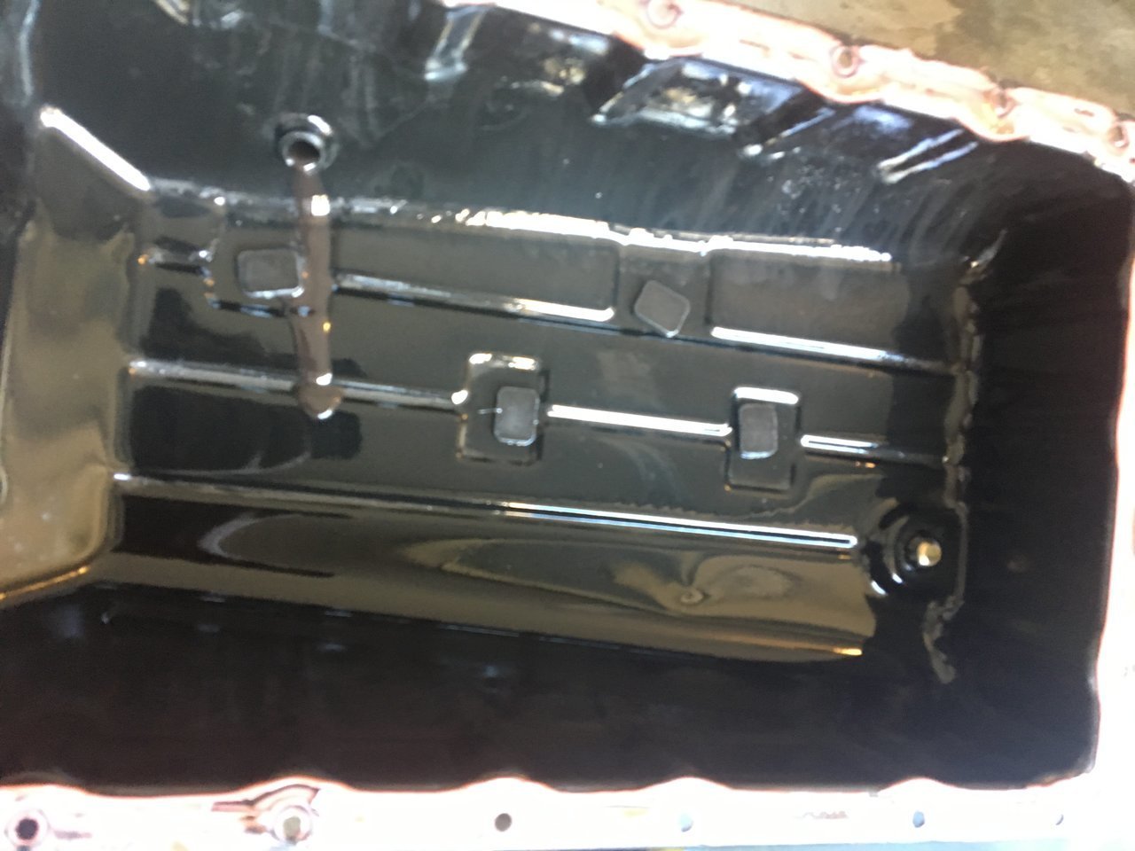

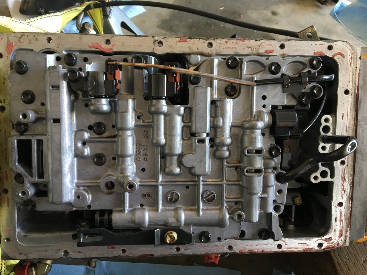

    Here's what it looks like inside. Some magnetic flakes but they're almost minuscule.

  17. Jul 24, 2017 at 1:40 PM
    #37
    koditten
    Sep 8, 2013
    #112077
    19,848
    Kirk
    Central Michigan
    Now will you relax?:)

    Not until I get the results from Blackstone for the ATF sample I sent in :rofl:
