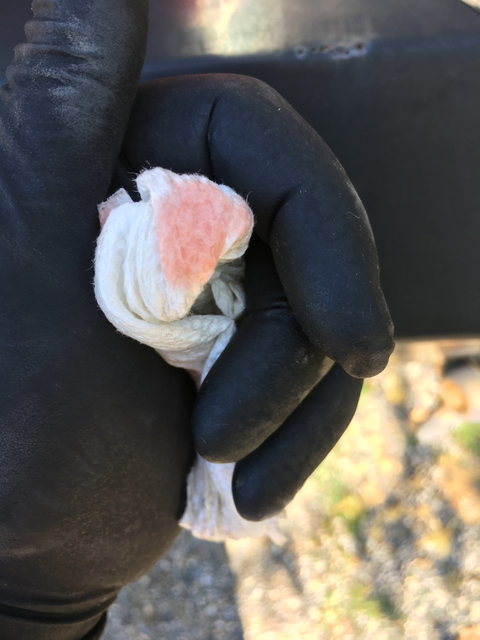

    - So i was towing a boat (2200 lbs) up a very steep and long gravel grade back road. I was in 4x4hi and had the shifter selected to 'L'. About halfway up i noticed the red A/T Temp light was on, so i immediately stopped the truck, placed it in park and turned it off for 10 minutes. When i started it back up, the light was gone and i was able to drive the boat home the additional 250 miles without issue. Ill be getting a transmission cooler before towing again. But my question is, what other steps should i be taking? Do i need to replace the transmission fluid? What possible damage if any could have been done by getting the transmission so hot?
    Thanks,
    Edit: I dont see any oil leaking under transmission and the coolant is between low and high in the reservoir. Outside temperature was 70

    If you have never replaced the fluid you should anyway. If you have, open the fill plug and stick a paper towel in there to wick some on the towel. Does it smell burnt? Is it still red or is it brown?
    If you want to play it safe, replace the fluid.
    Lots of threads on tranny fluid, when to replace, how, and how to tell if it is bad.
    BTW, 10 minutes isn't very long, should have let it set for 1/2 to an hour.

    Thank you all for the reply's. I had the fluid flushed/refilled 15k miles ago when i did the 120k service. I just checked the AT oil and it was pink/red and did not smell burned. I did find it odd I had to use almost the entire length of paper towel to shove in there to get a reading (its currently parked with the nose slightly down) is that normal?
    At this point since its overheated i need to replace and not flush/refill correct? If so, Ill probably just do it myself this time as it looks fairly easy.

    That fluid looks fine...I wouldn’t do anything. Just drive your truck and enjoy it.

    No, the trans will go into safe mode first.
    But change the fluid and replace with a good synthetic.
    From now on drain the pan and replace every 2 years... About 3 quarts in a 12 quart system..
    Add a trans cooler....
    Problem solved...

    Even though the ATF may have have a red hue to it, the heat likely burned off the additive package ingredients. As long as there are no metal flakes in the fluid, you can do a full flush. If you did a drain/refill, that only replaces about 20-30% of the fluid. If you are towing, Toyota recommends a flush (not a drain/refill) every 60K; I would probably do it sooner if you row regularly and/or live in the "hot" states.

    ^^I agree here. If the A/T Temp light came on, the fluid additive package is cooked, even if it looks ok. Color of fluid is never the best indicator of service life (if it was, you could just eyeball your motor oil and services like Blackstone wouldn't exist).
    Additionally, I wouldn't worry about there being a problem as indicated by others. 1st-3rd gear doesn't lock up the torque converter and if the grade is long enough and you don't have a factory tranny cooler, the tranny could get plenty hot. It's been my experience that the factory installed cooler on the towing package is barely adequate for hilly driving even without a trailer behind the truck.
