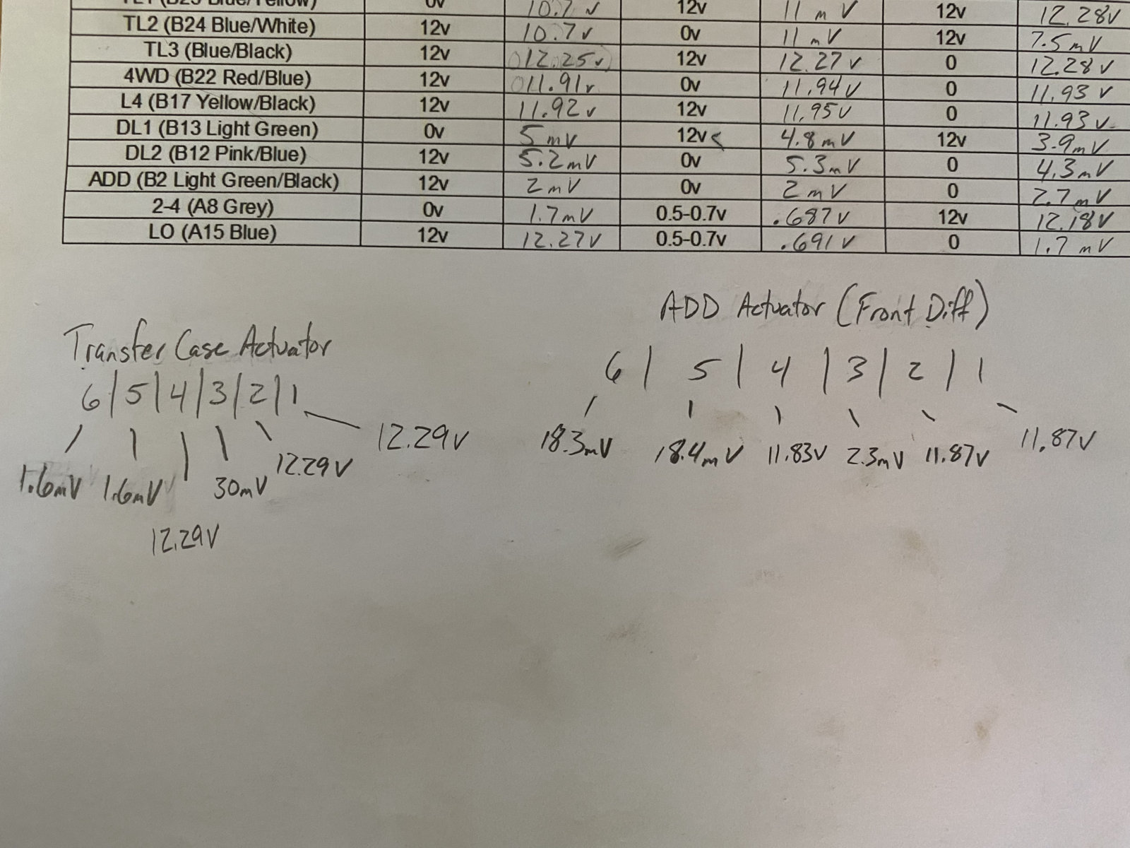

    Here is what I came up with for the voltages on the transfer case actuator and the ADD actuator circuits. IMG_1083.jpg

    It would have been better to test it at the ECU and not the connector.
    Now we need you to test it at the ECU……..let’s hope the reading are “different”.

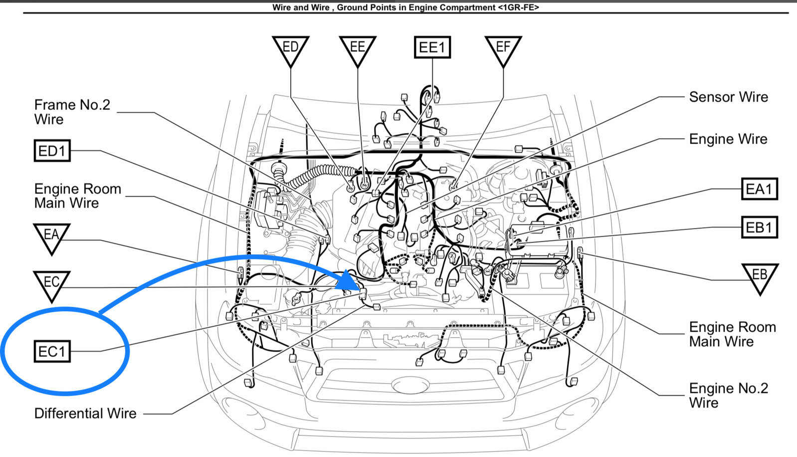

    Unplug the EC1 connector and see if the ADD wire goes to 12v at the ECU.
    It will be a 6 wire connector.

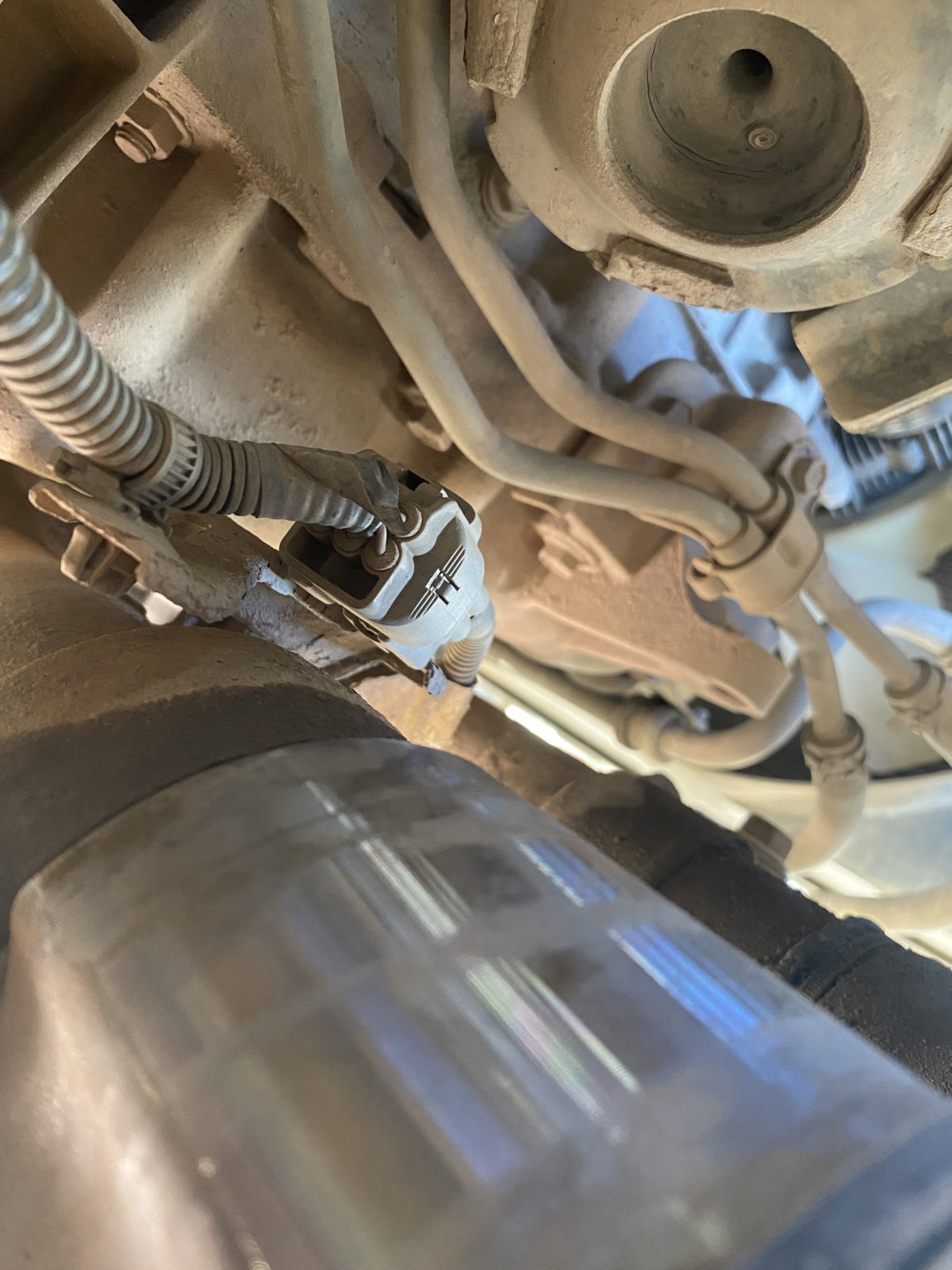

    Metric Rider and TnShooter like this.
  9. Oct 21, 2023 at 4:24 PM
    #29
    TnShooter
    TnShooter The TacomaWorld Stray
    Sep 2, 2010
    #42625
    21,109
    Deogee
    07' TRD Off-Road, Auto
    STOCK
    That looks like it:thumbsup:

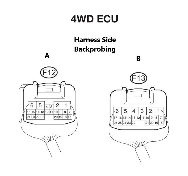

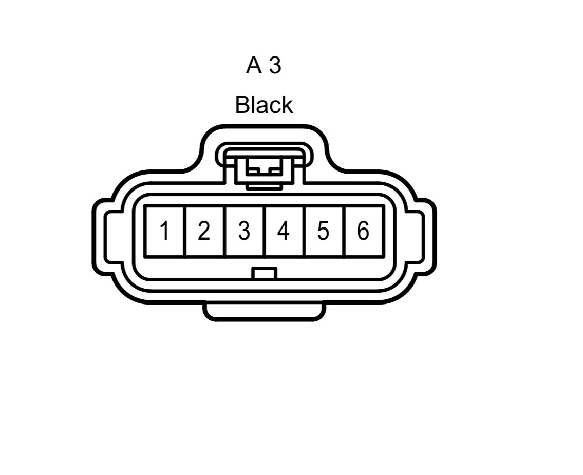

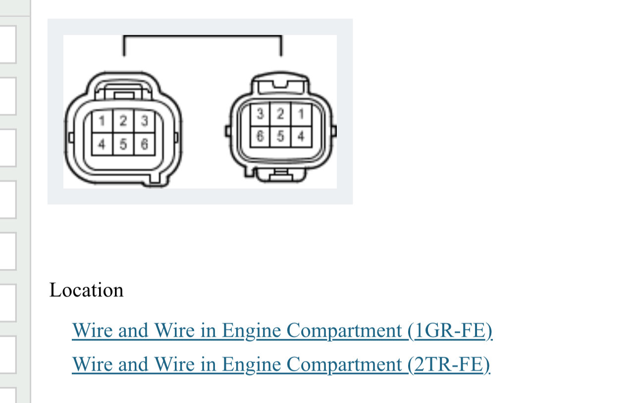

    OP we figured out what might have happened.
    If you followed the pinout in the link. The pinout was for the actuator itself.
    Where as you were testing the harness side.
    Here is the harness side pinout. You don’t need to check it again.
    As we know all we need to know from the first test.
    Metric Rider and Dm93 like this.
  17. Oct 21, 2023 at 10:17 PM
    #37
    TnShooter
    Sep 2, 2010
    #42625
    21,109
    Deogee
    STOCK
    OP, forget all about the EC1 plug. No need to unplug it.
    Your readings were right. (But backward).
    At this point, we need to know exactly what pins on the 4WD ECU you are test.
    Below are pictures to help for a reference.
    Ignore the wires and colors in the 2nd picture. It’s just there for reference.
    Study the plugs and pin outs.
    F12 is TOP plug
    F13 is BOTTOM plug

  18. Oct 22, 2023 at 9:35 AM
    #38
    fifteentango
    fifteentango [OP] Well-Known Member
    Oct 12, 2023
    #435344
    51
    Brandon
    Leadville, Colorado
    2007 TRD Off-Road
    3" Old Man Emu suspension lift, 3" body lift, 33" tires
    This is the exact diagram I've been using. Let me get myself together and I'll go retest everything just to make sure.

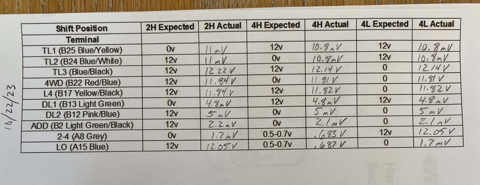

    Ok guys, here are the new readouts. Not a whole lot changed. I started my truck to run it for a few minutes to charge my battery up before taking measurements. IMG_1087.jpg
