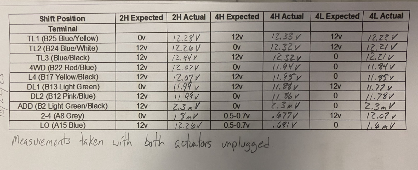

    I unplugged both actuators and took measurements: Unplugged measurements.jpg
    Metric Rider and Dm93 like this.

    Double check Pin 3 (Light Green/Black) at the ADD actuator and see what it is there.

    I disconnected and double checked and it's still 2.3mV
    Metric Rider likes this.

    Ok so we have nothing on that wire at the ADD Actuator end or the 4wd ECU end?

    fifteentango

    No I just asked to verify you have the same reading at the ADD connector Pin 3 (Light Green/Black)

    ok give me a sec and I’ll go look at that. Looking at the connector, is it left to right 654321 or 123456?

    Facing the connector on the vehicle side it should be 123456 but verify your wire color (Light Green/Black).
