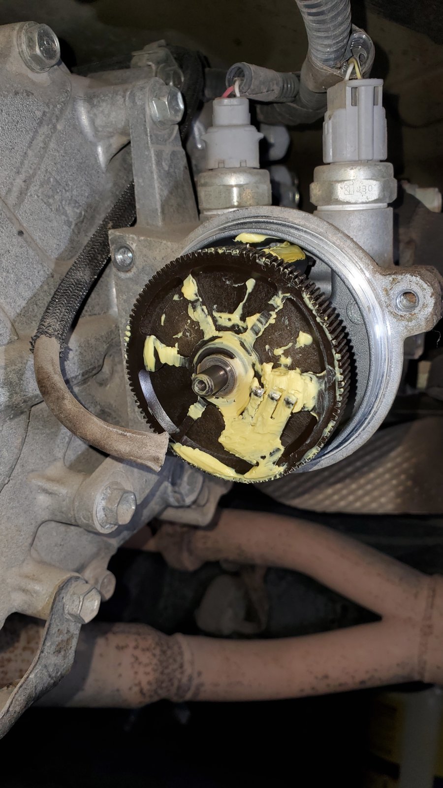

    Did you take the cover off and see where the contacts are actually at?
    Idk about that lol but I'm trying.

    Yep. I’ve got the prongs at the 3 o’clock position when it’s installed. The prongs kinda line up with the bolt hole.

    Where was it when you first pulled it off?

    Almost at the opposite side close to I’d say 10 o’clock.

    So it was off then, it should be pretty much lined up with the bolt at the connector side of the actuator in 2wd. About between 2 and 3 oclock as the actuator sits on the truck.

    Ok curiosity got the better of me, as it sits on the truck with the actuator removed in 2wd here's where it should be.
    It's actually slightly spring loaded so when you take the actuator off that's where it ends up.

    I’m gonna try to go replicate that.

    It didn’t work. I put it in the exact same position with the rod all the way forward. Nothing.
